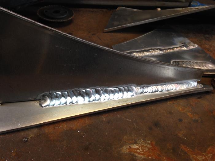

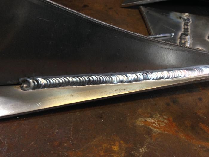

3/16" butt.
- IMG_9717.JPG (56.99 KiB) Viewed 1662 times
- IMG_9718.JPG (61.5 KiB) Viewed 1662 times
- IMG_9719.JPG (38.13 KiB) Viewed 1662 times
Somewhere around 150-200amps.
1/8" E3 tungsten.
1/8" 4043 rod.
#5 cup, gas lens.. bout 20cfh.
1/8" E3 tungsten.
1/8" 4043 rod.

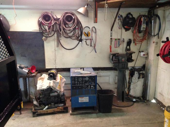

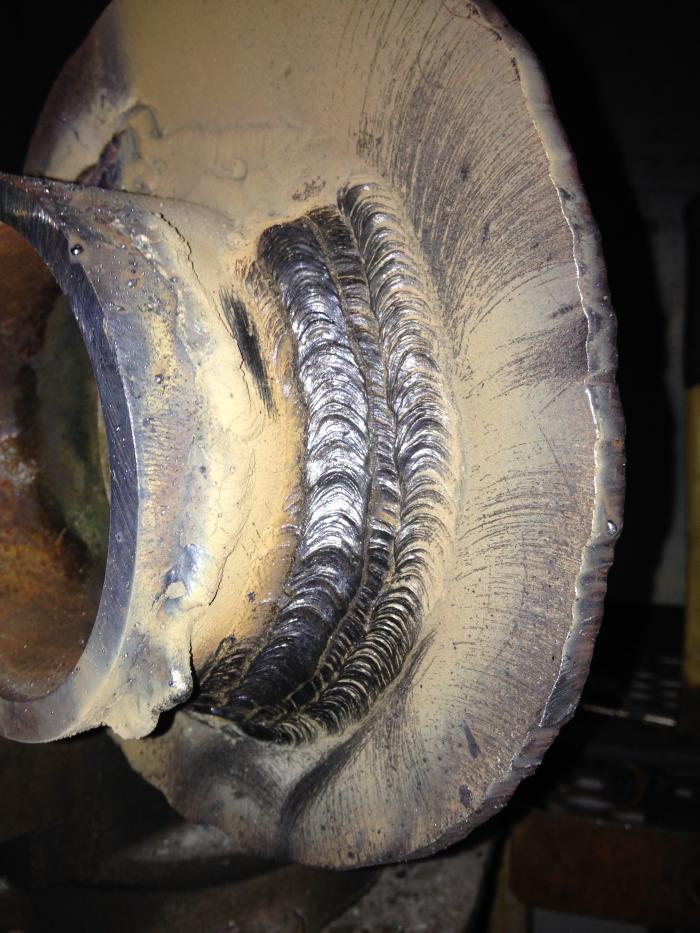

Good score. Same machine I have been using daily for the last 15 years. I can attest for their longevity, running pretty much at 250A AC for the majority of that time. They do a sweet job on your common SS as well.

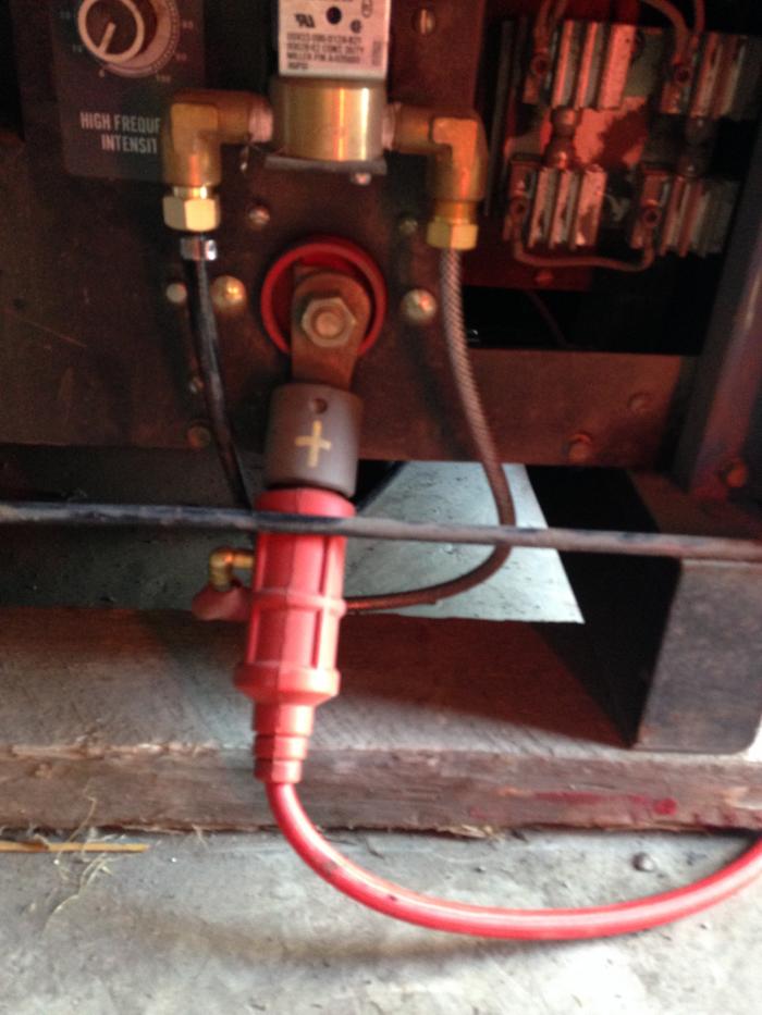

Got a few questions for you, Jeff.TamJeff wrote:Good score. Same machine I have been using daily for the last 15 years. I can attest for their longevity, running pretty much at 250A AC for the majority of that time. They do a sweet job on your common SS as well.
What breaker you run this machine on, and what gauge of wire?
Where do you set that HF adjustment knob, the one that's under the door?
Other then that, I'm really pleased with the machine....
I have it on it's own 100 amp service, IIRC. I can check. It's 4/0 or 600V wire to the service. Just go by the code for max amp draw, distance from the service etc.
On aluminum I am running an 1/8" pure tungsten with a #7 cup with a stubby cap. HF is set to about 60 but I am punching thru anodized and other dirty metal. I rarely venture below 175A AC welding your run of the mill aluminum fab. 200A is really the minimum with 1/8 tungsten. I can weld lower than that with it but I really have to pay attention. I'm just too lazy to change out my kit for all the different material thicknesses and just compensate other ways.

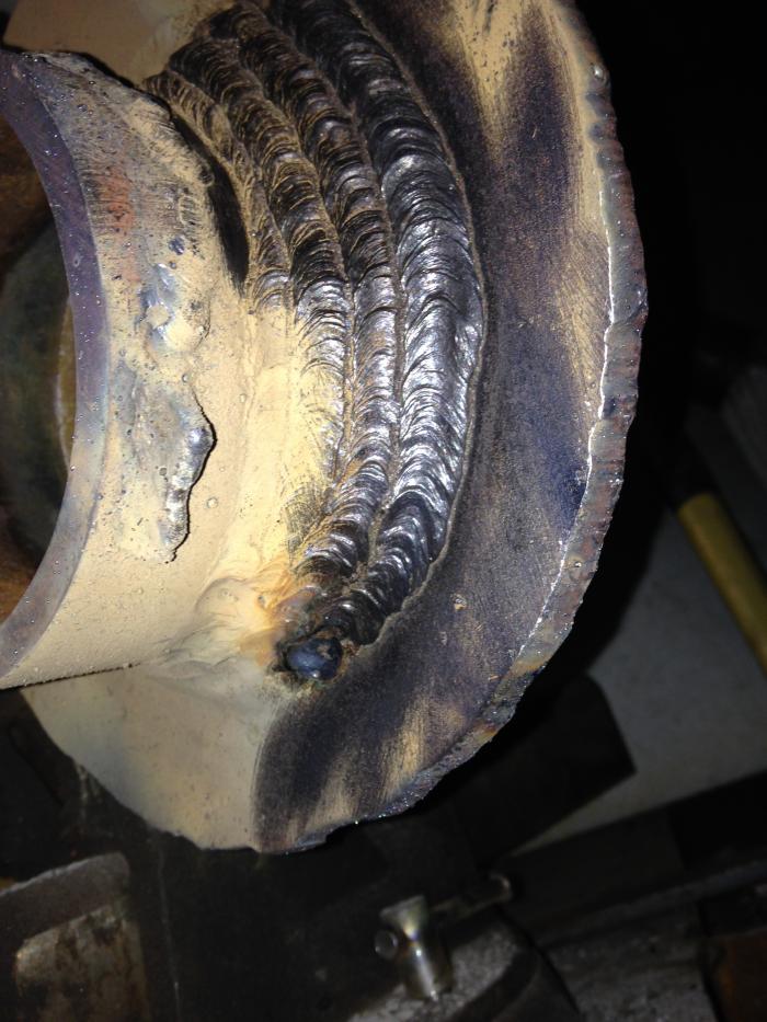

Someone borrowed the use of my machine over the weekend and left the foot pedal hooked up. I was curious to see what I could do with it on anodized. The machine is set at 250 and I just used the wa-wa technique with reverse travel. I haven't used the pedal regularly for many years. Kind of looks like a stick bead. Got a couple of surface pits going up and over the smaller pipe because the cup was in the way and I took my eye off while I was repositioning on the fly.
It was a little awkward, but I know I could nail it with a bit of practice. Not bad for a first try with an odd technique.
Check your HF points. Mine were roasted when I started to use this machine. I ended up chucking them up in the drill press on some wet/dry sandpaper and cleaned them up and reset the gaps and I got better starts out of it.
