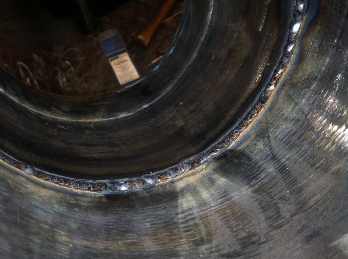

Last week i could not grasp the concept of how to steady and place the filler wire. After a couple of days I think i have managed to finally learn how the method works. It is very difficult for me to do, Plus, I have only been able to do this freehand so far... I will try now to walk the root, and see which way is most suitable for me to get better at( freehand or walking cup). You guys will probably be able to find all my restarts, lol
This seamed 6" carbon pipe is literally shit in a barrell, To the right hand side of the top view pic there was over a 1/4" gap in the root. I cannot line the seams up properly because of how badly out of round the pipe is, So i get mismatch.
I wouldnt waste my time to prep it- But I know that i could get a better fit up by cutting it in half with a bandsaw and grinding a bevel myself.
One last note; To the rear you can see my 1/8" root gap. Lay wire. Very much a breeze rather than what I am currently trying to learn.

Our school has been getting some bad pipe in the last 3 months.79jasper wrote:Not bad though.
If you line up the seams, the rest should match, if you cut your pieces from the same section of pipe.
Pipe is cut according to what you say. But when fixed on positioner it will not stay concentric for a true bevel cut.
No matter how times we line it up it will still cut with waves.
The join at the seam is very warped coming from the factory

Nice, you are making it look easier than it is to pick up.
misaligned pipe is a nightmare, but it improves you more
