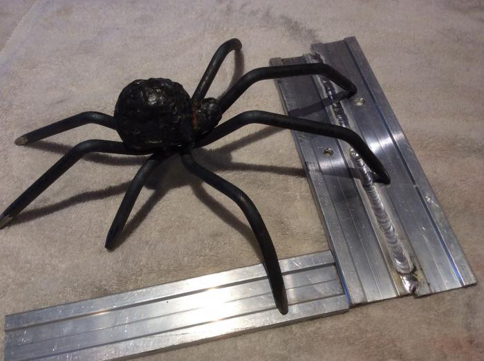

How about a spider third hand tool? I got a lot of Tig welding practice in...Still have to put some Aluminum Bronze on the ends of the legs for conductivity...
- image.jpg (52.8 KiB) Viewed 3563 times
- image.jpg (52.9 KiB) Viewed 3563 times
- image.jpg (46.6 KiB) Viewed 3563 times

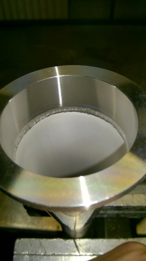

Just a quick weld i made for sanitary piping today. Nothing special. Notice how well polished surface show traces of oxygen. Those little blue areas tell that oxygen content in root was around from couple of ppm to maximum 10 ppm or so.
- WP_20141127_07_42_25_Pro.jpg (37.4 KiB) Viewed 3558 times
