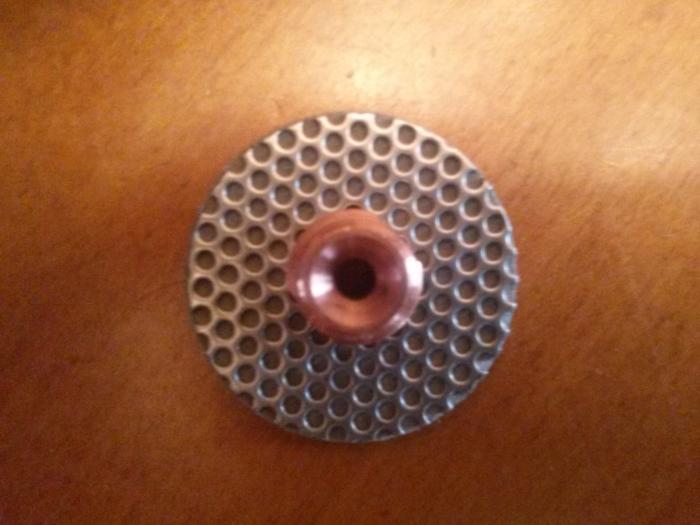

That does not work for a standard 9/20 series gas lens, therefore it does not work with the stubby 17/26 that the OP originally inquired about. That cup and anything else from that 53NXX series works for large gas lenses that are 1" in diameter (the standard gas lens for 9/20 and stubby-17 series is roughly 1/2" in diameter). Luckily those cups work with the large gas lenses from both 9/20 and 17/26 series. I own and use them.
Same cup featured here, which is where I obtained mine.
http://www.weldingcity.com/tig-torch-pa ... ozzle.html
The 53N88, which is the #10 version, is identical in that it screws onto the 1"-16TPI threads of a large diameter gas lens collet body that is 1" diam.
Also, you can't "protect" the screen. If you run into gunky metal that spatters when you weld over it for whatever reason, if it gunks up the screen, you can either try to meticulously replace the screens, or simply throw out the whole gas lens collet body, as the entire thing is meant to be a consumable over the long-term.

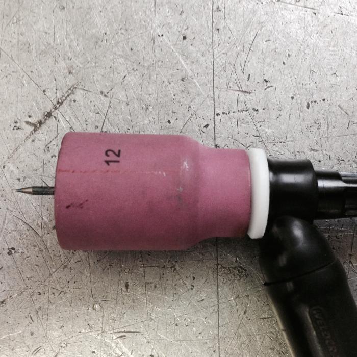

Dogfab sells glass pyrex cups in a variety of sizes from size 5 to about size 15 for the 9/20 size torch. His stuff is excellent, with custom diffusers available for the 12 and 15 sizes. You can see and buy them here: http://www.dogfab.com/FURICK_CUPS.php
Pretty cool! The CK #18 (large pyrex cup) kit isn't too bad either. ;)
ESENTI
    Wed Jan 04, 2012 8:36 am
Mr Moose , can you say a little more about the #12 cup how you do it please since I want to make it myself. For Oscar looks a nice combo machinery I bet it will be very useful .

Actually one of the biggest reasons for using alumina, lava, Pyrex is . . . it is NON CONDUCTIVE. If you have a conductive cup and cup touches any part of what you are welding on the cup will try and weld itself to the work. The protective band that the one guy uses works cause it is slipped over a non conductive cup. His band never makes actual contact with collet body like an all metal cup will
dirtmidget33
    Tue May 13, 2014 5:22 pm
If you look at I believe it toxicfab with the titanium tube it appears there is an insulator between the thread section and actual metal cup. If there wasn't cup would be useless for welding on frames and tight places. lot cheaper to use the CK large diameter alumina push on cups with gas saver lenses without all the hassle of dealing with the metal cups

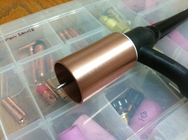

Well, here it is! Practical, probably not. But it sure is cool!! I can't wait to give it a go and see how it works.
    Fri Apr 01, 2011 10:59 pm
    Australia; Victoria
Probably perfect for low amp pretty welds.
    Thu Jan 24, 2013 10:13 pm
    Eddy, TX
Mick,
Yeah, I think it would work well at low amperage especially on a water cooled torch.
Is Tony aware of how much free time you seem to have? :lol: :lol: :lol:
Seriously, even experimenting with the seemingly impractical will help us learn something, and may even surprise us.
dirtmidget33

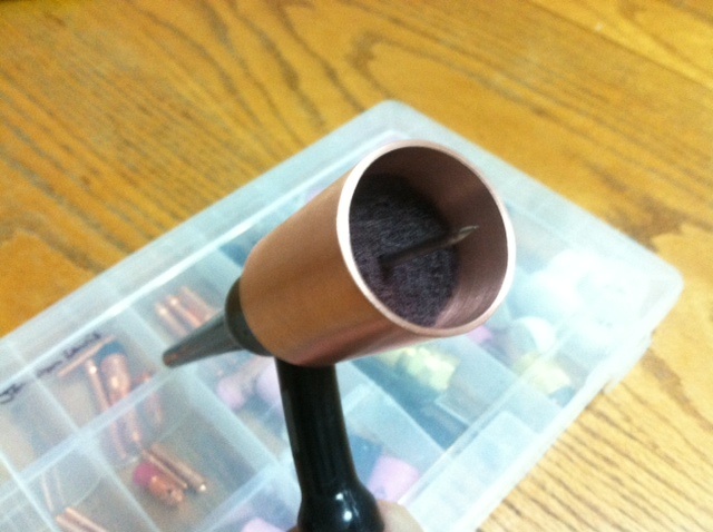

Superiorwelding is the outer copper cup insulated so it doesn't have continuity with tungsten ?
Looks pretty
    Eddy, TX
Steve,
Well, it's a good thing Tony doesn't frequent the TIG section...I think. 8-)
Dirtmidget33,
Here is a pic of the set up with a actual CK jumbo cup. It is insulated but I have not fired it up yet to test that theory.
FYI, the copper is only a 1" coupler found at Lowes and all I did was brush it up a little, but don't tell anybody, shhh ;)

wayyyy to lengthy for my small hands. It would take me too much effort to contort my wrist to keep that cup from dragging on the work. A [much] shorter version would be nice :)
    Eddy, TX
Oscar,
I was originally going to use a 1" copper cap to make is shorter but that would require drilling out the back and the coupler was a few cents cheaper. :lol: Seriously, I decided on this because it is actually the exact length of the Pyrex cup so I knew all the pieces would fit. The gas lens will actually fit inside of the copper pipe as well I just didn't put it in.
    Thu Dec 26, 2013 12:41 am
    Laredo, Tx
Superiorwelding wrote:Oscar,
Exact length of which pyrex cup? Not the CK #18 pyrex cup.
it is way shorter than that BBQ grill, I mean copper pipe you used :D
