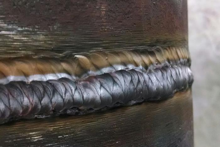

Here's one from some practice...
- IMG_20140409_154416.jpg (42.98 KiB) Viewed 2556 times

@Jonathan,From the look of your Prof Pic, It seems you have nailed it.Superiorwelding wrote:Moose,
I too am working on mastering walking the cup. The most frustrating thing to me is how long it is taking. I normally don't struggle long with things but this is a task. I agree with Rick, work on flat welding first. I started there as well and then said "I got it" and moved on to 2G pipe and need to go back to plate. It is harder than it looks, in my opinion. A few friends and I are posting our results on Instagram as we practice and it helps to have others offering advise. The best thing I can tell you is the same thing they are telling me, more seat time.
Not too long ago, I was at a fab facility where I watched a welder continuing to complete his cap on some fairly large stainless. His timing and repetition was something I have never seen before except possibly on YouTube. Absolutely amazing

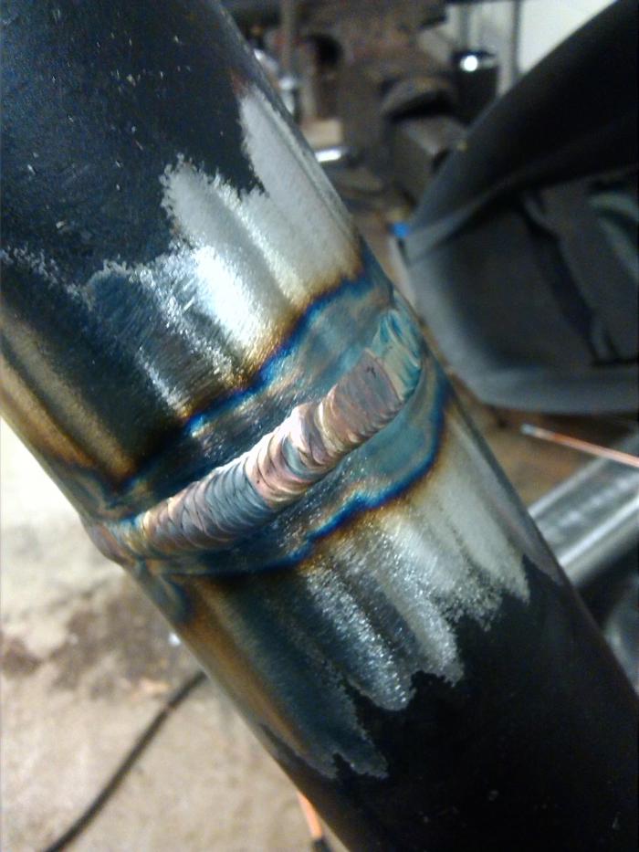

- I tend to get confused when welders generally say "walk the cup", but as Moose has explained that he is not doing a groove weld and rather just building the surface- So I see what he is trying to accomplish.
Hopefully I am not offering bad advice to you.
Depending on how awkward my body positioning was I would generally use 2 variations on the bottom.
1. having the cup pointed towards me. Or, 2. Like you normally would walk in figure 8's.
With that said, I would still rest the Torch handle between thumb and forefinger with some grip; However, I would try to let the roll of the cup make a pivot feeling(counter pressure) between each finger whilst still gripping. You don't want it to slip.
Btw, with that much amperage, I would think your tungsten needs to be sharp to provide the wider arc. 1/8" filler rod would probably help out as well, but you mentioned you don't have it. What size diameter is this pipe? Also, Are you just practicing for now? Or does the apprenticeship not have you join pipe for practice?
