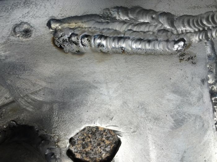

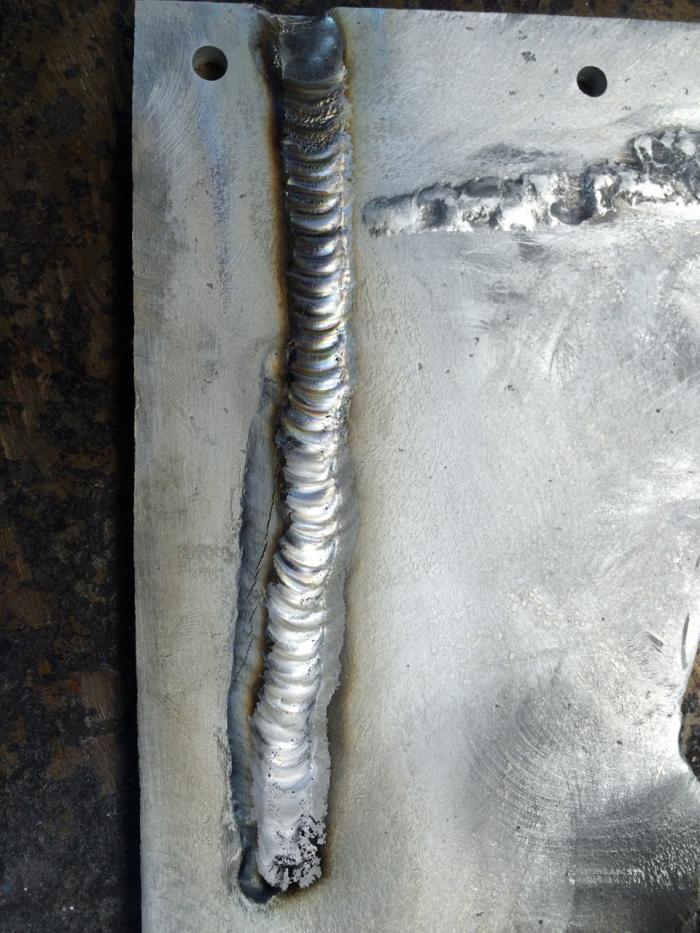

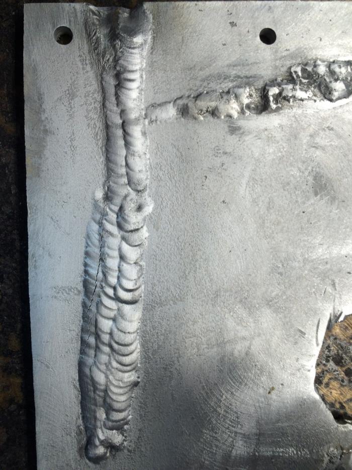

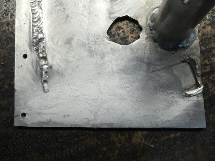

Ok, I had some more time tonight. I sanded the plate down w/2" sandpaper disc, then used acetone. 1st pic just shows plate after that cleaning. Then I started w/185A. 2nd pass down to 175A, then I dropped down to .7 pps, and 65% balance for more cleaning. Results are all better but I still seem to have more contamination. I will go down and get some new plate soon, but I don't have any nice metal shops real close to me; hence my desire to work on a scrap piece.

Goldhawg. It looks like you have the ability to lay down a good bead but I can almost assure you that your base metal is the root of your problem. The one bead has a huge crack almost the whole length of it. I only have about an hour on my 210 but as soon as I lit up on aluminum I could feel the difference from my transformer, it is almost as stable an arc as welding steel, just a whole lot noisier. Get some good clean metal and try again. Im bettin you will notice a big difference. You cannot have it too clean with TIG plus your etching zone is too small. Set it at 75%(proset) and give it a try. Let us know what happens...Don't brush your welds, thats cheating :)

Been watching this thread for awile and the one thing I have not seen done and it has to be done. There is no ifs or butts about it is. . . . . .
SHINY BRIGHT CLEAN METAL
The sheets you are welding on are oxidized and pitted real bad. A light sanding or brushing is not gonna clean that like you need it. Get a 4 1/2 inch grinder with 80 or 120 grit flap disk and get that oxidation and pitting off there. TIG doesn't like dirty material. Clean the whole plate then do the aluminum drill like in Jody's video and pad beads on that whole plate. Make use of that scrap cover it with beads. But Clean Clean Clean that crude off there, basically grind down to good metal. The cleaning action of AC is for removing light oxides not corroded metal.

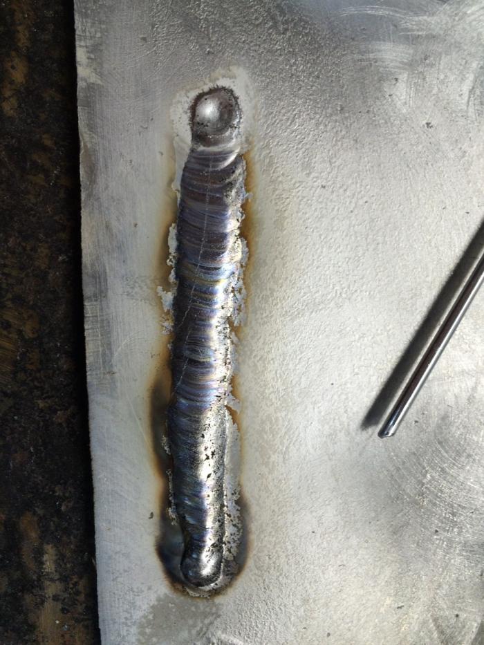

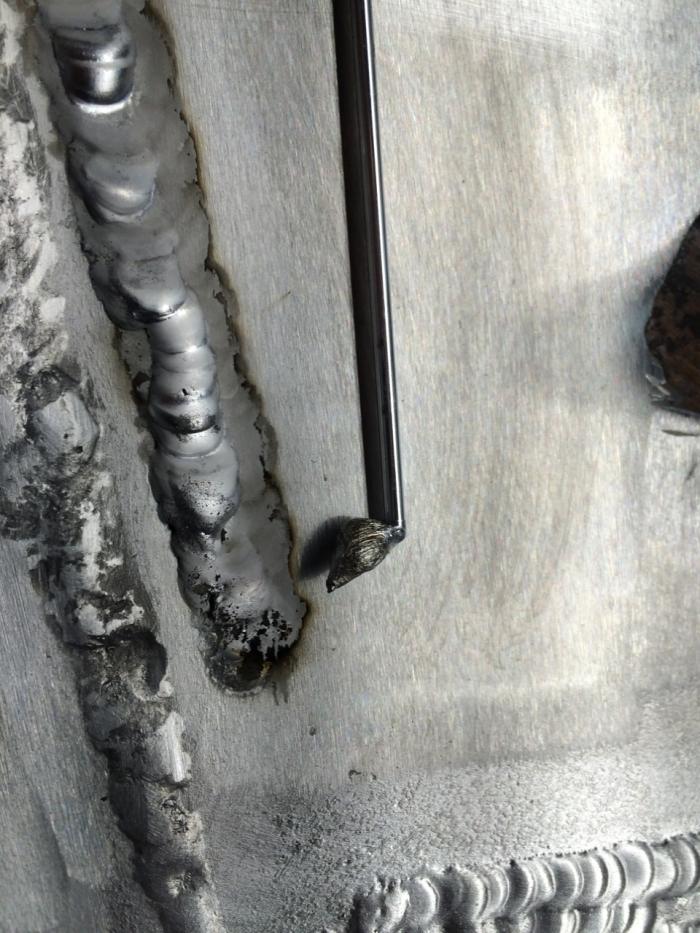

Well, you gurus are right. I took the plate over to my belt sander and ground pretty smooth, and it did a lot better. I'm pretty happy with how the one bead looks on the bottom. However I was also having a problem with the welding rod melting before I could get it into the puddle, and once this process started it is almost impossible to get it off while welding. I'm trying to keep the tip of the rod down near the argon, but it got a bit hot. What is the likely cause in my technique? When this happens, is it best to just stop and restart after cutting the end of the rod or is there a way to melt this off and keep going?

Most common problems
1.Arc Length
2. Torch Angel
Arc length should be 1 to 1.5 times of your diameter of tungsten. Large arc length puts excessive heat in work making uncontrollable puddle. Torch angle wrong blowing arc and heat at you filler. Also filler angle might be coming in to high. Come in at low angle.

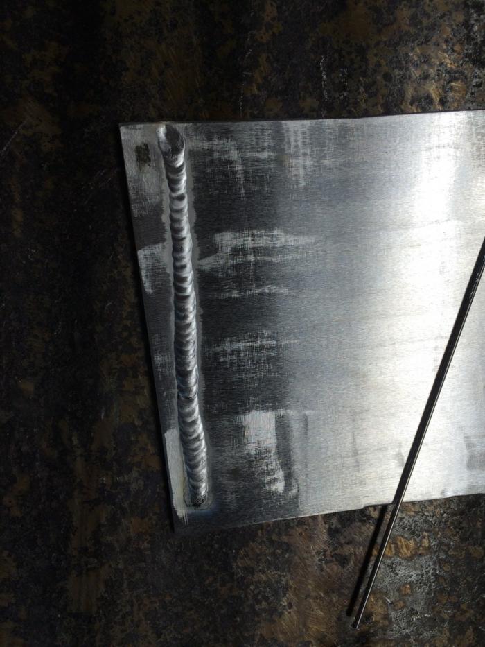

OK, got down to the metal store to buy some new plate out of the scrap pile. Got lots of misc pieces @ $2/lb, including the recommended 1/8" plate. Everything seems to be working great. I'm using 125A, 75% balance and 1 PPS. I really like the pulse feature to give me time to work the rod; I don't feel too rushed and am able to get into a bit of cadence.

That's a GREAT improvement. That clean piece should take a lot of your headaches away when learning. Make sure to pad some beads without pulse too. After you pad a mess of beads, you will find just the foot pedal is all the control you need for heat input
