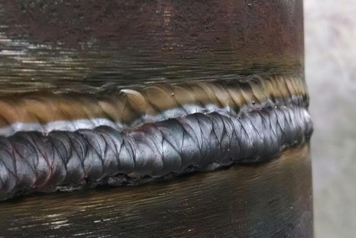

I found an old practice piece in misfits drum, root pass only so the inside probably sucks. When I get a chance later I will cut it up for a pic on the inside. Here is the pic on the outside.
There is always grey scaling on the inside after the complete weld due to all the heat that's gone in, don't let that worry you. A No.26 torch is best for this weld, a 17 gets hot in your hand and can't be doing it any good.

Thanks for the info. Like I said my root is great, nice on the inside and nice color on the outside. Really just looking for info as why my other passes look so dull. And for the torch I like the 17 with the super flex cable, its light weight and fits me good. It does get hot but the only time I feel the heat is the root because I free hand it. The other passes I walk the cup so my had is at the bottom of the handle.

Cameron,
I don't know if it's good, bad or indifferent but mine always turn grey after the root is done also. A lot of heat goes into a schedule 160 weld so it's bound to turn grey from oxidation.

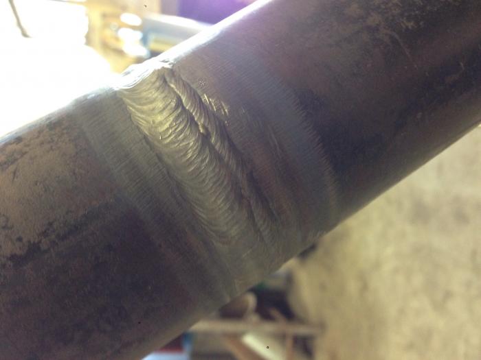

Ya but what about my fillers and cap being grey? seems like they should shine! ill try to post some pictures tomorrow.
All I have is sch 80 pics...
- IMG_20140409_154416.jpg (42.98 KiB) Viewed 1903 times

sorry the pictures are all out of order and sideways. root went in good, tacks were kind of heavy but good enough. hot pass and fill did ok and the cap needs to be tightened up. all these pictures were from the left side, that's my hard side. so the other side of the pipe not pictured looks a tad bit better.

That root is sweet!
How you guys get that much reinforcement to root? Especially at 6 o'clock.
About those cap passes. Isn't root weld usually little smaller than rest of the passes.... Less heat brought. You already mention about cooling between passes. But think it this way
When you start welding your pipe is only 20 ºC or so. Root pass done and carbon steel have now sucked really much heat energy and conducted it to large area. Then you let it cool down to touch. Let's say that pipe is 40 or 50 ºC as you start your hot pass or cap, if you will. Now you already have 20 ºC difference compared to root pass. You put the same heat to the to pipe as in root for example, but total heat is difference and it can easily affect to color of the weld. In other words weld cooling time is longer and it reacts with air in higher temperatures.
Does it matter at all in this case? No, as already stated here. That color is just oxides and impurities reacting with oxygen in higher temperature. Specially I wouldn't worry as long as it can be brushed clean with ease.
