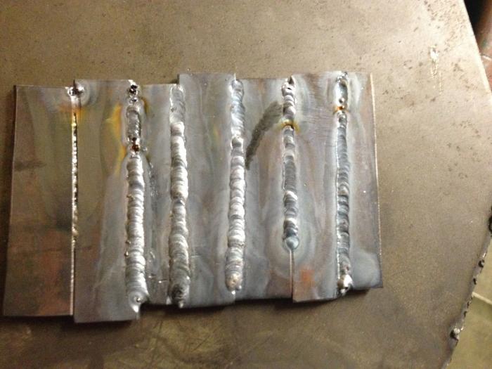

I am new to tig welding took some classes at the local college just looking for some tips on how I can improve looking for constructive criticism thank you
This is 1/8th inch plate 3/32 tungsten and 1/16 filler all mild steel

It makes no sense to critique your welds as you said you were new to tig but my advice..coming from someone that got back into tig after 15 years would be... there are many things to know about tig welding but to do work as good as Jody and some of the other pros around here is getting into a good position and dry running a weld to see if you are going to be able to do the weld and stay steady. Watch Jody when he dry runs. I started paying more attention to my positioning and my welds instantly got better. Tig just takes time to master but you will if you learn the right way...you dont have to unlearn bad habits. Tig is just plain cool and there is a wealth of info and advice from some pretty awesome weldors around here...dont be afraid to ask questions..no one will flame you. Good luck and have fun!

Thank you for your input Iam gonna keep practicing and posting pictures of my progress on this thread and keep asking for more tips. I have watched all of jodys videos and Iam really trying to focus on not having to long of an arc and not too much torch angle. I guess I just need to sit down and practice practice practice

Thats EXACTLY what it takes to be good at tig. I bet everybody who starts tigging trys to go too fast because everybody wants tolay down those cool stacks of dimes. I know I did. Then I realized that there was no hurry to get good and no one was watching me so I watched Jodies videos over and over and now I spark up with confidence. You'll get there too but don't learn bad habits and the learning curve won't be so steep. Best of luck and keep us posted 8-)

Arc length becomes second nature with practice. For me being consistent with arc length was mostly about not getting burned. I use Ove Gloves, TIG Finger sometimes, and I have copper bars 1.5" square I run parallel to the weld bead to lay my hand on. To some extent this protects my hand from heat. Without that distraction, I am much more steady. Two years ago I would grind ten tungstens, then a half hour later, do it again. I haven't ground tungstens in months.

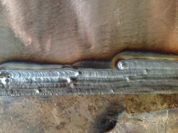

Back with a little more practice last night. Gonna try to keep practicing each night for at least an hour or two

Why is one piece of steel clean and the other not?

Oscar wrote:Why is one piece of steel clean and the other not?
It's my welding table that's not as clean as the work piece it's they way I took the picture that makes it look like one piece

Oooohh ok, I betcha. Optical illusion, well for me anyways. :)
