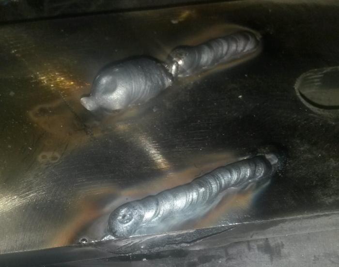

Went in to the shop at work today, since that's where I took my new AHP AlphaTIG 200x. I don't have a shop at the house and I have no desire to have all my argon blown into the pasture. Got the machine set up and looked around for some scrap. Nothing in the scrap bin but lathe swarf. Figured I'd go to the local metal house for some 11 ga drop but it was 1155 and they close at noon on Saturday. Ended up sanding (flap disk) the powder coat off a piece of 1/4" we'd salvaged from an old chair that was headed for the dumpster. Sharpened a tungsten and tried to run my first TIG bead.
For those of you who've never done this before, it ain't as easy as Jody makes it look.
I found that I have a real talent for dipping the tungsten...and I rapidly gained experience in sharpening said tungstens. I was wondering why the damned arc was so wimpy until I remembered that I needed to depress the foot pedal further than just what is required to start the arc. Interspersed with electrode dips and hitting the electrode with the filler rod, I finally managed to run some semblance of a bead.
The rear right bead is my first actual bead. The fat thing on the left is some kind of anomaly I can't explain, but I did it. Guess I was moving too slow. To paraphrase our esteemed leader, that bead is too bad to even qualify as Fido's butt. The bead in front is my last one. I think it may have been a little cold because of the fact it's heaped up like that. May have been too much filler metal too. I'm not sure.
I left after that because the HVAC in the shop was dumping 85° air into the room. I'd called control and asked for cool air and didn't get it. Also, I'm just coming off of major hand surgery and was having trouble holding the torch comfortably after a few minutes. Gotta keep at it. Welding and shooting will be part of my rehab.
Parameters for those who are interested:
150 amps set on the machine-controlled by foot pedal
15 CFH Ar
ER70-S2 filler rod
1.5% lanthanated tungsten (LWS was out of 2%)
All tips on how to make it better will be appreciated.

are you sure those are pictures of your weld beads?

Yeah, they're really mine. :( You really did throw yours away.

IDB, you made a great start, just remember every inch gets easier, and Jody must've welded a million miles or more.
Keep up the effort - great work for a very first try.

Thats not too bad. Alot of new guys cant even get a puddle started so I think you did good. Heres a timesaver...go ahead and sharpen a whole pack of tungsten...on both ends..because your gonna have to sharpen them anyway when starting out. It saves lots of trips to the grinder. Everone was where you are right now but in a few months you will be showing off some nice welds 8-)

Not a bad first attempt, yes they are a little cold. Looks like you did a decent job getting the coating off that could be given you issues also.
What settings were you using? I always tell guys start off with no filler, get use to holding the torch, torch angle and control, then move up to slowly adding filler and work on a pad of beads. Usually also recommend scratch or lift arc and then add the pedal in later, that way you can concentrate and not worry about everything yet.
If your using 3/32" tung, try 85 amps, #7 cup, 20cfh

the orangeish/brownish smut near the bead indicates a possiblity of issues:
  • too small of a cup size
  • too much flow for the cup size
  • too much torch angle
  • dipping the tungsten into the molten puddle and not re-dressing it
The tall bead height (in general) could be indicative of:
  • feeding the rod to the arc and not the leading edge of the puddle
  • not establishing the proper size puddle in the first place
  • too much filler rod addition
  • too large of a filler rod
  • --the most probably cause----not enough amperage, running cold (0.250" thick steel needs a lot of amps to get a proper puddle established quickly and with decent penetration)
1st and easiest fix for the tall bead height---don't worry about adding filler. Establish a puddle roughly 3/16" in diameter within about 4 seconds of striking the arc. Move it about 1/8" at a time, while trying to keep a consistent arc length of ~1/8" from the workpiece. Keep the foot-pedal at the same position. As you scoot on down the workpiece, if your arc-length changes, the puddle size will change as well. Too long, and the puddle size will grow and you will oversaturate the part with heat. Too short and the puddle size will shrink too small, and you may dip the tungsten. The finished bead is like a freeze-frame of the past. It shows what you just did, without having to rewind the VCR and look frame-by-frame.

Simplify to conquer. Resist the urge to weld lol. One step at a time. IMO laying a bead is a few steps ahead of the curve.
First (no filler) prop and set torch angle like the books say. Next, see the puddle. Next see the difference between arc and tungsten. Move over, reset and repeat until the brain puts those things together without additional movement because it stays the same. This may take longer than you think.
Second, bring a filler rod into the picture just to gauge arc length (hopefully the first exercise taught you to focus on arc length not tungsten). After you have got the arc length down (or up was my biggest issue) after repeated static starts, start moving with the filler in the picture but never entering the puddle. Focus on torch angle (since arc length and filler rod are in the picture) and being loosey goosey because a longer tig bead is more about upper body movement than hands.
IMO do this exercise until you can put everything together for a foot in length before adding filler. It takes time but most welders run a dry run physically or in their mind at every joint.
Third, put the filler in the puddle. Put the filler in the puddle. Put the filler in the puddle. Put the filler in the puddle. Put the filler in the puddle. If you got that far without dipping you know you are moving and maybe naturally gifted. If not, clean up and start again and realize you need to move different (speed) or dip different.
This is a longer learning curve because of the variables of material and amperage and putting that together but when you get to 5 dips without touchdown stop and analyze the freeze frames. Adjust speed or pedal as needed. When your purdy with 5 dips count to ten dips, then 15, then 20,,,. Stop at each interval, analyze the freeze frames, adjust until purdy then move on. The counting helps develop a "beat" that is all your own. It's sometimes helpful to go back to step two and practise if your having a hard time with purdy.
IMO work with 12" or longer coupons right from the beginning. Short coupons can get you into bad habits IMO. Straitening out your beads helps a lot with positioning for later.
Fourth, before you leave flat, learn to write your name (hard for right handers). Start with big circles without moving the work piece. Left hand helps a lot on this exercise and more so in real world and work down to smaller circles in a spiral.
Doing circles and eventually writing teaches you your physical limitations with tig. This will help with real world projects by showing you where to stop and start your welding to keep a clear picture of the puddle and filler.
Okay, that's not how I started either lol but that's the way I learned to tig weld.
Thanks for all the encouragement and tips, guys. I certainly appreciate it. Might take a bit of time for me to get halfway decent at this, between my hand healing up completely and trying to find time to spend in the shop when I'm supposed to be ramrodding the planetarium remodel instead.
