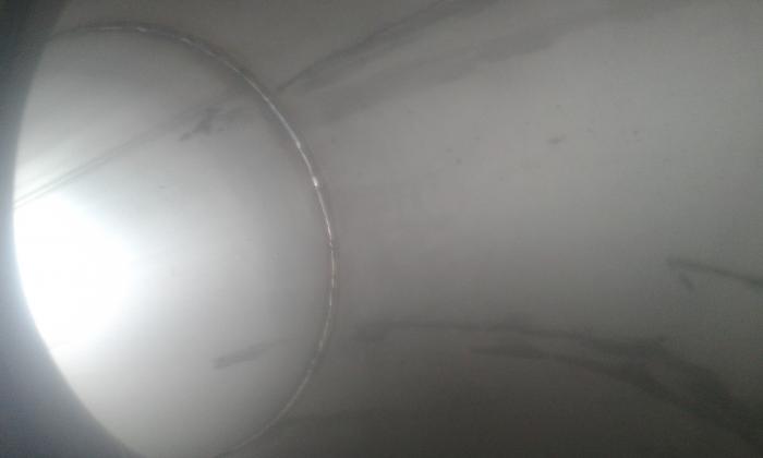

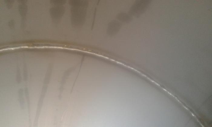

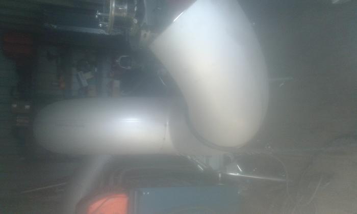

I get two very shit photos my cameralins is so worse. I was told to do 3mm thick at one pass no gap.. there will be only 3mm no 4mm thick pipes.. I made some bewel and weld couople of them about 80A And realy REALY slow And let that pudle vaporize good, and i got it trough good like 80% of that pipe.but rest needet weld inside.. And that technique was hard to whach when its getting that fusion..Blaah lets see i try chainsing paramets tomorrow..

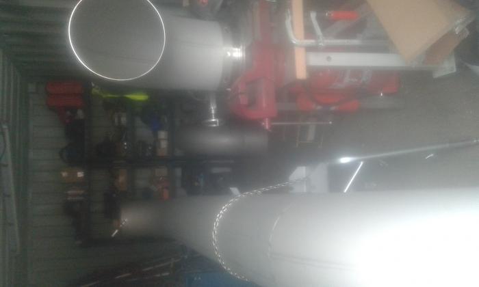

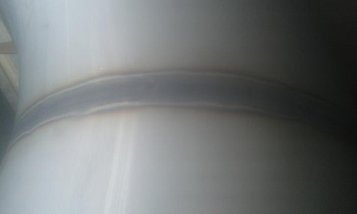

Hi so i found the technique to do it whit out gap/bewel only mismatch what comes cutting whit them on a grinder and litle smoothening thoos pipe edges on flabdisc. This ones what can be weld that bench i weld them on 10-12.clok and it worked on me 75-80Amps and dipping wire every time when that budle vaporizes and only slight movment up and back, and repeating that and moving only when that budle was very fluidy it pushed in that root at one pass..

Agreed, looks pretty good....
Thanks Thanks,they dont only look good they are good
Nope no xrays yet drawings said that xrays must be taken on (is it called) out of position welds... But who the he..l knows what weld is made on where if i say so..(nothing aqainst NDT long as they dont bust my ass) just dont like them and thats it
Again im learnd something new it tooked one two inch weld at one older pipe welder and i got hang of it. I ask him to show me one of the pipe how he does it and that was all i needet to fiqure it out.. So be nice to older more experienced welders eaven if they are litle crummy saved me at this time.. If i can i get better camera and shoot couple pictures at the end of this project..
