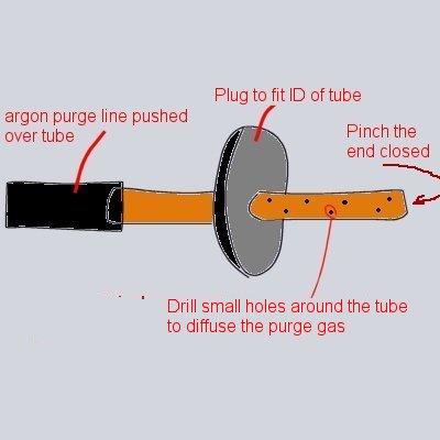

Otto's method is a good one and it does work. You have to be sure that you have positive pressure in the tube (or whatever you're purging). You can check this by wetting your finger and checking the exhaust hole(s). You should feel the gas (argon) escaping, if not then you may not have the tube properly taped/plugged off, or enough flow into the tube.
Also the purge line should have some sort of diffuser on it, this allows the argon purge to enter the tube, be dispersed in a way that causes the least disturbance of gas flow. The diffuser can be something as simple as a copper tube as shown in my attachment.
- Image1.jpg (20.2 KiB) Viewed 1967 times

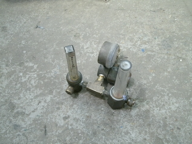

Y-connection for the gas is a bad idea. I have two separate regulators and flow meters on the same gas tank. Works like a charm. I can set any SEPARATE gas flow for SEPARATE outlets. None affect another.
Thanks for the back-up!Cricket wrote:+1 to Oscar.
I use a single regulator, but tee to two flow meters. Built one for each TIG machine at work, on the cheap. We replace flow meters on these trailers so often, we have a box of spares, so it's as cheap as one brass FNPT tee and one close nipple.Cricket wrote:+1 to Oscar.
- GEDC0359.JPG (199.05 KiB) Viewed 1864 times
Interesting. My flow meters have regulators in their base, I bet yours do too. They supposedly drop the input pressure to 50psi and you control the air flow from there with the manual valve. So you might have two regulators...Otto Nobedder wrote: I use a single regulator, but tee to two flow meters.
I have some of those flow-meters with the built-in regulator. They do not work for this application. These were built from two-stage types, with the regulator separate from the flow-meter. Each leg off the tee (in the picture) uses the original pipe nipple from the regulator/flow-meter set, because it has a built-in restricting orifice to set a maximum flow (which is above the top reading of the ball, by the way).Cricket wrote:Interesting. My flow meters have regulators in their base, I bet yours do too. They supposedly drop the input pressure to 50psi and you control the air flow from there with the manual valve. So you might have two regulators...Otto Nobedder wrote: I use a single regulator, but tee to two flow meters.
