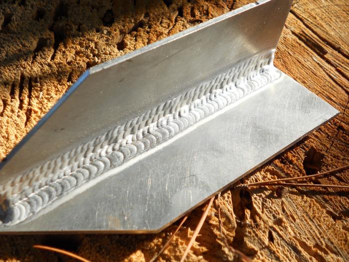

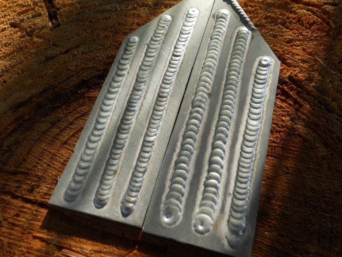

New guy looking for thoughts/suggestions on what's going on here. So I've done the stacking drill to the point of finally being somewhat satisfied with bead appearance and puddle definition. Not as perfect and consistent as I'd like, but I know this will only come with everyday seat time, which unfortunately will not happen right now.
First 2 pics are just practice, all .090" 5052 sheet. Miller 350 LX Synchro at 90-95 amps, 3/32" 2% LAN tapered with maybe .03 to .04 balled end, 1/16" 5356 filler, balance right around 10 (68% EN), and straight Argon set at 15 to 20 CFH. Prep on the sheet was SS brush on 1 pc only, other left alone for comparative purposes (no real difference was noticed).

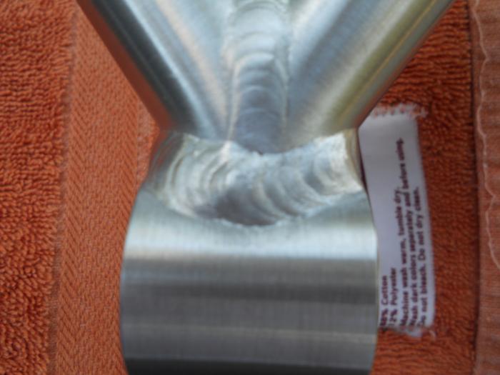

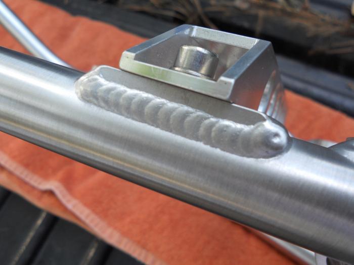

Finally get my confidence up to lay the $$ beads and I get this gritty look that almost looks like it was too hot (pic 3). This joint is 7/8" OD 6061 x .062 wall tube, fitting there is basically a 6061 machined channel piece, 1.5 OAL x .75 wide x .25 legs, with legs being .100 thick. Used either 100 or 110 amps on this joint, all other settings/rod being same as above. Went so far as to carve 1 or 2 of these welds out to re-do them, only to get the same results.
More of my misery (same 7/8" 6061 tube):
Penetration wise I'd trust my life on it, it's just the appearance makes me want to throw it in the scrap pile and put my machine out to the curb with Thursday's trash. Open to any suggestions or criticisms to help me out with asthetics. Thanks guys!

Frankly I think you are being a little tough on yourself. These results are not as bad as you suggest.
I would try reducing the current by about 5-10 Amps, maybe a touch more, and see what the difference is.

If the piece s not going to be anodized I would try 4043 at the same settings and see how that does.
i don't know if this has any bearing on it but in your
practice welds there is a nice line of cleaning that
is not noticeable on the tubing. did you brush the
tubing welds? just curious....
You are probably more comfortable moving fast on the practice pieces. It's more of a challenge to move fast on the pieces that require a constant change in torch angle. You'll get there. Your straight beads look killer. Now you just need to translate that speed and heat to more complex shapes. The only tweak I would make would be to fill those craters. You are on the right path!

Will be trying this out as soon as I can pick some up. I've always leaned towards 5356 for the ductility factor, as these things are prone to crash damage.Braehill wrote:If the piece s not going to be anodized I would try 4043 at the same settings and see how that does.
Good catch. Yes those were cleaned up a bit, while the others were not. I long for the day when my stuff looks good enough to not require brushing or scothbrite.motox wrote:i don't know if this has any bearing on it but in your

You are absolutely right, my comfort factor trying to wrap small tube joints is pretty much non-existent...and lack of real estate for propping the torch hand doesn't help either. And I'm sure my grip on the torch is much too tight and rigid, that added with the narrow field of view associated with tig (at least for me) I'm sure is slowing my travel speed down. This doesn't explain the gritty finish in pic 3 though, since I distinctly remember traveling as fast if not faster than the practice runs. Goal was to keep the heat soak down, retaining as much temper as I could being that those pieces are tapped. Now a question for you, being the tube joint master, is there any way of compensating for slower speeds? As others have stated, I'm ready to try less heat and even larger filler. My thought is maybe larger filler might have more of a cooling effect, IDK. Awesome work by the way Zank! Your look is very much like what I'm after.zank wrote:You are probably more comfortable moving fast on the practice pieces. It's more of a challenge to move fast on the pieces that require a constant change in torch angle. You'll get there. Your straight beads look killer. Now you just need to translate that speed and heat to more complex shapes. The only tweak I would make would be to fill those craters. You are on the right path!
