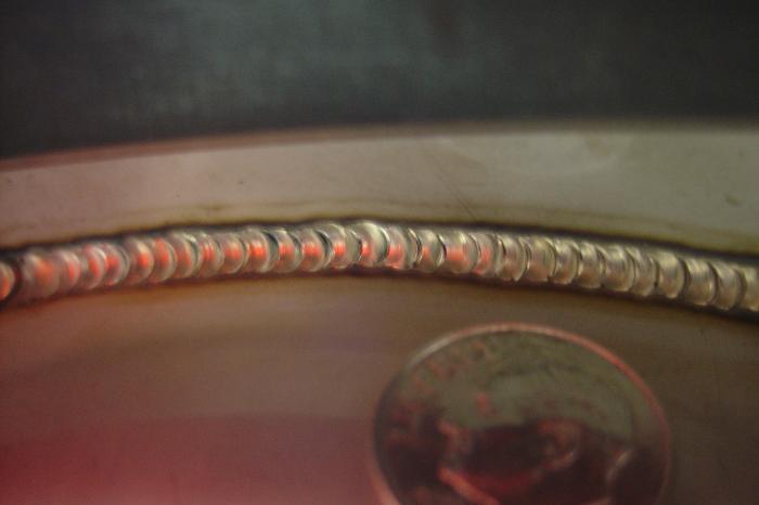

This is from a 304 SS liner that I had to build for a coating machine. This weld was around 1/8 inch wide and 18 feet long. The cover has to be replaced about every 3 months, so I've made quite a few of these.

big gear head wrote: This weld was around 1/8 inch wide and 18 feet long.
:shock:...nothing like a little seat time.

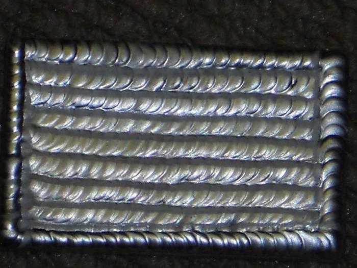

Repaired a swingarm off a Suzuki RM 500...oldschool, '83-'84'ish.
...then padded some beads since it was fired up.

Looks good...only 18' huh.
Swing arm looks good, I have found the alum in those swing arms to be pretty good quality.

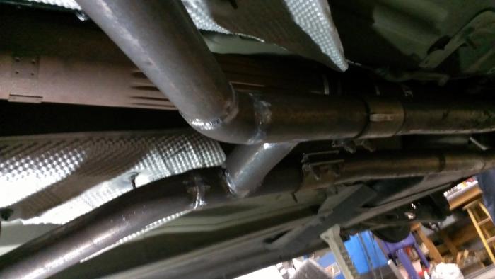

409 SS H pipe for my son's Mustang. I converted it from single exhaust to dual exhaust using pipes from a GT and cutting up the old single pipe for the bends to make the H pipe. The picture is not very good. I forgot to take a picture before we put it on the car.

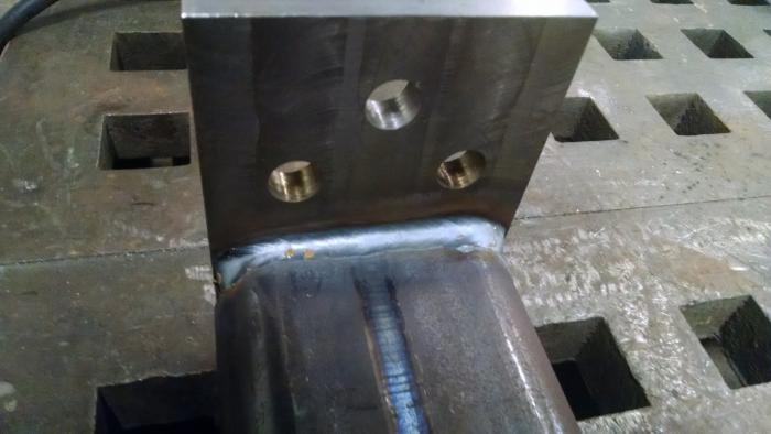

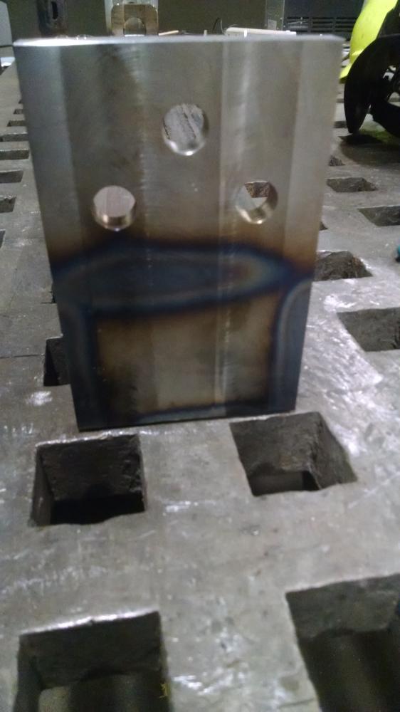

A new structural support for a product dumper at work, A500 steel, 3/8" wall, 1/2" end plates, 1" center tab. I use a Miller 252 with 98%2%, spray transfer. Requires a 30°single bevel per the print, I made a fixture and rough cut with plasma first, then clean it up with a grinder.
Backside
Backside
All complete, let it cool and paint

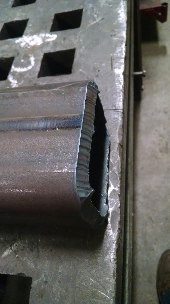

Rough bevel with plasma

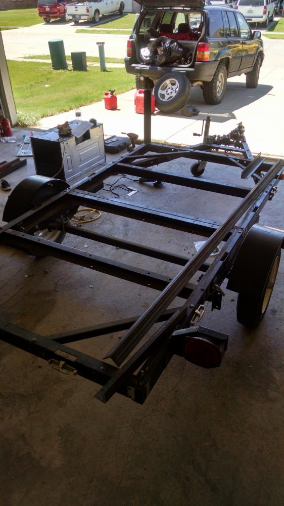

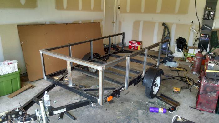

Before
After
Made a rail for a buddy's trailer yesterday. That was a cool experience and I actually made money on it too. The whole process of making a drawing, making a parts list, submitting a quote, and getting materials to do the job was very exciting.

Good job, you earned the satisfaction of a job well done from start to finish

Thanks LtBadd! It was fun, and I did a job that I'm proud of. The customer is very happy with it too. Now I've got the money-making bug lol

30 degree angle on the 1/2" center lug as well?

Shockingly all they call out is a 3/8" fillet, I bevel them around 30° which is around .25" in, put solid tacks, then burn it in.
I weld so much thin stainless, its nice to crank up a MIG or TIG nice and hot every once in awhile. I never used spray transfer till I did my D1.1 3g test on 3/8" plate, the penetration impressed me immediately...after I got use to the sound difference.
