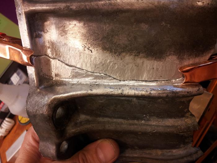

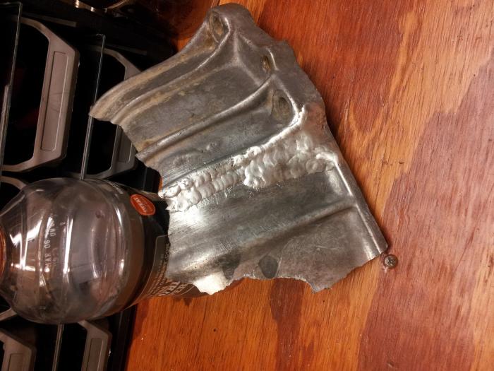

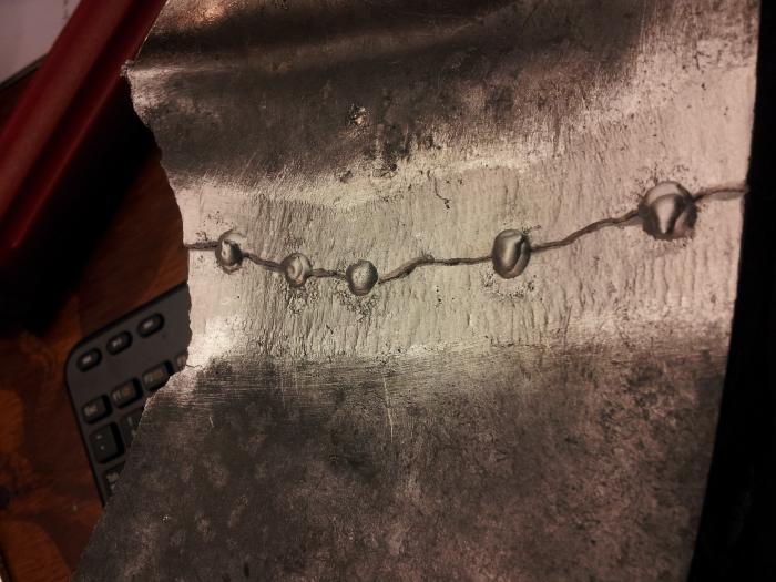

Had to repair a small cast Aluminum part recently ...it was pretty difficult going but I got it done.
This week I went over the scrapyard, I figured i'd grab some scrap cast Alum parts, break them, then practice welding
them back together. It's not pretty but I had fun practicing on it...also took a quick video trying to break the weld.
Broke a piece in half
Cleaned it up and clamped it
Put a few tacks in
Put a few tacks in
Finished ...gonna smash it now
Video of sledge hammering it v
https://youtu.be/-DSUUoJY59c

There is something satisfying about a bit of 'percussive maintenance', or getting to beat the ever loving snot out of something in the name of testing!
Congrats on your welds holding up better than the base material, during your destructive tests, as well.

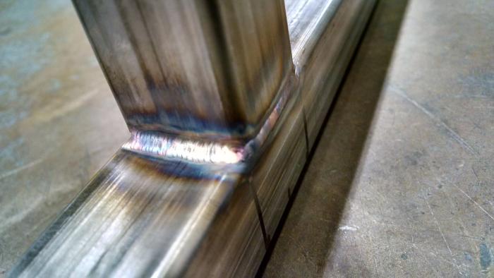

Started fabricating a new sanitation cart for one of our product fillers. 1/16" wall 304L tube
Update-9/11 added finished photo

Nice work, Looks great !
Rick_H wrote:Started fabricating a new sanitation cart for one of our product fillers. 1/16" wall 304L tube
Nice work Rick, is that two cups that seem to be levitating?

Yes they are welded to the frame, 2 fill tubes fit down inside them so they can be washed, sanitatized and dry.
