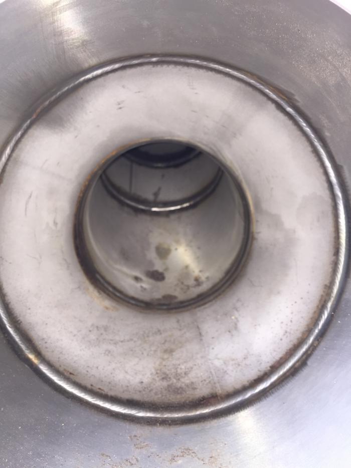

anyway i was removing some pipework from site today and came across a 8" - 6" reducing piece that was no longer needed. i new the welding was good because it was on a caustic acid job, anyway cut a long story short, i was amazed by the welding on this piece of pipe.
since ive seen it i need to know how its done, please help me
could anyone help with how the welder did this.
the pipe is schedule 10s stainless steel, i know its a walk the cup job, stuff like gap, wire size, technique and purge.
all i know is the welders code number "JJ 105" all credit goes to him/her
i have some pictures below, enjoy

I wouldnt presume its walked.it just looks like a regular dab and move root,but expertly welded and purged
Dancing with the blue lady
It probably was walk. Beveled to a knife edge and then gaped just the way he liked it. Probably used a rod just a little larger than his gap. This also requires that you grind all start and stops. They get feathered down to almost nothing at the end and then you light up back on top of were you started. That way you get some heat started before you get back to the gap. I don't do a lot of sch 10 but the guys in our shop who do lay every root like that. I'm in aww.
wheresmejumper wrote:I wouldnt presume its walked.it just looks like a regular dab and move root,but expertly welded and purged
Agreed, doesn't look like a walk to be. Looks like good prep, good purge and good GTAW pipe welding skills

I'm sure it was walked, the cap is walked for definite, I didn't take photos of the cap because it was wire brushed with a steel brush so it's got specs of rust on it.
how has he/she got the protrusion on the root? I've tried small and big gaps, high and low amps.
I can get the ripple affect by walking the cup, but I can't get the protrusion on the root, just flat
what sort of amps would you recommend with what gap
