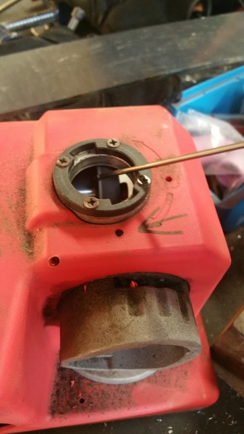

I was using a grinding wheel in a 5" grinder and the cordless drill but found a better option the other day. Tried talking my father out of buying a Drill Doctor a few years ago but couldn't change his mind and somehow it ended up at my place. Anyway they are next to useless imo for sharpening drill bits however it seems excellent at grinding tungsten.
The wheel inside is diamond and replaceable, it even has an edge on it you can use to score and snap the tungsten and a dust box to collect grinding dust if you're using thoriated tungstens. Being diamond you just have to roll the tungsten a few revolutions for a point from scratch. Think its something under $100 here for one. May not be worth going out to buy but if you find one dumped or got one lying around it works really well.
does it grind the tungsten lengthwise the way it is supposed to be?Rupes wrote:I was using a grinding wheel in a 5" grinder and the cordless drill but found a better option the other day. Tried talking my father out of buying a Drill Doctor a few years ago but couldn't change his mind and somehow it ended up at my place. Anyway they are next to useless imo for sharpening drill bits however it seems excellent at grinding tungsten.
Just realized this morning this isn't "Drill Doctor" I think this is actually a cheapo imitation of a cheapo tool. But I've seen them everywhere so must be pretty common. Saw one on ebay for $80AU brand new. Guess the main thing is if you can probably get hold of one of these or something close pretty cheap. Think they all have replaceable wheels and no dressing stones or dedicated bench grinders etc
Note the hole the arrow is pointing at. Just drilled that there as a bit of a guide
Scoring it to snap off however it does cut right through pretty easy
I did this batch this morning in less than 2 minutes, though I was flying through them and not being too carefull with them. Some I might redo.
