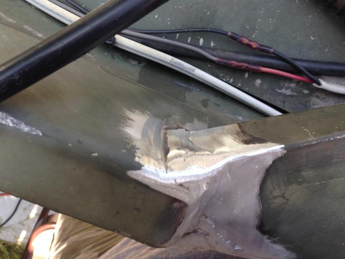

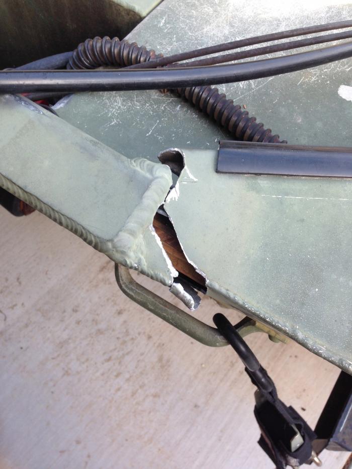

Today I repaired an aluminum john boat and would like for someone to help me fine tune my welding. There was a ton of porosity and my arc was very unstable. Crappy beads. But in the end it was welded. We'll see if it lasts. Here is what I did.
1. Cleaned the crack with emory cloth.
2. Cleaned with paper towels and acetone.
3. Welded the crack.
4. smoothed out the bead. (it looked horrible)
5. put on fish plate.
6. smoothed out the bead
It was windy so I know I wasn't getting good protection….i had the flow set at 30…maybe i should have gone higher

when i'm in a booth on nice clean metal, my beads actually look pretty good….to be honest i'm kind of embarrassed about this work. I know I can do better.
One thing I've noted since January….in the field, everything is out of position. ha :shock:

I have a few comments, you're never going to get a good looking weld in wind, so you were on a hiding to nothing there, contaminated material wont help either, added together, well..........
I probably would have cleaned a spot on the flange near the weld for the earth clamp, you have no idea what was lurking under that handle or between the rivets and the body that would effect a good earth connection.
Finally what did the other side of the weld look like.
Experience comes from "issues", your next attempt will prove that.

I would avoid cleaning with emory cloth. I work at a plant that builds aluminum petroleum tankers. It seems that every time you have to tig over an area that has been sanded, you end up with porosity. I think the grit from the sanding becomes imbedded in the aluminum. In your place I would have cleaned the crack with a carbide burr.
In breezy conditions you can set up a screen to block the wind. Also, you can use aluminum foil taped next to the weld to form a trough to contain the argon. Check out some of Jody's videos. You can learn a lot of tricks to make life easier. Hope this helps.

I use cardboard boxes to build walls around what I'm welding on if I have to weld outside. Cut them up and fit them around whatever you are welding. You can use masking tape to seal them. You must keep the air still around your welds. Sometimes turning up the argon can cause more problems.
Welding boats is usually not going to be pretty. I wish people would bring their boats to me as soon as they crack. Instead they smear epoxy or silicone into the cracks, and then when that fails they want it welded. It would be so much easier to weld if they had the welding done before they smeared all of that crap into the cracks.

That job would give ANYONE fits. The wood in the transom is smoking. I've done many. On the top though, the paint wasn't buzzed far enough back. The coup de grass was the wind. The advise above is sound; stay away from Emery.

Update, the weld broke while he was taking it to a lake. Sigh. If he asks me to do it again, I'd have to tell him that the wood has to come out.
