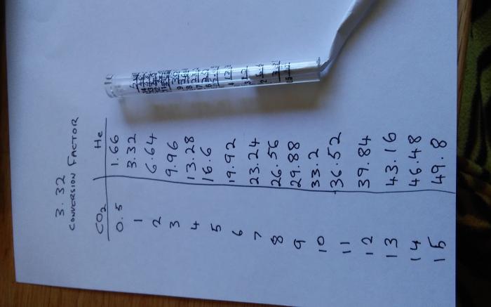

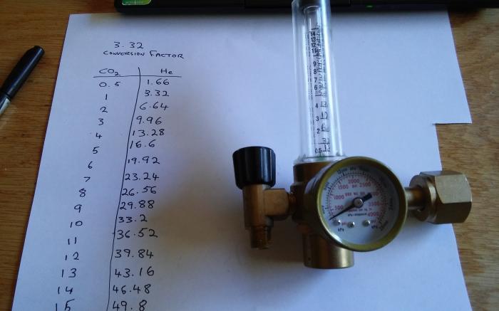

Here is another way to get as bit more accurate reading on helium and/or CO2 mixes with argon. Cheap low flow CO2 flowmeter off eBay marked from .5 to 15 CFH. Then figure the CO2 to helium conversion factor and write that on the tube with a Sharpie.
- uploadfromtaptalk1445344985238.jpg (28.66 KiB) Viewed 2055 times
- uploadfromtaptalk1445344961720.jpg (32.98 KiB) Viewed 2055 times
Great idea - wish I'd thought of it ! I only ever guess the flow by listening at the cup - hate those flow meters though - I think they are sold cheap by gas suppliers as they tend to have 50 > 75 psi fixed pressure regulators - the initial surge wastes gas like leaving a valve torch on & forgetting it ( obviously I'd never do that !! )
