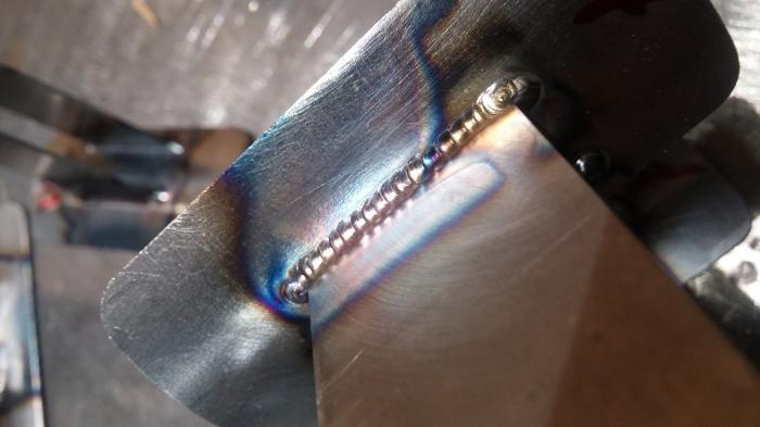

Welded these out today after getting some of my issues out of the way. Now if I could only see to weld. I think this is a huge improvement over what I have been doing myself.
All of the welds are not perfect....but they are going to be glass beaded, epoxied , and bolted on the plane. Minimal if any, very sparse oxidation on inside of .040" upright pieces. Pulley brackets are finally done. If I would have known building a tungsten grinder would have helped me this much...I would have built it before I had the weld machine!!! Still paying for education I guess

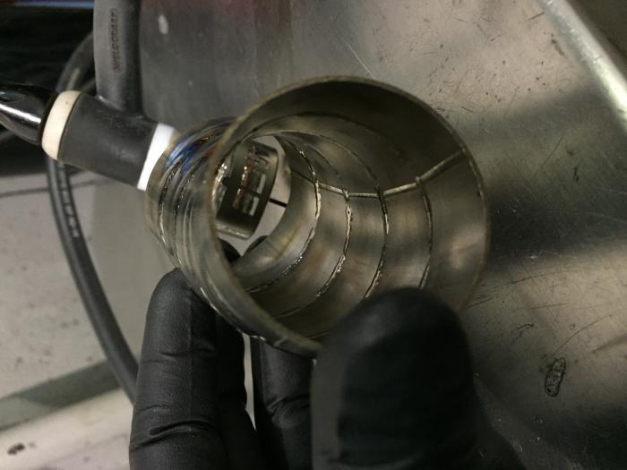

My first go at titanium! Really excited about this stuff. I know there is a bit of colour there which is not acceptable in most industries. I will need more practice before I try anything structural. I would be using it more for exhausts and intakes.

Sweet!
Love seeing welding in titanium. Sure looks like you're getting a handle on it fast.

For an exhaust I think this will be more then acceptable, it's not an aircraft component, also the inside looks to be well purged so it'll probably outlast the vehicle.AFR_Autoworks wrote:My first go at titanium! Really excited about this stuff. I know there is a bit of colour there which is not acceptable in most industries. I will need more practice before I try anything structural. I would be using it more for exhausts and intakes.
Good work

Thanks! I really hope to become allot more comfortable with this stuff. It is certainly fun to weld. Tacking it is a different story though. I had a friend hold a #8 gas lense to the backside of each tack for me. It sucked but I am sure I will develope a better method.

That really made me smile! Whatever gets the job done, right?AFR_Autoworks wrote:I had a friend hold a #8 gas lense to the backside of each tack for me. It sucked but I am sure I will develope a better method.
