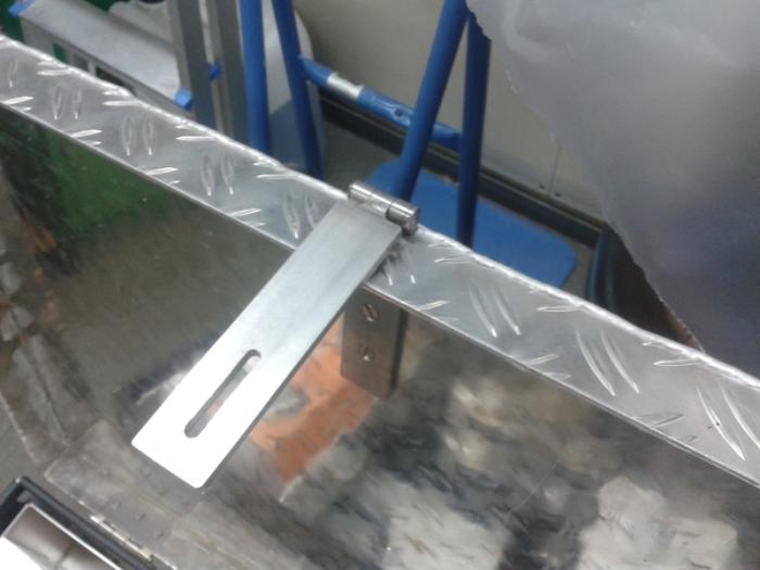

Made me a little "handrest" a few weeks ago for welding up an aluminum box which I`m gonna use for transporting my race track stuff... two smaller boxes will follow for tools:
Couldn't have done it without my DIY tig cooler... these welds are 700mm (27.6 inches) long and the aluminum is 3.5mm thick.. whatever this is in inches :D ... something like 0.137795275 :lol:

Well done Alexis. Great work as always.
You'll never regret making those hand rests. Be you are still using them in 20 years time.

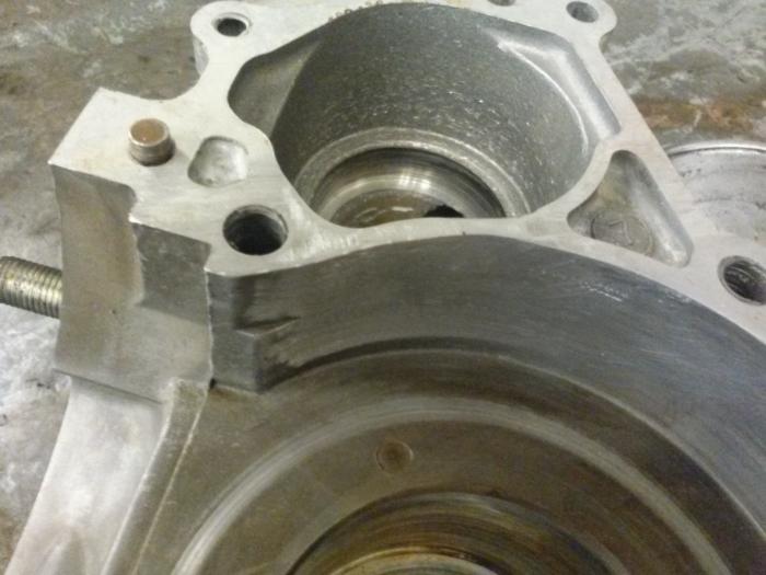

Cracked Polaris 400 2 stroke aluminum engine block, both halves of block was cracked. They blew it up. It is cracked between crank and counter balance and in front of motor. took pics of crack and after machining. pics are not that great and didn't take pics of other side.
front of block
After welding and clean up, had to remove bead for crank clearance so cleaned up outside too. Might as well make it look like block wasn't repaired
Crack between counter and crank
Repaired cracked

Very nice. How did you clean it up without leaving any evidence?

big gear head wrote:Very nice. How did you clean it up without leaving any evidence?
Thank you,
You can see some of it inside of case between crank and counter balance has scratch marks still where I blended it in. Didn't bother to smooth that out since it's hidden. This was all done by hand no cnc or end mills :D First off I use rotary bits to cut down bead to almost level. Then used files to get mating surface back to true with rest of case. Inside areas cleaned up with little drum sanders on a dremel. Use different grits depending how much material still had to remove. Blended the inside with sanding drums also. The outer part of case was cleaned up using rotary bit then flap discs on angle die grinder, again use different grits as I progressed. The last step on outer side of case used red scotch brite hand pads and alcohol based cleaner to blend in with case. This was also done on mating surface. Hard to tell by pic but there is a slight color change where filler is, this will blend in more as it oxidizes. The rotary bits was used with angle die grinder also.

Joe and Midget -
Both amazing jobs, well done. Joe...that looks almost Steampunk! Midget...great info on finishing and blending. I have a two stroke to work on soon as well. Tell me, was there much work involved in cleaning prior to welding? I imagine the engine parts had plenty of oil soak?

Thank you for MosquitoMoto
To answer your questions, I found the 2 stroke cases easier to work with then 4 stroke cases. Now when it comes to 4 wheeler or utv cases I mainly weld on Polaris stuff. Except for magnesium and aluminum racecar stuff. Polaris uses synthetic oils in both. The 4 stroke oil is a pain to clean up clings to everything and hard to dissolve. Sort of like the mag and aluminum cases on the racecars. The 2 stroke oil they make seems like it burns off pretty easy I'm guessing to help lower emissions.
Now as for how I cleaned the case, I sprayed it down with a mult-purpose solvent made by Wurth. I then blew it off with air hose. Used the same solvent to spray down in the cracks. The solvent in larger cracks spray out other side. Then Blew threw cracks with compressed air. I use a propane torch to heat the cracks and surrounding areas to try and burn off oil and solvents. After this I take a rotary bit and grind out the crack on both sides going past the crack. Depending I might stop the drill crack or not and clean surrounding area with scotch brite pad to help remove oxide layer. Might even use emery cloth. I then spray area and spray threw crack again with solvent followed by blowing out again with air. Next I wipe with acetone being liberal with acetone at the cracks. After it dries I either weld it or preheat it if I think part might need it. When welding cast sometimes the puddle might get all foamy, crap in cast burning out. Oil or just junk in metal. Sometimes it's not much and the puddle stabilizes so can add filler and continue. Other times I stop and use rotary bit to clean it out. Sometimes best to add a little filler then grind it back out and reweld it. Its kind of hard to describe this part of it depends on how it looks when molten if that makes sense. For instance it might bubble up you add filler and bead looks ok, however if you grind into it you will see porosity. Have seen it look like a sponge just under surface of bead. Naturally you don't want to leave that in there. Hope that makes sense.
That multi purpose made by Wurth is a non-chlorinated solvent the ingredients list is N-heptane(142-82-5), isopropanol(67-63-0) and carbon dioxide (124-38-9) I always let it dry completely before welding over and clean with acetone right before I weld. I like the solvent just not the price.
