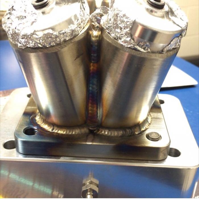

Well, if I only post my best it's just bragging, not learning. So here is my practice for today. Still learning TIG in prep for doing the front half of my rollcage (did the rear a few years back with MIG)
I try to start each session with a 1/8" aluminum fillet as it shows my bad habits and technique problems the most. Was going OK until towards the end of the 2nd one where I started drifting away from the joint and overheated it
The pipe is 1-5/8 .120 erw (the cage material is 1-3/4 DOM but this is all I could find in my metal supplier's offcut pile), using 1/16 er70s at 120 amps 3/32 2% lanth stubby gas lens, not using full pedal most of the time, mainly to start the joint esp for the really deep accute stuff.
Any tips or suggestions welcome! I saw earlier in the thread you guys get that nice shiny rainbow effect while mine just looks like a neat MIG weld. Is it because I'm not cleaning up the pipe? (just gave it a onceover with acetone) Penetration seems good which I guess is what I'm mainly worried about.

The joint will be stronger with ER70S.
You probably need to clean the surface better with a sander or something. Can you see the puddle good? Is your lens too dark? It looks to me like you might be having just a little trouble seeing the puddle and that might be causing your bead size to vary some. Maybe you are having a hard time propping your hand or getting in a comfortable position. Not trying to be critical, just trying to help.

Haha, thanks Kym!
Got it, will stick to ER70S in practice.
Yeah after I hit the surfaces with a flapper before joining, the weld stayed much shinier.
I do have a bit of trouble seeing the puddle sometimes, I may need to lighten the lens as I darkened it to 12 for doing the aluminum fillets, as my eyes were getting tired. But mainly it's just lack of experience. In practice I will likely do more stops and starts to maintain proper torch angle. Here I was trying to do at 1/8-1/4 circumference at a time and I would sometimes not notice that I'm not perpendicular anymore.
I also have a weird issue with being too ginger with the pedal. It's one of the bigger problems I'm working on that I notice consistently. I road race a very high power car so I've trained my right foot to be very progressive and it doesn't serve me well with the TIG pedal. I notice it's worse with steel because it will seem to puddle fine at lower heat but I then notice that the fillet is too small for my liking and I goose it.
One of the things I love about TIG so far is that you get do-overs. Since feeding filler is up to you, if the weld sucks, do another pass

To get a shiny rainbow effect there are a few things you need. Good gas coverage, it helps to use a large gas lense if you can't maintain a good torch angle. Have to have the tubing surgically clean. I use emery cloth around the cope till it is polished. I then use a die grinder with a sanding wheel to polish the inside of the tubing. After that I wipe it down with acetone. The last factor is keeping the overall heat input down. Allot of guys achieve this by either using a pulse setting or setting the welder to around 150 amps and manually pulsing. Also, don't stay welding the same area too long. Weld a bit and then move to a different area. It will take a fair amount of practice before you get the hang of it. Once you get in the car and start welding it is a totally different universe. Keep at it!
Thank you for the tips! Yeah I'm definitely staying in one place too long, you can see it by how close my ripples are located. Part of it is me trying to get the torch moving around the radius awkwardly. Like you said, practice! I've purposefully tried to keep it awkward, the pipe isn't secured to the bench, the angle isn't ideal etc, so that it's as applicable to doing it in the car as possible but I have no illusions about it not being hard in the car. I built a switch that I think will come in handy with a few seconds of downslope and 2T hold. It'll give me time to reposition.AFR_Autoworks wrote:To get a shiny rainbow effect there are a few things you need. Good gas coverage, it helps to use a large gas lense if you can't maintain a good torch angle. Have to have the tubing surgically clean. I use emery cloth around the cope till it is polished. I then use a die grinder with a sanding wheel to polish the inside of the tubing. After that I wipe it down with acetone. The last factor is keeping the overall heat input down. Allot of guys achieve this by either using a pulse setting or setting the welder to around 150 amps and manually pulsing. Also, don't stay welding the same area too long. Weld a bit and then move to a different area. It will take a fair amount of practice before you get the hang of it. Once you get in the car and start welding it is a totally different universe. Keep at it!

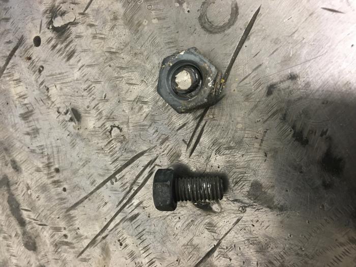

Because of the nature of my business I get a lot of broken bolts in exhaust manifolds and other engine parts. Over the years I have tried just about every nut and bolt extractor money could buy. More often than not I end up burning out a drill bit out of frustration or when it does drill my hole is not straight. So after much trial and error I have come up with this method that has done well for me. When I was a heavy duty mechanic we used unicrom rods from Arctec. worked awesome at getting broken bolts out. Any way, I never had great success with using tig rod. my welds would always break. so I started to use the unicrom. I break off the coating and weld away.

Sorry for the lazy question but what makes these special?
- Skylineauto
Im not a welder, I'm just a mechanic that can weld. Quick search of their site rates the rod at 120,000 psi. From what I remember most steel rods are in the 80,000 psi. I do know they have a high chromium content.BigD wrote:Sorry for the lazy question but what makes these special?
