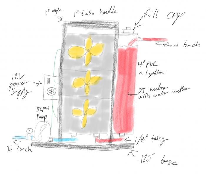

I'm building mine now but was going to use a CPU water cooled radiator:
http://www.amazon.com/gp/product/B007YL ... detailpage
some case fans:
http://www.amazon.com/Rosewill-Computer ... m+fan+pack
a 12V pump with a potentiometer for rate control:
http://www.amazon.com/gp/product/B00DYQ ... detailpage
A pressure gauge between the pump and the tig torch should let me dial it in to a reasonable flow rate. A computer power supply hacked down for just the 12V rail (bridge green to black to turn on and then the yellow wires are the 12V positive) will meet the needs of the pump and fan and also serve as the on off switch. A 4" pic pipe will act as a 1 gallon reservoir and Ill mont that vertically next to the radiator on 1" .125" angle iron with a .125" plate as the base. I think all in I'll be at around $120.
Something like this arrangement (yes I know I can't draw for crap lol):
some case fans:

I meant to write about the cost. I know someone asked on one thread I read wondering if it was worth it to build one or buy one.
It would probably be cheaper to buy one if you don't have a full set up of tools to build one. I had to buy a duel regulator, ($100) hoses, and connectors for the argon backing. And the extra argon. Also, purchased hoses and copper pipe to use for the backing. And a little bit of trial and error cost.
I was basically learning on the job which I knew when I was going into to. But the best thing about this is I can fix it if it breaks. And I built it, which is for me, the main reason for doing it. It was fun to do and no warranty needed.
I just quickly added up the cost on in my head for the parts used. I would say around $350. Give or take $25 or so. I can't really say how many hours I put into. It was on and off for the past three weeks researching, ordering the parts and building it.

If you have to pay eBay prices for all the components then a commercial set up is probably cheaper. I had access to a pump, motor, coils and fans. So I'm building mine.
