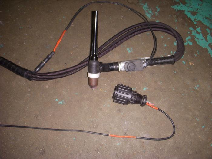

Especially handy when asked to weld joints that are not common that have to look good, or where you only have one chance to get it right with no way to set up practice runs. Also good for matching other weld profiles such as those from automated processes or perhaps, spool gun welds. Another area where this is beneficial is when you have to use unorthodox manipulation of tungsten placement within the joint, to where a calculated and smooth forward travel is not possible.
Below is an operation where a structural backer was used. It's not super critical, but I added it for redundancy. Not knowing how this joint will be abused in use. Some people can break anything. Bump welding it allows instantaneous control over penetration, fill depth and bead width.
Starts out by burying the tungsten (in this case, 1/8" pure) in the root
You can see how the arc is ultimately focused on the backer without really disturbing the edges of the butt. If there was no backer, you could tap the on/off switch while simultaneously adding filler to bridge the gap with more control than one might think.
Here shows the kind of backer I am using. An opened section of a smaller pipe. These draw tighter inside to the walls as you weld around the joint.
My cellphone camera sux, but you get the idea. This is filled with the tungsten buried as pictured above, and then rolling the tungsten up out of the joint as you add filler. No changing positions. 2/3rds of the way around the pipe standing in one spot. A renegade fix for sure, but when the powers that be inform you that they did not order enough pipe for full sections, this gets it out of your hair pretty quick, without special fittings or compromising build integrity. If I was going to make these invisible, I would cap them enough to grind/sand flush.

So help me out, I've never heard of bump welding. It seems to me that you're powering on just long enough to tie in at the bottom of the joint. If you stayed on too long the puddle would want to run up the side walls and break the top edge.
if you're using your Dynasty why use a balled pure tungsten?

LtBadd wrote:So help me out, I've never heard of bump welding. It seems to me that you're powering on just long enough to tie in at the bottom of the joint. If you stayed on too long the puddle would want to run up the side walls and break the top edge.
No, I leave it on and fill it from the bottom up. I just start a good burn down at the bottom and roll the tungsten up and out as it fills. I only bump really when I am changing the gravity of the weld. The pipe with a backer I did both forward and reverse travel. Usually it's both. Reverse travel I can control the heat as far as I can reach around it and up underneath a ways because I can easily see the tungsten. Forward travel vertical up almost to the peak, bump it up over the top, while switching to reverse travel on the vertical down. That way, the arc is still pointing uphill, so you don't get a washed out, down hand weld. There's enough mass with the backer to go steady travel at 250 amps for a ways on these joints, and quite quickly and without runny looking beads.
Because I can't be bothered with sharpening tungsten, or running the machine in a way to preserve it. I dunno. . .it was just never broken enough to fix, more than anything else. We've been building like this for nearly thirty years by now and we still contend.
I use the Dynasty outside in the boats and such, but in the shop, I'm still using an old ass'd synchrowave. We've had guys come in who were used to the inverters. They change it over to their way, and it doesn't look any better than anything else, and they have to sharpen tungsten. Then they just drift back to our way of doing it.

We just recently got my old A/BP up and running here at home and got a foot pedal for it. Torch has the switch on it and it is wired into the pedal harness so we can tack with the switch and weld with the pedal without having to drag it around for everything. I have even less equipment at home but we still get by.

Installed TamJeff style pendant switch about 8 months ago
Bump welding works,No dragging a pedal
Seems 250 syncrowave with continuous HF likes it better than the inverter.
But the method works,(both AC/DC) thanks for tip

TamJeff
    Tue Dec 04, 2012 4:46 am
rick9345 wrote:Installed TamJeff style pendant switch about 8 months ago
It's a sort of renegade approach but, at least one can make saleable, sound welds until torch skills catch up instead of the other way around with a pile full of disasters in the scrap bin. I weld both ways, with and without the pedal these days but this is my go to, assembly and production method. Also, it makes everyone in the shop turn out similar welds so we can share tasks on projects instead of the one ace having to do ALL the decorative welds.
