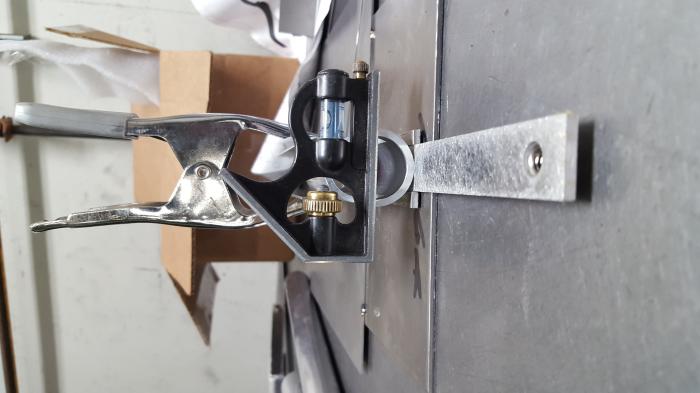

Hey guys. Been a few years since I have been on here but looking for some advice and this is always a good plave to turn to for that. Had to weld up this job yesterday. Tubes are 1.375inch in diameter and .125 wall thickness with a .250 gap in between, base is .080 aluminum. Tubes have to be welded all the way around. What tricks or techniques do you guys use for squaring aluminum and also centering things up on tubing, I work by myself so squaring aluminum is always challenging for me cause I can't just throw a magnet on it of hold it and get a fuse fuse tack. Also how would you guys approach welding this? I welded 1 tube in at a time to have the best access possible. The 4th tube was really hard. Welding most of it with a number 5 standard Collet body, tried a number but got really poor shielding and still didn't fit threw the gap. I ended using a number 7 gas lens and sticking the tungsten way out. Is there a different style torch that may work better? I used a 20 with a button cap on back. Thanks for any advice! I am always looking to learn and improve my skills.

The tubes are threw tubes, so I was referring to squaring both ways. They had a square cut but that wasn't the issue. I ended up taping 2 squares, 1 on both sides, to each tube with the tube at the 2 inch mark on the squares. The pictures don't show it well but the tubes run threw the base and have notches on the other side with a piece of material welded on with a piece of hardware in it as a mounting hole. I had to index all the notches and hardware a certain way. Was wondering if there was some short of "aluminum magnetic square". I know aluminum isn't magnetic just didn't know what to call it. I tried the jumbo ck cup but the tubes were 2 inches and couldn't get any shielding with that much stick out. Also tried a really lone nose number 4 cup but that wouldn't fit in the gap. That ozmo torch look sweet! Also though about the micro torch. This was just a prototype but I might end up having to do a bunch of these so trying to get it figured out. Thanks for the advice sandow. I might just have to build a argon damn.

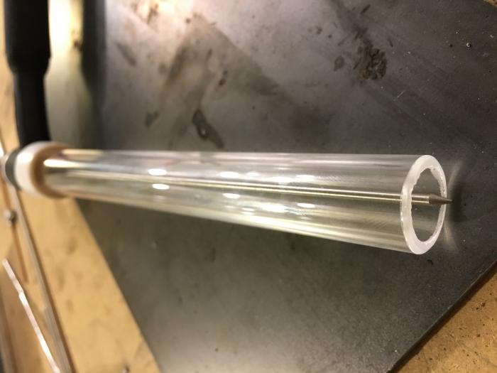

Two more ideas... one I only suggest cause it would look absurd...
This might get you in there:
http://www.amazon.com/TIG-Welding-Torch ... ng+tig+cup
And for the clown college solution, slide a really long glass tube over this:
http://www.ckworldwide.com/standard-kits.html
You could get about 6" from the torch head and still have a solid grip on the electrode. If, you try this though I'm going to have to insist on pictures

- Looooooong cup
- image.jpeg (34.28 KiB) Viewed 2641 times
- Looooong cup
- image.jpeg (37.35 KiB) Viewed 2641 times

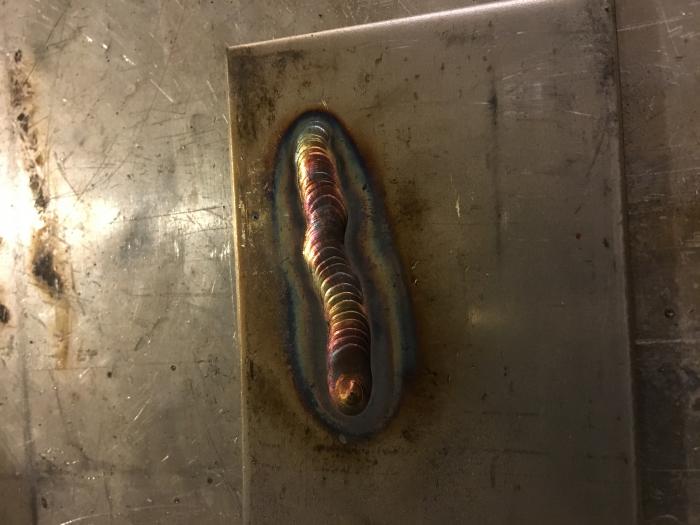

Seems to shield just fine though the tungsten is a little off center. I puddled some 304 and it stayed uncolored on top and about a nickel size rainbow on the back. I'll try and get some video later.

You can use a 1-2-3 block set bolted at a 90* angle and run a nylon wire tie through the holes and around the pipe to hold it square. A small set of machinists v-blocks work well when used the same way. I made a set of X-blocks awhile back out of two pieces of heavy walled 1 1/2" angle welded point on point, makes them heavy enough to hold short pieces of pipe perpendicular to tack. You can tape the V and or X-blocks to the pipe with masking tape and remove it before the heat loosens the glue.
