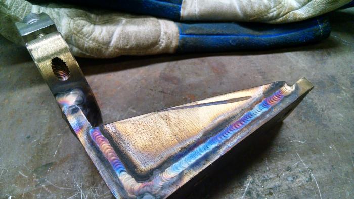

Just a repair on a small piece of our liquid filling equipment, 316L small double bevel, .035" filler...

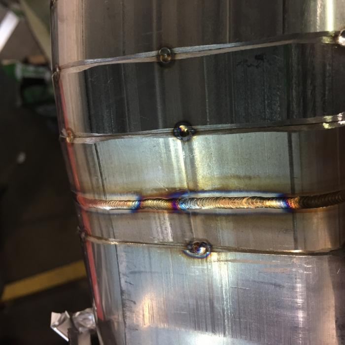

Just working on some 4" oval exhaust for a drift car. Tons of stainless practice.

Geeeze that must have cost a bomb to make in wages!
AFR_Autoworks
    Mon Nov 30, 2015 2:35 am
    Red Deer, Alberta, Canada
It's really not as time consuming as you would think. There was allot of weld time and back purging involved but as for cutting, I have a good bandsaw which has cut my time at least in half. I can setup a cut, while it is cutting I debut and tack the previous piece.

Got it all welded up today. Pretty happy with where my welds are at but I could still use some more practice. Also, my back purge could have used a bit more flow.

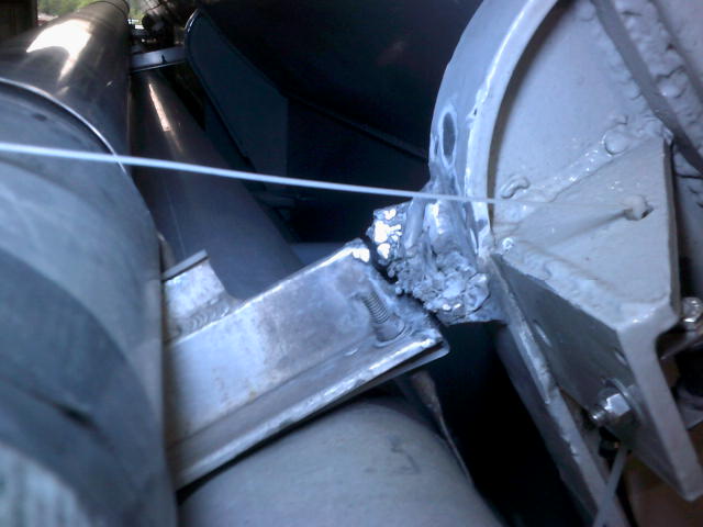

Little repair job 304L...not fun when you find someone did a previous repair with silver solider instead of welding... Makes damn mess.
Damn silver soldered joint after striking and arc
Finally got it to take some filler
Finished

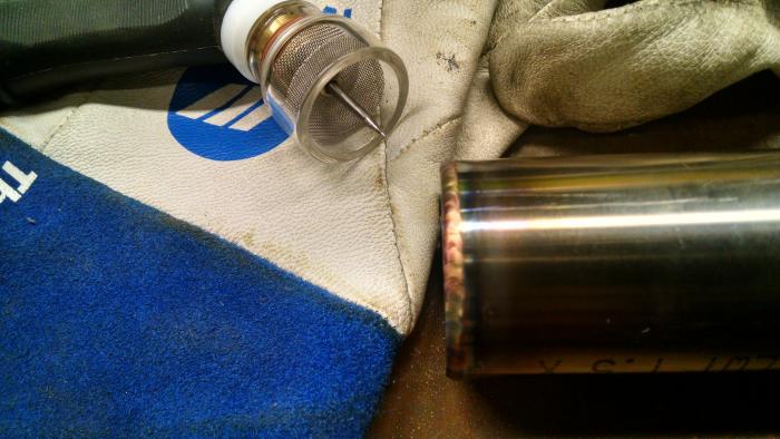

Whipped up a bracket for a printer cleaning station for one of our lines...actually made 4 custom brackets depending on where they were mounting.
Rick_H wrote:Whipped up a bracket for a printer cleaning station for one of our lines...actually made 4 custom brackets depending on where they were mounting.
Nice work as always Rick, BTW did you bow the screens in the gas lens yourself?
Rick_H
    Sat Feb 08, 2014 1:50 pm
    PA/MD
No that is how they are run on the Furick FUPA 12 set-up...
AFR_Autoworks
I use the same cup! I absolutely love my FUPA cups. Really hard to beat them.

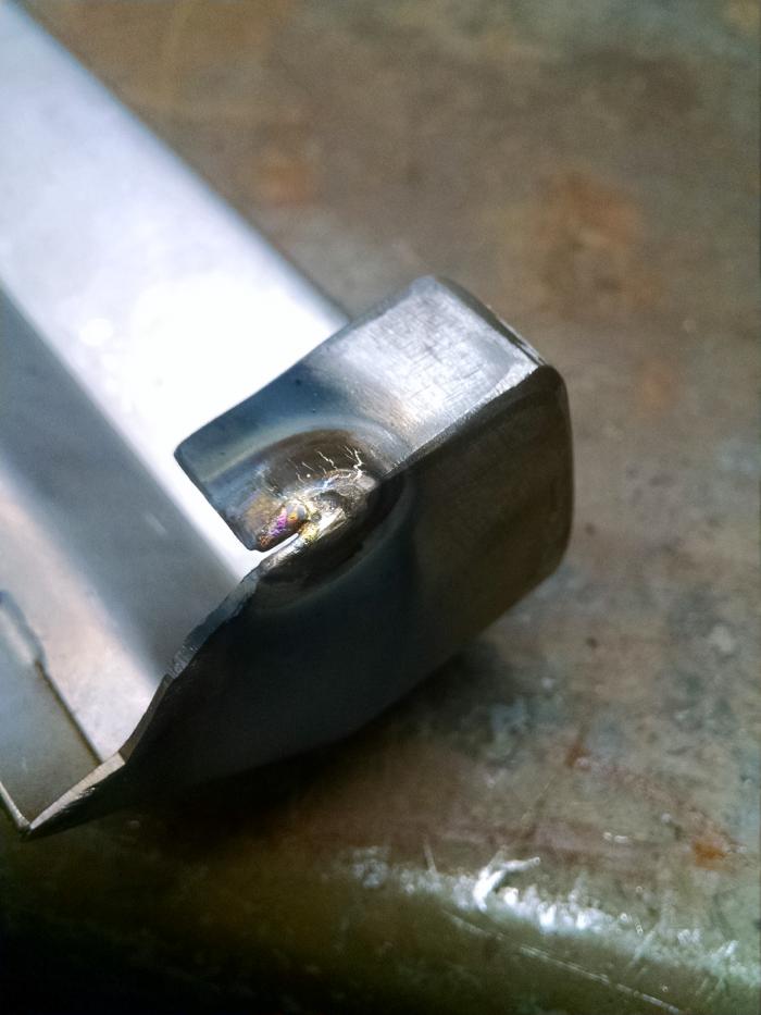

Today, I did the first "paying job" for our new company. It's simple stuff, but was urgent and I got paid well to do it on Saturday. For simplicity, I put it on my facebook wall.

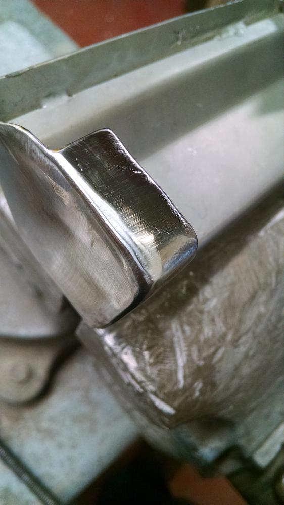

Here's the new bracket that replaced the previous turd.
