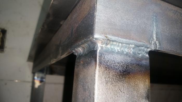

Hey all! I recently purchased my first tig welder, a Lincoln 200 square wave (mighty affordable for a new guy) . I have a basic understanding of the process of tig welding and do have some mig and stick experience.
I have been playing in the garage a bit to become familiar with the equipment and figured the best way to learn, is to build! I'm looking for advise and critisizum on what I have accomplished so far with my lack of knowledge.

Looks like you are doing pretty good. Maybe add a little more wire, or use a larger wire. Keep practicing and post when you have a problem with something.
Freddie
I agree not a bad start at all. If you want a weld to look a little beefier don't be afraid to go over top of it and add another layer till you get it filled out. I like to do multiple passes over just a single pass with tig. But that's all relative to thickness of material and how I want the finished product to look.

Is it normal to look grey like that? For some reason I thought it was supposed to have more of a shine.

- What causes the gold-ish color vs. The grey?
- 20160413_225405.jpg (29.16 KiB) Viewed 1683 times
That's why I recomended several smaller passes. It does look like it got hot. Or it could be from mill flake contamination. Or just from moving too slow. I might not be good at explaining but there is a balance between filler rod size, amps, material thickness, travel speed. These all are combined or are varied to give you an end weld of a specific width and thickness without over heating the material. It helps me to think of a finished weld as several layers not just one pass. One thin layer on top of the last till I get to the correct thickness and width for a given fillet. With out putting too much heat into it on any one pass.

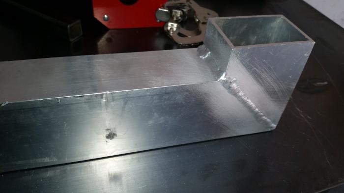

Machine settings were 120amps no pulse, 3/32 alum. filler rod ( have to find recipt for specifics), 1/8 aluminum plates. My argon cfh was like 35, I must have bumped it up without realizingChuck_junks wrote:What were your machine settings, material thickness, filler type and size? Easier to correct the problem when the basic facts are known... But a lot of times I find that if my filler is burning off before I can dip it then I'll adjust the way I'm traveling the torch. I'll move forward a bit then as I'm ready to dip I'll pull it back about half the distance and jam the filler in and bring the torch forward as I'm removing the rod. Also try to hold your arc as tight as you can with out dipping your tungsten.Goosepoop302 wrote:I noticed when I was working with the aluminum, my filler rod would melt away sometimes as I try ed to dip it in the puddle. I didn't think my torch angle was too Angled.. what else can cause this?
I just did the one below at 100 amps, 11g material, 3/32 filler and 15cfh argon
I'm assuming the black specs are from improper cleaning?
- 20160415_150343.jpg (23.96 KiB) Viewed 1605 times
It's not just improper cleaning. A slight draft for an instant will give you black pepper flakes. Also, outside corner joints are just a smidge tougher because the joint configuration simply does not lend itself to trapping argon to have it "linger around". The direct opposite would be an inside corner joint that can trap/hold argon because you're on the "inside" of the V, not on the outside.
