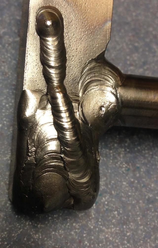

Your first problem is practicing SS welding hoping to get shiny colors on practice pieces that border on planck-length. You need large, flat pieces that have more surface area then smaller thicker parts of the same volume. Never weld directly over another practice piece unless that thing is dead cold. You're basically shooting yourself in foot with respect to your goals. Been there done that.
Stick a fork in it, it's cooked.
Looks like you shut off the argon while it was still glowing cherry red.

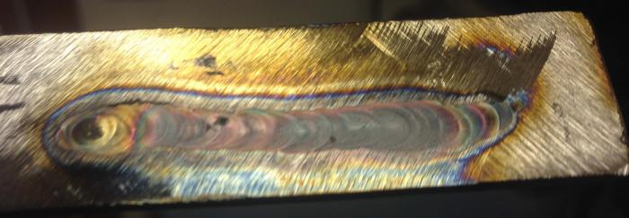

From what was said about my beads looking cooked but still on top I started to think about torch placement.
I did another weld paying close attention to where the torch was in relation to the puddle and I noticed I greatly favor the back edge of the puddle. When I moved the arc to the leading edge of the puddle things changed dramatically. That is after I learned how to keep the filler off the tungsten again. First of all it looked less cooked still not shinny but better. Also the puddle narrowed and flattened, travel speed went way up and it started to get the stack of dimes look

- as welded and wirebrushed

Your welds are too cold. Tig weld beads are usually flatter than mig or stick.That is why you are cooking your base metal. I don't understand what you are seeking to accomplish here. For 1/2" stainless you should be using well over 200 amps. Trying to form a puddle on 1/2" with 100amps is why you're cooking it. You want your puddle to form immediately, not have to wait for it. And have a really short arc length, too long of an arc length puts in too much heat. Stainless doesn't conduct heat worth a damn so all that heat from too little amperage is building up and cooking it. It might seem like less amps would put in less heat but it adds more by not forming an immediate puddle. The rule of stainless is get in and get out and that requires enough amps to form an immediate puddle, weld a bit and stop and use some sort of heat sink to remove the heat from it before your next bead run. Stainless welded properly gets various colors, straw colored being the optimum and it doesn't turn out shiny unless you wire wheel it. Mild steel will get shiny beads. In your first post you said you were using 1/16" tungsten at 100 amps. Thats about the limit of that size tungsten. Go up to 3/32" tungsten and filler and turn up the amps. I wish I got to do more stainless because it welds like butter but you have to be aware of the heat buildup which is what you're getting.

You are starting to get there brother. Here is what I would do. You said your base metal is 1/2" stainless steel correct? That is pretty hefty, here is how I would practice to get you dialed in.
Step 1- Change out your tungsten to 1/8" (2% T is fine, pretty much general purpose)
Step 2- Make sure you are using straight up Argon 15-20 cfh is just fine
Step 3- Put away all of your filler rod in a drawer somewhere
Step 4- Around a 1/2" cup is fine, you don't need anything fancy
Step 5- Double check you are DCEN
Step 6- Crank that puppy up to 300 amps (just a starting point, 1/2" SS trust me)
Step 7- Now start making practice undercut "fusion passes", you can do little circles, little side to side just don't get crazy. This will help you with torch control, etc.
Step 8- When you start making pretty little rose/gold color undercut lines in the base material (tweaking amperage), go find that filler rod and start dropping it in the puddle. I wouldn't go anything less than 3/32 filler if it was me unless you can feed rod like a mad man.

Notice how the small part of your bead has some color to it and the fat part is gray. You are getting too hot. Try to do a smaller bead and move a little faster. Try to keep it the same width. You also broke your arc too quick which is why you have that crater at the end.

It isn't that your machine isn't capable, it is that you are shooting for the moon right out of the gate.

The core lesson is simple. If SS is hot and exposed to oxygen it will color. The faster you can pull heat from the weld, the less time it will need to be shielded. The aluminum backing will limit backside exposure while rapidly drawing heat from the SS.
Thicker SS will take a long damn time to cool adequately so even the 1/8" is going to be a second step when learning.

That little dot that you show is exactly what you are looking for. Make a series of those and you have a bead. Hit the pedal...by the way,,,are you using a pedal? If not that explains a few things but you need to start a small dot/bead like you have, move an 1/8" and form another one...rinse and repeat. You also need to back off the pedal at the end of the weld and back up your torch and kind of smooth things out. You don't want a crater or a tit at the end of your bead. Remember to move along or you put in too much heat that can't disappate and your bead gets too wide and cooks the metal. Try just stringing 3 or 4 of those little dots in a row for starters and then add a few more as you get the hang of it. Also, 15 seconds of post flow is a waste. I set my machine at 6 seconds and have never changed it. Just use enough post flow to keep your tungsten shiny....any more is just wasting it but keep that post flow on the puddle when you stop the bead. It's also a big help to get in a good welding position so you can time your moves better. Keep us informed.
On my air cooled torch I need a lot of post flow since the wire and torch head are heating the gas up before it blows onto the electrode. The water cooled torches I've used at my school don't need nearly as much post flow to keep the electrode from oxidizing. Would also help cooling the workpiece slightly I suppose.exnailpounder wrote: Also, 15 seconds of post flow is a waste. I set my machine at 6 seconds and have never changed it. Just use enough post flow to keep your tungsten shiny...

Tried again, same setting but with a 1/4 inch aluminum back up plate and moved fast.
Guess what, I got some color other than all grey, still not pretty but at least not all grey.
When I said I moved fast, I moved way faster than I ever thought to go.

NOW you are getting the hang of it. Not bad. You kinda greyed it out by getting cerebral palsy a little ways into it but much better.
I hope you are taking this criticism in stride as we are all trying to help you. There is nothing new under the sun as far as welding goes so tried and true techniques always save the day. Filler metal cools your puddle so when you are ready to add filler, you have even more control of your heat input but save that for another day. Right now you should concentrate on moving your torch along in even increments and getting a good looking bead. It's all about seat time and proper technique so I bet in a few months you will be showing us weld porn. Good job! By the way, I hope you are watching Jody's videos. They are priceless in information and he doesn't leave out anything. His vids got me back in the Tig seat in weeks after a 15 year layoff. Don't get too caught up in making big long beads right now. The stainless guru's here will tell you to make shorter beads and get your base metal heat under control. As much as we all want to have that beautiful long stack o' dimes bead, stainless isn't your best choice for that because of it's poor conductive qualities. Get in and get out is the rule. One day you will want to move on to aluminum and a whole new can of worms will open up for you.

Adding filler to that will cool it more and help with the gray. See how you do with filler.

Maybe start listening to it, we are trying to help. You are friggin cooking it.mpete53 wrote: I am getting the advice I asked for.

Here is a orbital weld that shows a tiny bit of grey. Absolutely OK. People always tends to prefer silver and pink colors, because those are very nice looking. Truth is that in some cases it is impossible to get even pink color unless you don't want to waste argon and use trailing shield or something like that.

I am happy for all the advice I have been receiving.
I am trying to follow the advice.
I do not in any way mean any disrespect to those giving the advice.
I am sorry if I am a slow learner and am not progressing as fast as some may like (my self included)
I don't weld all day, I grab a hour here and there. I am not a welder by trade, but have done small jobs stick welding for many years. I always loved the look of a nicely done tig weld and now it could make such small, light gauge welds.
Why am I working with stainless? In a word BOATS. I have sailed all my life and there is always something to repair or a small bracket to make and I would like to use tig rather than stick welding.
Thanks again for your help
Mark
