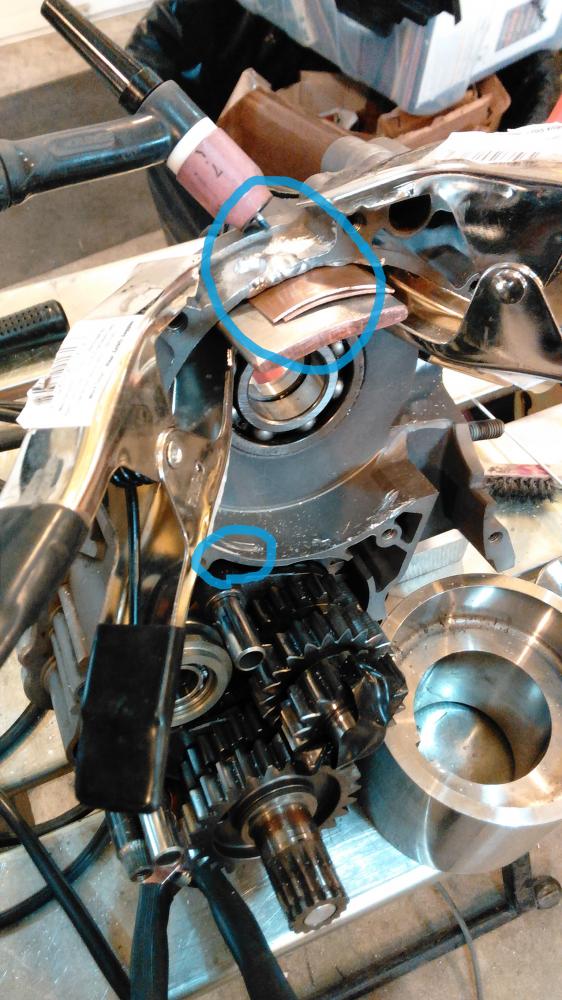

One of our buddies dirtbike engine broke a small piece off the bottom of the piston...it mushed around under the crank, causing about 6 cracks in the case that were from 1/4" to 1/2" . Welded them up. Made some backing out of 4" copper pipe and copper buss bar bend to the radius shape of the case . Guy did about 4 rides and one race on it , holding so far .
They told me it was Magnesium ...did the vinegar test on a sanded spot , no bubbles .

White vinegar will bubble on magnesium. It's ok craig, I didn't know about it either till I looked it up.motox wrote:please explain the vinegar test please.
must have been out sick that day.....lol
jeff
just wondering
I've welded up plenty of ending cases always AL
clutch covers and ignition covers are sometimes Mag
but haven't come across center cases in mag.
thanks for the tip!
just wondering
thanks for the tip!

They were so sure it was magnesium... anyway, I sanded a little spot clean and put some vinegar...no bubbles.

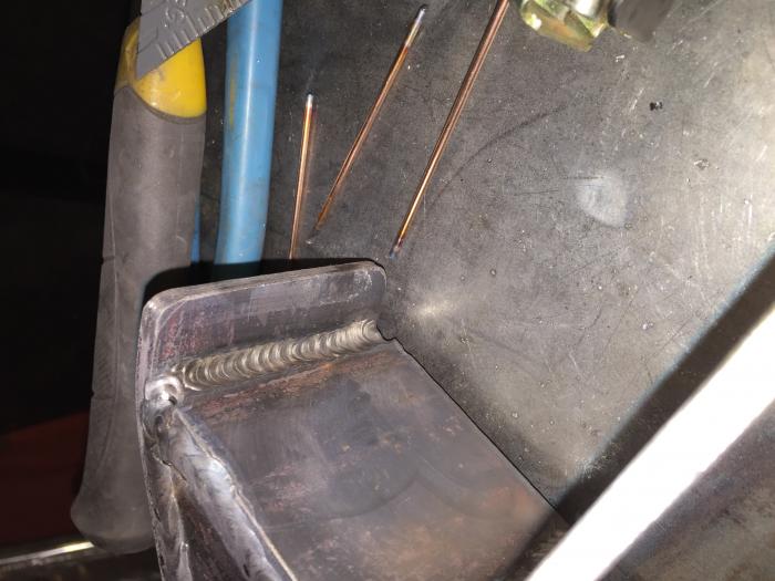

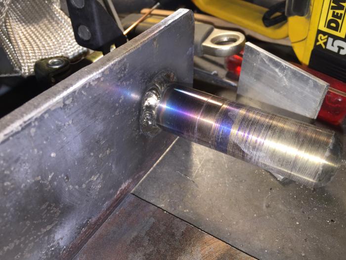

Started a new project, finally making my own power rack. Gonna be overkill out of 3x3 .125 but first the bar hooks out of 1/4. Do these welds look ok to you guys? The Miller wizard called for 225-300 amps. I set the Dynasty to 200 and on the outside joints it seems to be too much to me but according to Miller it's not enough. Proud if the machine, the fan never even kicked on high and I was using full jam at 200 amps for a good hour.
Specs:
Dynasty 210
200 amps
Air cooled 17 with stubby lens
15 cfh
1/8 2% lanth
3/32 er70s-2
