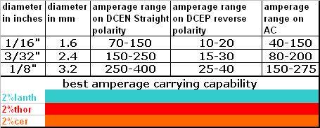

What tungsten are you using right now that gets the nodules?RamboBaby wrote:I also do not like the nodules that AC mode puts on my tungsten. It doesn't just do this some of the time, not even most of the time. It does this EVERY EFFIN TIME! And it pisses me off pretty bad because those things will appear even after I have rounded my tungsten if I'm really putting the peddle to the metal (over 200 amps). I'm thinking about trying 2% thoriated tungsten to prevent this because it didn't seem to happen as bad with that variety in Jody's tungsten video.
2% Lanthanated and the nodules are horrible once you hit about 175 amps. It could just be that my inverter machine is worse than most in this regard. Sometimes they're worse than others and I've been wondering if it has something to do with sharpening the tungsten after it gets dipped rather than breaking that whole area off. I haven't been breaking it off because that Lanthanated is so expensive. I have to ball the tip until its almost the width of the entire shank to keep from getting them at high amperage. Half the time when I try to get the ball to that point I go too big and that makes for an unstable arc.

each tungsten size,grade has an amperage suggested limit. Range not the same on AC as DC. Check application chart,one does not fit all. There is VooDoo in angle ,sharpness, that some use to crutch what they have on hand, For me I just change out tungsten and collets.

Thanks. I just found this chart in one of the articles Jody wrote and it seems to indicate just about what I have experienced. I thought the things were good for 250 amps and didn't take into account the ep side of the ac arc. I guess I really should have since it gets better as the ep is decreased.
Lanthanated does however seem to run good at far lower amperage than his chart indicates, at least on my machine. I also remember the old boss telling me that if I needed to use more than about half of the amperage on his machine (his was 320 amps) that I needed to switch to a 1/8" tungsten.
http://www.weldingtipsandtricks.com/tun ... -gtaw.html
- xtungsten-electrode-chart.jpg.pagespeed.ic.E03UxOuLEL.jpg (21.44 KiB) Viewed 9248 times

Yeah in my experience, 3/32 isn't good for long runs of over 150 amps, especially if tapered. Also with that kind of jam you're probably welding something quite chunky and I find a tapered 1/8" gives me a nice wide bead easier, while still getting into the root.Oscar wrote:If you're on a 3/32" 2%La and you're getting nodules, then you could perhaps switch to a 1/8" or try a different vendor for tungsten. You never know, you might have gotten a weird batch.
I've found that I have to fight to get it into the root but I've been focusing on thin to thick. I'll try 1/8" thoriated because I can't afford lanthanated right now. My buddy is giving me some more scrap aluminum today. I'll post photos of the differences between the two varieties and thicknesses of tungsten. I'll also try lowering the cleaning action a bit and see how it goes. Sometimes this stuff welds good even at 20%. It's just that none of the thick stuff will weld good with that little cleaning.BigD wrote:Yeah in my experience, 3/32 isn't good for long runs of over 150 amps, especially if tapered. Also with that kind of jam you're probably welding something quite chunky and I find a tapered 1/8" gives me a nice wide bead easier, while still getting into the root.Oscar wrote:If you're on a 3/32" 2%La and you're getting nodules, then you could perhaps switch to a 1/8" or try a different vendor for tungsten. You never know, you might have gotten a weird batch.

To touch on the subject of tungsten, Everlast recommends using Th tungsten, likely because it is the most accessible to people. As you have also made the switch, most of us have La tungsten in our box, but don't fear grabbing a piece of Th if you have the appropriate collets and gas lens/collet body for it. It will weld fine.
Personally, I use 1/8 tungsten on AC or DC on 150+ amps, unless I can't find a piece. Then I just dick around until the 3/32 tungsten deteriorates to complete shit (or I touch, whichever one comes first.) It's always an interesting lesson in arc behavior and arc quality when your tungsten is shitting the bed weld by weld.
