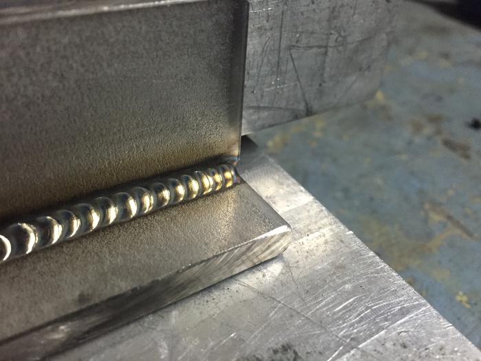

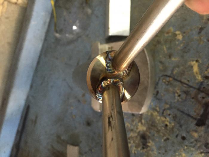

G'day everyone,
I am a fitter from downunder (Australia). Started my apprenticeship in food and beverage welding stainless steel and it stuck with me, always loved it.
Still working full time but trying to build a business on the side welding, mainly do marine work. Recently made a 3rd hand and have found it to be a great tool! Also appreciate Jody's vids, very informative.
Anyway, thought I would post some of my work, and some welds messing around trying to get better consistency and heat input. Cheers.

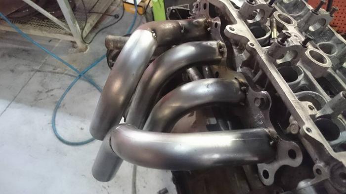

What I tacked up today.

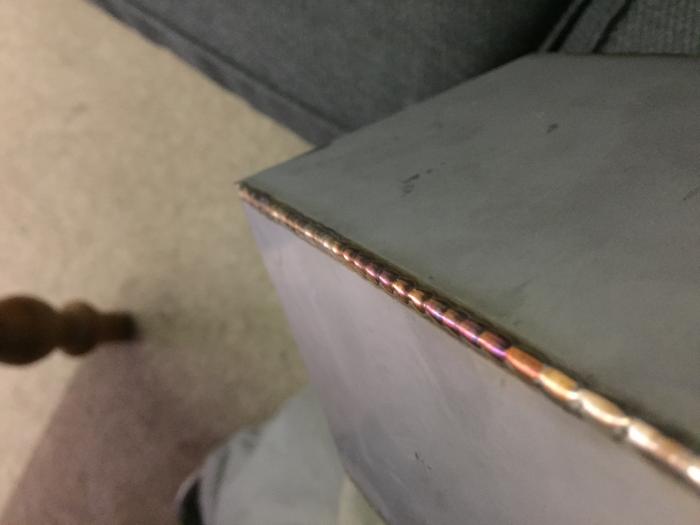

G'day guys
I made up a chiller block similar to the one Jody made from copper, only I used aluminium and milled off the corner. Wasn't planning on it but it worked well as a way to prop the cup on to maintain a constant arc length, which can be a pain on corner joints. Also probably helping trap a bit of argon in it. Ran a few practice runs, pretty happy with the results.
Played around with pulse settings. No sugaring on 1.6mm, the back side nearly looked like it had been purged.

Beautiful nortical!

brad_m wrote:What I tacked up today.
What engine is that? Turbo?
brad_m
    Mon Apr 06, 2015 6:06 am
It's a Toyota 3SGE No turbo. I race an MR2 in a local series.

Bsmith
its great to be able to fabricate
your own stuff.
did it for years racing motorcycles.
nice job.craig

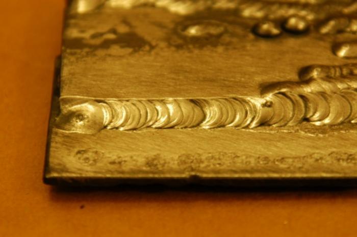

I'm senior citizen learning to weld. I have been practicing running stringer beads, but I promoted myself to lap joints this morning. I ran about 50 inches this morning. I was having a really hard time getting the C (or keyhole) puddle shape. I reread the textbook from the intro welding class I took and adjusted the torch angle. After fiddling with the angles a bit I finally started getting the C (or keyhole) shaped puddle. FWIW: 1/8" mild steel, 3/32" 2% lanthanated tungsten, 130amps DCEN controlled with a foot pedal.
Sadly, this is one of my better beads from this morning.
