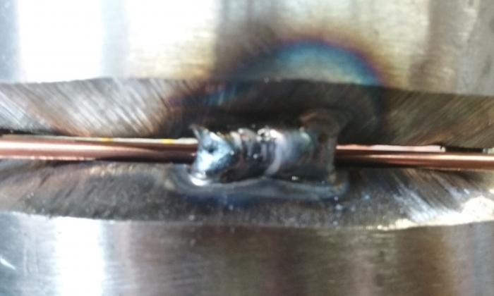

I recon your tacks must be too big ond overheating the surrounding pipe. Don't make them too much more than 1/2" long and keep fill to a minimum. They're meant to be consumed by the root pass.
When I took my tests if you had a tack longer than 1/2in on a 6010 root you would get looked out before you went any farther. If it was tig root then it couldn't exceed 3/8.
That sounds good to me. I don't wanna make em more than 3/8" because they make the coupons a nightmare to move.
I opened my gap up to roughly 5/32" and am about to lay my first root with dip and keyhole.

When I tig a root I leave the bevel at a knife edge and run no gap. I run about 120 amps and use a 3/32 wire with a standard #4 cup. I lay the wire at the bottom of the bevel and I set my tungsten so that as I burry the cup as far as I can it almost touches the top of the wire. I also grind my tacks out as I come to them so that I'm not welding over them on test day.

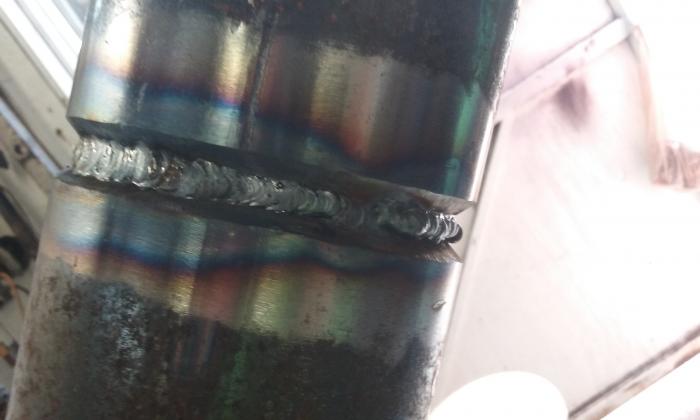

Well, it turned out like Fido. Looks like a newbie did it with a mig. It was way too much gap and I had to dial it back to 90 amps. Ive got better fitup on this next set. The image shows a 3/32" rod sitting in a tight 1/8" gap. It feels like I have about 1/32" of high-low on two opposing sides and flush on the other. Those tacks went in much easier as I got down on one knee. The other set of coupons was a damn sight impossible to fill the gap without putting a ton of metal into the groove. That's some of the worst tig welding that I've ever done.
That first one looks ridiculous so here goes round two.

Try gapping and welding with 3/32" wire. 110amps knife edge and try Jody's forward and backwards method. Don't know anyone using dip keyhole method anymore it's too slow. Most lay the wire in the gap and weave over it which is a good forgiving method where there is an imperfect prep (which is most of the time).
Large gaps can be a challenge even for seasoned pipe welders...luckily I know my fitter well..lol MEColdman wrote:Try gapping and welding with 3/32" wire. 110amps knife edge and try Jody's forward and backwards method. Don't know anyone using dip keyhole method anymore it's too slow. Most lay the wire in the gap and weave over it which is a good forgiving method where there is an imperfect prep (which is most of the time).
Forward back works very well, that video is good.... then stack beads all the way out will till the cover, running the beads is what you need practice on, get use to what you are seeing. As far as feather the tacks, my ASME test would not let me, so tacks are critical, don't stop on top or start on one, weld right through the bitch and keep rockin. Brush really well between passes, let it cool till you can put your hand on the pipe is ideal, buy not needed on carbon. Snip the filler rod before you start back up
Well breaks over, I have some 1-1/2" 316L calling my name
Back and forth just blows holes in the knife edges while sticking the rod ahead of the hole. If I turn the heat down enough to not blow a hole then it really doesn't want to fill the gap. There doesn't seem to be a happy medium. Dip and keyhole definitely isn't working for me either. I can get it to lay somewhat flat but that causes it not to penetrate fully. If I get full penetration then i also get massive buildup in the groove. The only thing that I've tried that even halfway works is to lay the wire in the gap and move steadily forward without moving back. But even that went to hell in the middle of the run and somehow pushed a lot of weld through the joint even hough I had no pressure on the wire.

I still think you are putting too more filler into the root pass. Its meant to fuse the two edges together with penetration. That's all. At 110amps you need to be motoring. Hang around and you will blow through. If you want to slow it down go to 100amps. You should gave enough gas flow for at least 1/4" stick out. I use even more stick out so you can get the tip into the root.
This is the one pass where i layed the wire on the joint and moved forward, not back and forth. It's 1/8 filler on a tight 1/8 gap. The other side was total schmoz so I walked the cup over it and it looks ok from the outside except for whatever trash caused porosity in the middle.
100 amps will blow through with the back and forth, so will 95. 90 is too cold. What the heck.....I just don't know what to do.

I just tried tacking one up at 120 amps and that is way too hot for these little 4" coupons. I peeled back the knife edges of the coupon within 1/4". There's no way that I can weld this thing that hot and that is with me oscillating the torch twice as fast as in any video that I have watched on this subject. This pipe is only about 3/8" thick and it doesn't provide enough quench for that kind of heat. So I turned the heat down to 100 and tried walking the cup on the opposite tack. That almost worked but it was really slow going.....just a bit too cold. Went to 105 and walked the cup on the third tack. Bingo!!!, I found the Baby Bear zone because that was just right. All of this tacking is in position #2 so positions #5 & #6 may require some slight modification but I think that I may have just found the heat zone and technique that are gonna work for me......I hope. I'm getting really tired of grinding because it's aggravating my carpal tunnel.
I have tried enough of these things by now to know that my gap is really gonna shrink by the time I get to the last quarter section of welding. And I know that I'm gonna need to make a wedge to stop that from happening.
Any of you guys have any other techniques or advice to help me prevent shrinkage?
Also, when you just keep welding through a tack do you add any filler on top of the tack or just run it dry til you get to the other side?

The smaller the gap the more amps required. But if you're ending up with a 3/32" gap that's where you want to be right?
