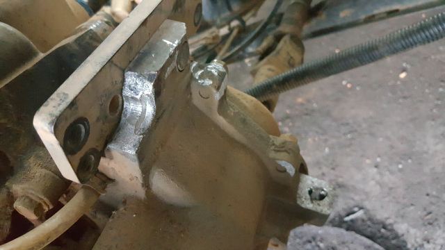

My buddy's 800cc atv broke where the engine mounts to the transmission housing. I keep reading to use 4043 which is good because I have plenty of it on hand but I don't wanna screw this up by using the wrong filler. I have plenty of power on tap at 250 amps and in advanced pulse mode it welds with the equivalent of 310 amps. This stuff is about 1/2" thick so I'm gonna give it some preheat.
I do not have any helium. Were also gonna shore this thing up so that it doesnt have to handle all of the stress on the right side of the machine.
I've got my machine dialed in like this: 250 amps, advanced pulse mode @10 pilulses per second, 50% on time, 100 background current (background is DC in advanced pulse mode for deeper penetration), 30hz for more heat, 40% cleaning action. 1/8" thoriated tungsten, #7 cup with gas lense. This setting instantly puddles about 1/8" deep into aluminum that is 1/4" thick. I am accustomed to welding thick to thin. This scenario is very much like welding thick to thin. I don't think I'll need all that heat but I will know for sure by tomorrow afternoon.
Any advice would be greatly appreciated because I have never welded a casting. Filler selection and weld thickness are what I'm most concerned with because I don't want it to break again.
How much gas flow would be appropriate in this situation? It is my understanding that castings fare better with higher gas flow but I do not know how much is necessary. I typically run with 15cfh on a gas lense for most applications.
Also, how much reinforcement should I add to the weld? This is obviously a high stress part.

If the DC background can be on, without any pulsing, do so.
You'll need max. heat input. Pulsing reduces heat input.
Can and should preheat with the torch, even if separately warming
part up first-which helps. Play the torch up and down the cracked area
to be tacked...to get it close to 'heat', while blowing off internal
contamination-brush that off, then go back for real tacks. You'll want and need to see
slight casting melt--before even thinking about adding filler.
As the heat builds up in the casting, the wetting/fusion becomes easier.
If casting is wholly filthy internally, 'Massive focused heat succeeds where all other methods-fail.'
Even if the filler has to be jammed in below a puddle with lots of floating trash on the top...
..sorta like bump welding anodized.
Running an upwards of 90% unbalanced to get beaucoup heat....if you need to.
Lower the AC freq. is, the more heat, but the arc is much less stiff and vice versa. (Dynasties can compensate
for that, via wave form, independent EN/EP amplitude...maybe your machine can as well.)
Fit and tack both sides, etc. tight up to the break.
Then sequentially carbide groove out bevels in the crack and weld out.
The tight crack, initial fitting/tacking and the bevels for full or close
to full pen welds that actually back groove into the opposite side welded
out for strength.
If that break out is for a dowel pin, you'll need to study the fit, etc. of that, hopefully before
starting the repair. A temporary thru bolt and nut to clamp tight might help.
Before a wrought or cast piece breaks....it bends and distorts....fitting the stretched crack areas
together, doesn't necessarily make a part that 'fits'. Due to this, sometimes part or a lot of the cracked
area is ground/carbide burred away--to get correct broken part placement, relative to the bolting/dowel
pin functions.

It fits pretty good because it was bolted to a backing plate. Three bolts sheared and the one that was left broke the casting instead of shearing. This particular bolt is actually the exact same stud that holds the wheels onto the hub.
It has to be pulse for me to get the deepest penetration. The high side is alternating current while the low side is DC. The DC side is what allows it to penetrate deeper. I have the machine set for 50% on time (AC) at 250 amps and 100% background current (DC). If I nail the peddle with it set up like this the arc is extremely violent and will blow out a small piece of 1/4" aluminum. I have to roll the power on because of that. I can set it as low as 20 hertz. This is the first time that I have tried to crank out maximum power from this machine and it's hard to believe that this little thing has this much force behind it. I can burn completely through a piece of 1/4" aluminum in about ten seconds.
Were going to put the bolts back in and secure it to the mounting plate before tacking so that it doesn't distort.

i think you will be better off building the entire corner back up with weld
    Sat Aug 01, 2015 8:38 am
    The Land Down Under
Kevin_Holbrook wrote:i think you will be better off building the entire corner back up with weld
+1.
I reckon I'd be building up a new corner with weld.
I've had good results with both 5356 and 5183 on cast. I understand that 5183 is meant to be the 'go to' rod for cast, but I am no expert.

sedanman wrote:I think you're a little confused on the science involved. If you are welding on ac, then it's all always ac. The high side of the wave is electrode positive and the low side is electrode negative. The switching is what defines it as alternating current. Pulse would decrease overall heat as this is basically turning the current on and off. On the other hand, lowering the frequency can help with adding heat.
No I am not confused about it. It's the high side of the pulse that's AC. Backend of the pulse is DC negative. You can read about it here:
http://www.everlastgenerators.com/blog/ ... e-part-2-2
Building it up would be Ideal but the stud is a wheel stud and is countersinked because there is no room on the side that the engine sits on. It is a round head that locks into the pocket with spline teeth. If I just built it up then it would have to be machined and I don't have that capability. I'll mention it to him but I'm just trying to give the guy what he is asking for. It looks to me like it broke because someone rolled it backwards.

I weld on a lot of Polaris engine blocks, transmissions and rear ends. For filler I use the 4043 and 4943 these work great on the Polaris stuff. I have been phasing out my 4043 and using more of the 4943. I especially been using 4943 for mounts or areas that need a lot of build up do to 4943 not needing dilution of base metal for strength like the 4043 needs. The AGL can be a pain to clean out of transmissions but acetone does remove it. Here is some links to a repair I put up on forum on a Polaris block repair. I don't use pulse or helium sometimes preheat it depends on part. In the links I give cleaning description I use and what porosity sort of looks like when junk bubbles out of the castings on these.
http://forum.weldingtipsandtricks.com/v ... 799#p66799
http://forum.weldingtipsandtricks.com/v ... 818#p66818
http://forum.weldingtipsandtricks.com/v ... 827#p66827
Good luck. I haven't been on forum in awile
P.s. I would just build up the corner with weld material using 4943 preferably then drill holes after machining it flat. To do the stud you can press the stud in the aluminum on a press or draw it in with a nut to cut splines with the stud. Just have to have the hole the correct size for splines so you dont have a lot of matierial to go threw and use lube so it will press in easy. In can be done just take your time if need be knock it out after it goes in some clean debris out re lube and try again.
Agree 100%...unless you can get full penetration on the break of that tab, it will only break again. Build up a new one.
    Fri May 27, 2016 11:00 am
    Atlanta, GA
OK, the "Aye's" have it for corner buildup.....I'll let him know and also let him read this thread for verification. The hole on the transmission mounting ear has to line up with the engine mounting plate and it has to be countersinked with an end mill because the stud head needs to be flush with the ear on the transmission as well. I'm not competent in that regard so I guess he's gonna have to visit a machine shop.
dirtmidget33 wrote:I especially been using 4943 for mounts or areas that need a lot of build up do to 4943 not needing dilution of base metal for strength like the 4043 needs.
That was my main concern. 4943 it is.....thank you!
