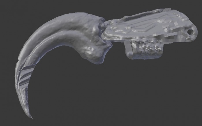

This is my TIG Monster Claw! It's purpose is to aid in feeding rod for TIG welding and I designed it in CAD/Blender and printed it on my 3D Printer. There are 5 total paths to ride on. I think it's perfect for the n00b all the way to the expert but I'm hoping to get feed back on just how well it helps your TIG life. I'm a n00b but we'll see just how quick this might make me an expert :P
This claw really only works on the middle finger which was a bonus convenience. You can use your ring finger but it's not as functional IMO. So let the hand gestures roll and now you've got a legitimate excuse to flip the bird, cuz you're just TIG'in!
I demonstrate the various angles that can be used in this Youtube video and you can see the various rod angles I used in CAD to cut the paths out in some of the thumbnails. I'm in AZ and it was 112 outside so I was sweatin in the video. My first Youtube face video too so why not look "hot"? Judge away...
[youtube]https://youtu.be/xa1KH_aA9d0[/youtube]
The rod paths work perfectly for a 1/8 rod with my large finger scaling for prints I recommend below. There are rod guide paths in each cut that accommodate said 1/8, and then a separate rod path logically aligned that accommodates pretty much any smaller rod you could imagine but hey prove me wrong, and edit the .blend file if you'd like ;)
You can download this thing at:
http://www.thingiverse.com/thing:1682883
The model that can be downloaded is a left handed only model, and must be used on the middle finger unless you want cramps but feel free to experiment! To print a right handed claw, just mirror the image usually on the X axis.
I'm curious for those that have a 3D printer or access to one, if you'd print one or a set and let me know your thoughts. I'm just a n00b and I'm gonna learn with this but I wanna know what some pros, novices, and other n00bs think about my new invention! Be as honest and candid as you'd like :)
TIG Monster Claw with virtual rods to show paths/angles

When I get chance I'll try and print one at school. Did you have any supports or any other things that needed to be modified and which side faced up.
Instagram: @farmwelding
Nick
    Mon Jul 18, 2016 2:07 pm
    Mesa, AZ
You'll want to print it tip up and if you want one for both hands, mirror it on the x axis. For large size glove scale it up 1.08 (1.00 being normal) .
Have only the edge of the finger guard on the plate with the upper portion of the claw supported by supports. This gives a clean finish and just a lil bit of support mess at the very back of the claw which is the least important area.
I did use supports with .05 spacing and 15% filler for the support, 40% for the model itself and 3mm walls.
Thanks for checking it out and I look forward to hearin how it works for you!

What medium are you printing with?
What are the advantages? Would it not just melt? Or am I mental? I'm certainly usually first to ask the dumb questions.
Kym
    Mesa, AZ
There's no such thing as dumb questions especially in the research and development department!
I'm printing with ABS and it has a pretty high melting point. 105 celsius glass, and you usually print it at 230 celsius. It generally remains pretty solid up to about 200 degrees and of course everyone is familiar with ABS since it's what most thing are made out of including your fairings for our bikes so you know what they can handle. P.S. 200 degrees celsius is 392 degrees Fahrenheit and 230c is 446f :)
If I'm not mistaken, TIG torch bodies are made from ABS as well. It's possible it could melt but that's part of the idea to test the design out and see if it holds up. At worst it costs about $1 to make, and about 4 hours of print time if printing two claws.
The reason I'm finding this tool useful is the fact I can let gravity and friction hold the rod in place letting my thumb and/or index finger focus on feeding the rod rather than balancing and feeding. I can also rest the rod on the claw in any of the positions then take my finger off the rod and it will stay with gravity/friction. The youtube video gives a quick demo of this in the beginning and mid way through.
The guide paths also keep the rod straight and consistent, or true as some professions would say. Rather than rely on your fingers to keep it straight which is damn near impossible, this tool does it for you.
This also slips on a glove or can be sewn in permanently. All in all there's quite a few advantages I see to it and plenty more I've forgotten to mention or haven't found I'm sure.
Still this is all my opinion, so stay tuned for some real experts to give their brutally honest opinions!

I applaud your effort and creativity - but I find this to be a gimmic rather than actually helpful.
My reasoning is that when actually welding, rod is fed from so many angles and body positions that this would be a hinderance.
It likely would work fine for welding practice coupons, but the time would be better spent learning to feed rod.
In my opinion.

RICK_H, I'm in AZ but if you don't find someone then I might just print up a batch and work on getting a set to you.
MinnesotaDave, Appreciate the input! The gimmick part, maybe but it's free and gimmicks usually apply to something you've gotta spend money on ;) I'm able to feed at any angle with the 5 different guide paths using this very comfortably so I'd be interested in seeing a position this couldn't take care of but I know it's not going to fix every situation. P.S. I resist anything that goes against my practice too.
The most important thing here is it's one tool, and just like every tool I hope you have in your tool box, has a fairly specific purpose unless you're half ass'in it like the guy that uses a flat head for a pry bar or chisel. The bonus to the claw is you spend less effort trying to hold the rod from that "any angle" position which gives you more effort to apply at feeding the rod. It helps me stabilize in and feed it more straight in those awkward positions too.
Again I'm a n00b with no true TIG skill set here, just an engineering background with a lot of random experience and all sorts of tools to get damn near any job done. It's fun trying to find functional purposes for my 3D printer too.
I'm still leaving it to the experienced like you to give the real down n dirty! If I'm lucky, one of you brave souls will print these damn things out and give me a real opinion too. If you live in the Phoenix, AZ area I'd be willing to make a set and give em to you if only for the sake of curiosity :)
In the mean time I figured I'd add some useful pix to give a better idea as to how it works and for better criticism. Bonus for Jody, I'm using his TIG finger to also demonstrate the lack of concern I have for it melting. If it did, ABS peels clean off any metal and I'd rather it be ABS than my glove!
