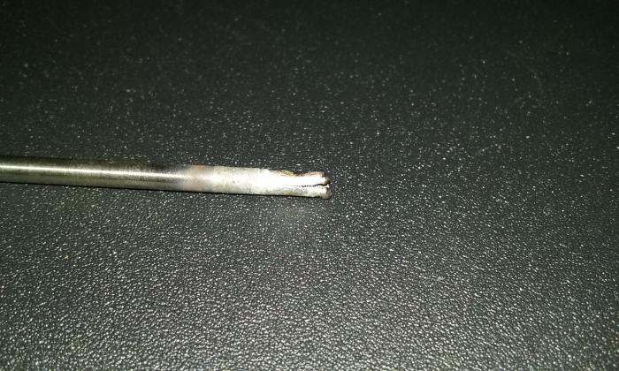

Today I split a 1/8" thoriated on aluminum at 170 amps. Screw that. Switched to 3/32" lanthanated and cranked it up to 200 amps shortly thereafter. The smaller lanthanated performed far better than the larger thoriated. I've read about them splitting but have never seen it until today. The old boss used them exclusively but he has a square wave transformer Lincoln and I have an inverter Everlast. Go figure.

I have never split an electrode. 200 amps is pushing it for a 3/32" tungsten. I only weld thin stuff so I usually use 3/32" for everything thick and thin. I have welded over 200 amps and it has held up. I have also sharpened it to a long fine point and welded razor blades with them at 20amps. I don't have "tig collector/hoarding mania" and need to have everything in the LWS in my goody box so I just stay with what works or I make it work.RamboBaby wrote:I usually get a ring around the electrode, within 1/32" from the point or a flattened tip with dc. I think sometimes it has to do with not using enough gas flow during the weld and also not enough post flow time.
The only reason that I have thoriated is because the LWS wouldn't sell single sticks of lanthanated. I thought the 1/8" would do a better job than 3/32" regardless of variety.
3/32" lanthanated has no problem welding at 225 amps, at least for a few minutes. I know first hand from doing it several times. It sure as heck did a much better job than it's larger cousin.

Did you split that on AC/aluminum? Let me ask you this...do you snap off your tungsten when you dip and re-grind? Sometimes you get a crack when you snap 'em off like that. I never dip so I wouldn't know
