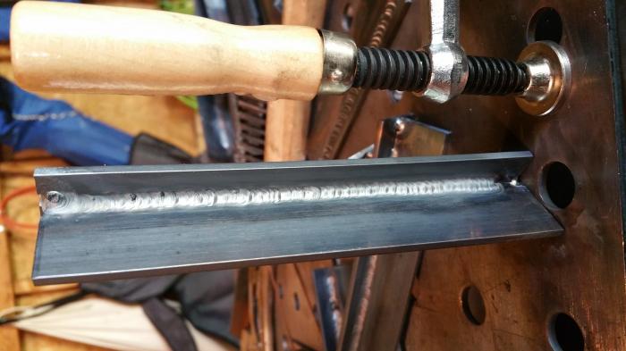

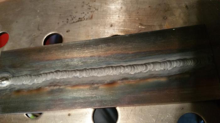

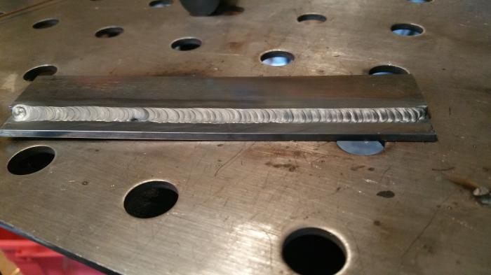

so i just started tig welding about 3 days ago on CRS 1/8x1x6" i use 135 or so amps, feathering the pedal between 100_120
here are the results, any tips?
the pictures are in order of which i welded.
(i did more than these, but i dont want to post 50 pictures :P)
alot of pictures, but i had a few questions. it seems better to dip without stopping, but it looks better when you stop and dip so i assume it is better to get use to dip without pausing with the torch, its what im practicing now. also, does it matter how often you dip, other than the looks of it, looks better when you dip less, so should i dip less when i weld? the second to last one was dipping mid-often and the last one which looks better IMO is dipped less. and i find it easier to pace myself to make look even when i dip less i.e 1-.5 dips a second instead of 2-3. so is it ok to dip less?
last thing: when i feed the wire, i kind of 'lean' the wire on the metal to feed in the puddle, is this ok? i find it better than holding it in midair because when i held it in mid air, i would contaminate the tungsten when i would go to feed the wire when i ran low.
thanks for your help, i really appreciate it.
regards noah.

sorry for the 2 black pictures, i have no idea how to fix it. but all it was is a T joint where i dipped more often than the last picture, here is a similar one,but not as good:
    Thu Dec 25, 2014 9:25 am
    near Chicago
Good job. You have the moves down but a couple of your pics show smoked metal. You gotta move along and never linger or you smoke your base metal. A few look MUCH better color. You got it brother...a little more seat time and you're there.

exnailpounder wrote:Good job. You have the moves down but a couple of your pics show smoked metal. You gotta move along and never linger or you smoke your base metal. A few look MUCH better color. You got it brother...a little more seat time and you're there.
which one looks smoked? the butt joins looks like it now that you mention it, any other?
could it be because the tungsten was contaminated? or was it because i was moving too slow?
and does the frequency of which i dip matter? or is it mostly for looks?

It's not really the frequency per say, but it all has to do with the bead profile. You definitely don't want a concave bead. You don't want too much convexity either. Both compromise the strength of the weld. You want a little bit of convexity with a nice, smooth tie-in at the toes of the weld.

Consistency isn't too bad - several toe areas did not wet out (tie in) to base metal - looks like not enough amps.
Stay 125 or above on 1/8" and motor out - faster travel with more amps puts less total heat into the piece.
It's a balance, you'll nail it eventually :)

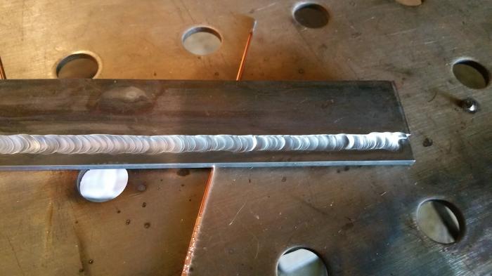

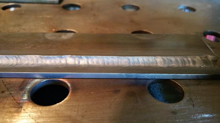

Update to the previous post: tried setting it at 125 and flooring the pedal to make 100% sure I was doing actually 125, and I got a similar bead to the last picture just looks shinier (the tungsten was probably contaminated on the last bead is my guess)
Here it is:
The last one is the side view of the bead, only way it would focus is if I put a piece of metal on it and put my phone sideways, sorry for the weird angle.
There a bump on the last one because I didn't have time to taper of, I was burning my hand :lol:
I gave vertical a shot, didn't go aswell as flat, any tips? Same settings as flat, feathering the pedal 1/16 wire.
I contaminated the tungsten mid weld on this one

Very good! Better than I have seen from guys around here who claim to be pro's and "have 30 years of experience"
No smoked metal this time and your stack a dimes in just about there. You are now a Tig welder 8-)

Nice looking beads! You are definitely getting there. But, things will be better if you get the mill scale off before you weld. Makes for a much cleaner weld. I know it's not critical for practice-but try to develop good habits to start with. Hope this helps.

its cold rolled, not hot rolled, :|
i clean it with acetone 8-)

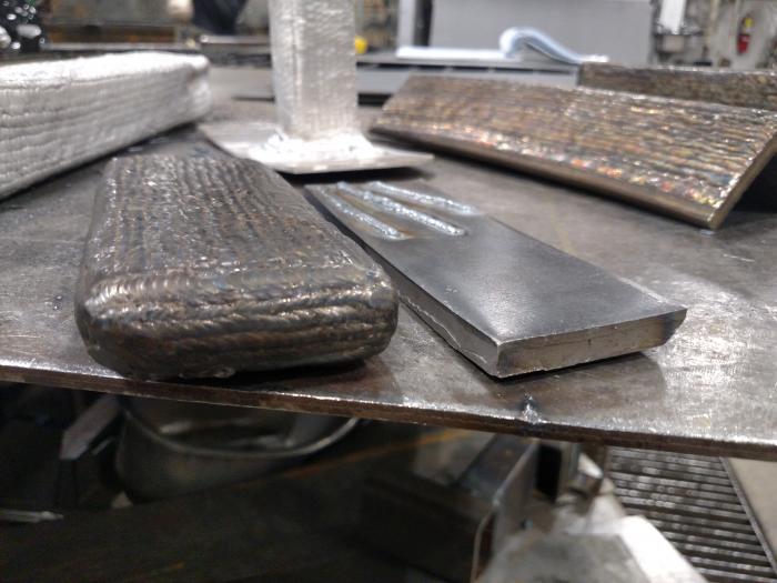

What I did in school...I started running beads just like Jody always says. I took a chunk of steel, maybe 3/8"x3"x8", and covered it with weld beads. When I got to the edge of the metal, I just turned it on it's side and welded the edge, then across the back. I joked that I was going to make it into a 2x4 block. (Oh yeah, I dunked it in water every so often to keep it cool.)
The photo shows a comparison between the block I started with and what I ended up with. And there is some junk in the background, because I started doing the same process with aluminum and stainless. Stainless doesn't cooperate with this kind of abuse, btw...but aluminum was great. Only problem with aluminum was that I was using a Dynasty 200 dx, and that 200A wasn't quite enough after several layers of weld. So I grabbed another chunk of aluminum tube.
I know it is ridiculous...but it was good practice.
