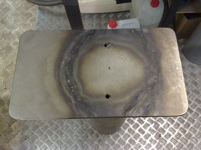

Teaching myself to tigweld, Cody's videos are of great value to me.
Unfortunately I didn't learn, what I was taught :-(
I'm making a stand for my tabledrill, welding a 10"x13"x 5/4" plate of mild steel to a 9" pipe with a 1/4" wall thickness
I got too excited and kept on welding, instead of backtracing and changing spots, and the plate got too hot and warped.
Kicking myself doesn't seem to help, so I've decided to try and reheat it on the other side. I intend to use a gas torch with a narrow flame on the opposite side of the weld. I was hoping someone could give me a pointer as to how hot I should make it. I do have an infrared thermo reader, or I can use a redhot scale.

On the topic of flame straightening. It can be very tricky depending on what your straightening, and you can find yourself making things worse if not very careful.
Using a narrow flame on the opposite side is the right start, But where exactly to heat the metal and how much is the key. I need to know how thick the plate is and how much it pulled up on ya.

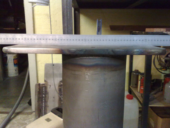

Measured 5" from the weld the gap under my ruler is 1/8"

Then the plate is a hair over 9/16" thick. I have worked in a few fab shops that had drawings in nothing but mm, so I had to learn quick.
Never heard of steel plate described as 5/4" before though. Only decking lumber. Anyways, It is good that the plate is that thick. It will make it a little easier on you.
On the back side of the plate opposite to the side that was welded, you want to heat on the outermost edge of where the weld is and heat just until it turns yellow. Do that all the way around. DON'T over do it on the heat because you will pull it too much. You just want to get the surface of the plate yellow. Don't go too deep down into the plate. After that, let it completely cool to see whether it was enough. If not, then you will have to go a little deeper down into the plate with the yellow. After heating, always let it completely cool to see how much it moved.
What you are actually doing is shrinking the metal on the opposite side of the weld which will pull it back, but be careful. It's not hard to make things worse real fast.
Also, you may just have to get it close and then try to possibly pound it the rest of the way flat with a hammer. Hope that helps. :)

DONE! :D
Thanks to Hotrodders tip in a UK forum I found the knowledge and the courage to do what I intended to in the first place.
I used O/A to heat the plate on the opposite side of the welding, using a very narrow flame and trying not to melt the iron (for appearances sake). Discolouration is easier to grind away than melted scars.
I then left it to cool and were pleased that it had helped. I did several turns, and eventually the plate was almost flat again.
Here are some pictures to illustrate the task.
