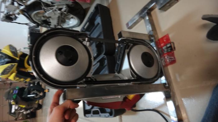

60A plasma cutter set at 50A using a 1.1mm nozzle seems WAY too much for 1/8 and 1/16 steel! I swear this cut faster than I could cut butter (without a really hot knife). First time I finally got to play with it since it's my first day I can wear boots again :) I'm getting a set of .8mm tips for 20-30A which should help out...
Got the base and up-rights for my bandsaw done with one of the cross members to hold the bandsaw in place. Got three braces to go and then it will at least stay in place on it's own.

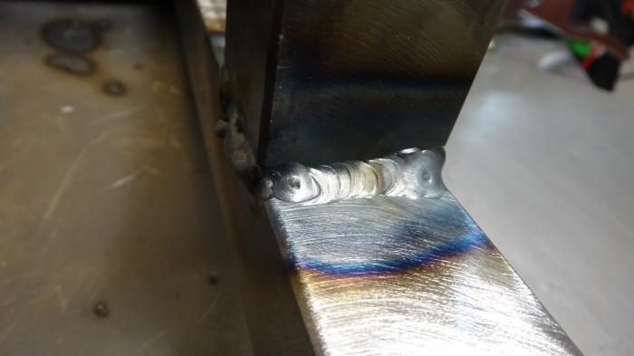

Found out a torch switch does wonders for tack welds but so does a gapless point to tack at.
Got to learn a bit about warpage on the uprights too but it wasn't anything several wacks with a 1lb shorty sledge couldn't fix! The sledge confirmed my welds are true welds too since they didn't budge and a good sanding of the bottoms to smooth out the welds I did there showed I had full penetration. SCORE!

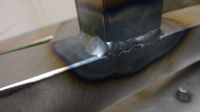

Learned that when I have a T fitting, heating the horizontal plane starting the puddle there and angling the torch up into the upright to bleed the puddle in with a dab of filler once it did puddle was my best chance at not blowing a hole through but had no issues with a butt joint in the same configuration so I could just run a straight horizontal bead n filler.
It's coming along nicely and I'm finally usin all dem skillz I've lernded!

Look at you go. I remember when practise had been all I'd done, it felt so good to actually be making something useful. First thing I made was a race stand for one of my bikes. I look at it these days and laugh at the standard of my welding but it is still strong, used every day and a great reminder of how far I've come.
One tip - Jody has a great video somewhere that details the sequence of joint welding that should be used to control weld 'pull' and warpage. Done right, everything remains almost 100% square. Do some searching, it's well worth a look.
As always, great to see you enthusiastically working away.
