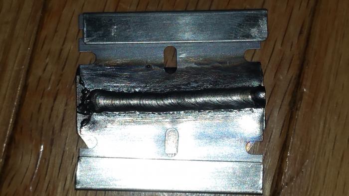

maker of things wrote:OK, Ifeel like this is a little bit of a cheat. I used pulse, so it's not all man, the machine did kick in some effort here, but I was able to use .035 mig wire on both kinds of razor blades. I do think the fixed #9 gold shade helped. I also basically used laywire technique and lit off with the wire on top of the blades at the start. So while I don't feel it's 100% in the spirit of this challenge, it was an excellent demonstration of how good pulse can be on thin material. Need to get some smaller filler so I can try these again for real.
Maker, to an extent I disagree with you, using pulse is using a tool you have to complete the weld, no different then using clamps or any other tool.
I understand the reason you brought this up, but when it comes to thin material you need a new set of tools, perhaps pulse is one of them.
Now damnit where are my blades? Looks like I have to buy some!

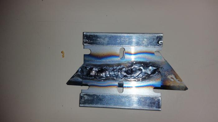

This is the best one I have. I have been through a lot of blades practicing. I used 3/32 2% lanth at 20 amps with 3/32 filler. Clamped blades down to a copper bar. Lit up on the copper and then moved to the blades after the arc stabilized. Also had to keep the filler rod in the arc when arc got close to the blades to keep from melting the tips away. I used a stainless filler. I spent several hours in the garage trying this after watching Jodys video.

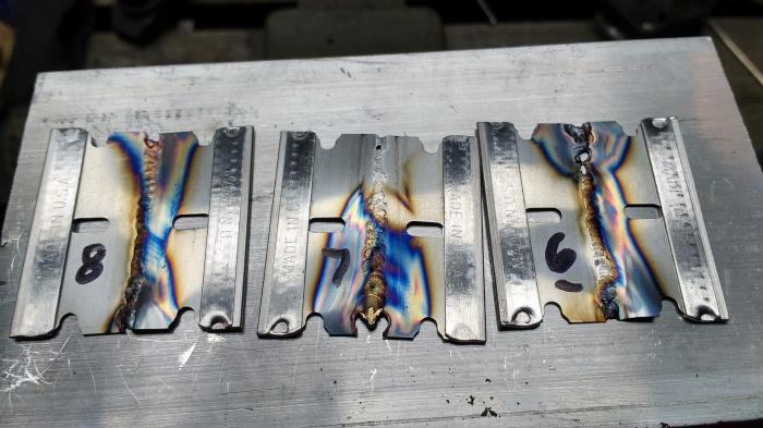

Here's my humble second effort at this - finally using clean blades! Fusion welding, 5 amps to start and then up to around 14 amps using the pedal. Very sharp 1.6mm, 2% Lanthanated electrode.
Have to admit what I'm finding most challenging is fixing the blades in such a way that they won't move, (they obviously moved in this weld) but most of all...finding a helmet setting so that I can see properly! Arc is tiny and I find that at the low settings my helmet is 'switching' in and out. 90% of the challenge for me seems to be finding helmet settings that let me see what I'm doing.

Kym, Turn the delay setting to maximum. This should help with the flickering . I have to work on pop cans for the next challenge

Sedanman, my hood is cranked to maximum delay but still flickering now and then. Maybe I've reached the limits of what this helmet is capable of, who knows. Probably won't trade up to a bigger $$ hood just so I can weld razor blades!
(But then again).
Irony...I'd been welding with used blades and getting bad results. Ordered a big pack of new blades onlines. They arrived, and to my horror I find that the package is swimming in machine oil! So, very careful acetone cleaning before welding. Sheesh.
Love this challenge though. Makes me want to keep trying until I nail a really good weld.
Kym
    Tue Jul 19, 2016 6:52 am

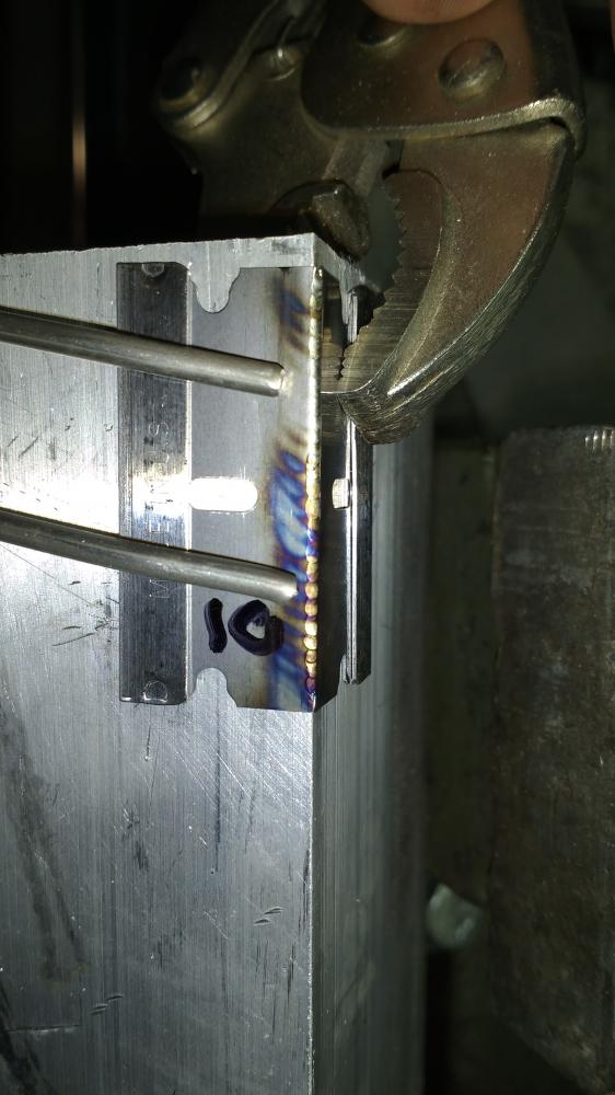

5 amps is pretty low for an autodarkening hood. Wouldn't be too hard to bock even a portion of the light and cause the hood to undarken. I think a fixed 8 shade gold lens would be ideal. My 9 wasn't bad but a little tricky to see through before arc start. I don't think it showed well in the pic but I ended up making a hold down fork from 3/32 stainless and used one clamp on the end where it is bent 180. That applied light pressure that holds the blades down but they could still be aligned after clamping.
