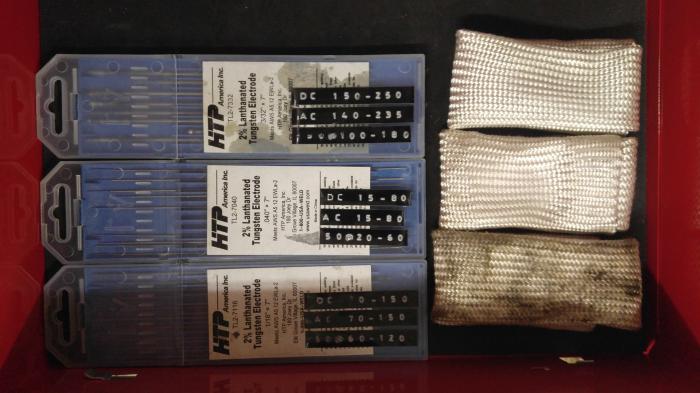

2% Lanthanated holds up a lot better on A.C. anyway and takes longer for it ball up even under a high positive balance. It works great for everything else too but I do use 2% Thoriated for a lot of things especially 4130. That's my choice, personally I believe the Thoriated scare is overrated. Unless you ingest large amounts your gonna recieve higher doses of radiation from your day to day environment or from medical test. If you have 2% Thoriated that you would like disposed of I will gladly get rid of it for you.
If you go for Lanthanated make sure to get 2% holds up lot better than 1 or 1.5% lot of LWS do not have it and counter guys never heard of it. I believe Jody selling it, I get mine from USA weld they have great prices on it.
Amp ratings labels I added for quick reference.
