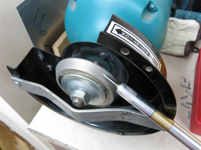

I've made a few sharpeners, dremel based, little grinder. All were kind of OK, kind of not.
Eventually I found a drill sharpening stone. This is a diamond wheel, well actually CBN. The diamonds are on the back for a few mm as well. The wheel is so smooth that you can touch it with no skin lost. The alignment turned out to be perfect, no shims or eccentric washers. I use the 45 deg face against the rest to get the basic shape (yes I know), and then clean up using the front or back flat. Despite the very fine diamond grit the grinder is able to remove enormous amounts of Tungsten.
The Makita bench grinder has tons of power, and after 9 months daily use the wheel has no observable wear.
The wheel came from here, which isn't going to help anyone, but the type will be available.

That wheel looks good. Need to check that out. Thanks.
