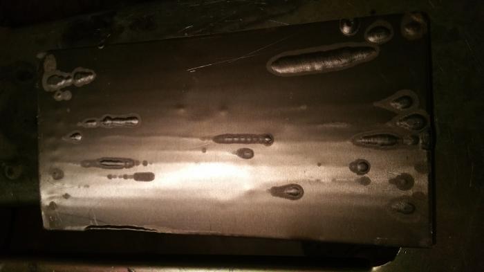

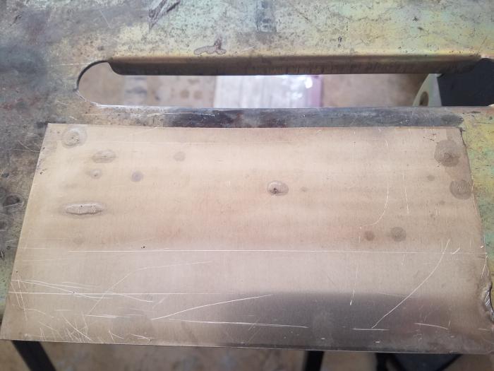

Hello folks I'm Charlie..I work in the oil field and have been wanting to get into welding as a career later on..so I went out and bought a miller 252 ..of course a tig machine is next..so I bought a Lincoln squarewave 200..anyway I've been welding GMAW and SMAW for about 4 months and dove into tig..these are my first attempts ..these are without filler rod just getting muscle memory to get straight beads and such..just wanted to introduce myself as I've been lurking for a while. .Edit: I know crappy but gotta start somewhere..1/8 cold rolled..quenched in between runs so it rusted a tad but I had cleaned it..running 125 amps.
- 20160902_185451.jpg (50.08 KiB) Viewed 2951 times
dirtmidget33
- dirtmidget33
Welcome, no such thing as a crappy practice weld. The whole purpose is to practice and learn which means each weld you learn a little more what to improve on.
- entity-unknown
Location:Mesa, AZ
Hey Charlie!
We've got the same table with the bad grounding burns from not clamping your part and all
Can't resist posting now!
I'm gonna take a crack at this but I think the mongers will tell you that you're running too cold. If you're running a pedal, crank it up to about 180-200A without riding all the way to the floor except maybe to start and if you're running a switch maybe 130-150A. The one thing you have really going for you is your profile and consistency in width.
Wire wheel that piece up really good and shiny and then start running some more. Don't forget with TIG, clean, Clean, CLEAN! If you let it cool by air you'll almost never need to clean once you get things good.
Scotch brite that filler lightly too!
Personally I think you might just progress faster than I did
You might want to post your tungsten type, size, and whether or not you're using a gas lens. If you don't have a gas lens, get one. It'll last you a long time and as you contaminate the screen in the lens from n00bin', just wire brush it off and you'll be good if you can blow a heavy flow of air through the back side.
You might even post a pic of the front of your machine since that means you won't have to type out some of your settings
Good job and better advice will come along!

WELCOME Charlie. On 1/8 without filler or even with it 120-130 is going to be pretty close. Looks like you are keeping things straight. Try some lap joints that way even without filler you can get a feel for how things melt togeather.

Thanks folks for the reply..I apologize for the lack of info..I'm using 3/32 2% lanthenated, 125 amps, I have a stubby gas kit on it with a #8, stick out is about 3/8 of an inch about 20cfh of flow on 100% argon..heck I thought I was running kind of hot but thanks!..as some of the tips I've saw I'm flooring the pedal forming a puddle..letting off a bit as I move about an 1/8th inch over and feathering the pedal to widen the puddle..and so on..I won't bore you guys with asking since there is so much info on this site and many others..but I'm all ears if you do..thanks again..also I built a cart almost based on Jodies first cart welded in GMAW that I'll be posting up..thanks!

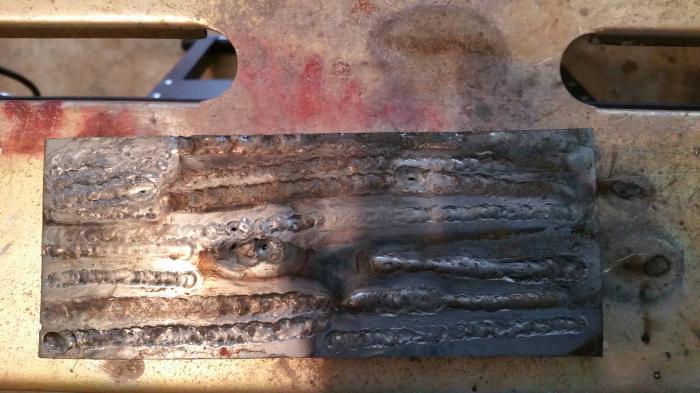

Again I appreciate the help everyone I'm sure you get tired of us newbies, but yours and Jodies help and information is invaluable to us..these are some beads I ran today practicing..sometimes it's hard getting in practice if it isn't your job but I'm trying to get in all I can..this time it's on some 1/4 hot rolled so I could get a little more hood time..running about 185 amps probably with the pedal 160 or so maybe..3/32 er70s2 and a 3/32 2% lanthenated ..I attached pics of front and back..thanks again.
- 20160906_182210.jpg (49.39 KiB) Viewed 2522 times
- 20160906_182220.jpg (51.92 KiB) Viewed 2522 times
- 20160906_181538.jpg (49.43 KiB) Viewed 2522 times
- entity-unknown
Location:Mesa, AZ
Well hot damn! THAT is a wonderful progression
You're on point and where you need to be from this n00b's view. I'm very curious as to what our experts here have to say about where you're at now...
Lincoln Electric AC225
Everlast W300 WaterCooler
Optrel e684x1
Optrel e684x1
Looking pretty good, Id suggest moving the torch less or not as far inbetween dabs, or dab quicker (what ever works for you), progression is very good. Practice makes perfect...
Wow! That is good! As Rick said move a little less and you don't want those titties at the end of your welds. Let the power down slowly and circle the arc to flatten those out. You don't want a crater either so maybe an extra dab of filler before you circle the arc. Other than that WOW!

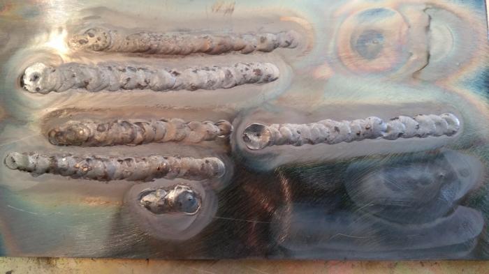

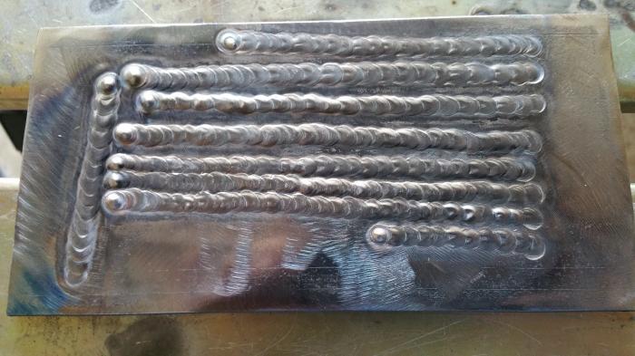

Well after 3 weeks I finally got home from work and engagements to practice a little tig..after 3 weeks as soon as I lit up it felt awkward..oh what a little time it takes...I felt I did a lot better on heat control on the edges..2% 3/32 lanthenated, 3/32 4043, 1/8th" aluminum set to 150 volts about 3/4 pedal to maintain or sometimes less...back side is shown also..a little cold you guys think? I'm running about 65% En and 90 on the frequency..now maybe to get a little mig time to not get in a lull with it...I just got off lay off so I've been working extra to make a hand..hope everyone is well
- 20161014_162958.jpg (41.91 KiB) Viewed 2415 times
- 20161014_161740.jpg (58.36 KiB) Viewed 2415 times
Is your plate dirty? It looks like you wire brushed it but it also looks like it is still dirty. Any contamination in aluminum will cause problems with your welds. Hard to tell from the pics. Welding dirty/contaminated aluminum is a hard road uphill just like trying to weld through millscale on mild. Aluminum is like a sponge for crud. Again, hard to tell from the pics.
Charlie337
- Charlie337
Joined:Fri Sep 02, 2016 8:07 pm
Yeah I wire brushed and wiped it down with some acetone it's 5052 if that helps any maybe I need to be more liberal with the acetone..but I did not clean it after the weld and it was on a freshly ground electrode part of the way..I did notice a lot of scum in the puddle at the beginning of the Weld puddle forming..I was just happy I didn't dip the electrode or maybe at least I thought I didnt..I notice the puddle wanting to swim and chase me down some times and I backed it off and it got better thEn the rod wanted to ball up so I had to increase a bit..felt like I was chasing it or it was chasing me at times.
Where is your metal from? Was it outside or in a scrap pile? Those dark stains indicate contamination. You should be using the best you can get. Wire brushing will break up the oxide layer but does nothing for porous contamination. Acetone will only remove surface oils so be aware that if your metal has absorbed anything, you are going to have a tough time welding. The chasing you describe could be several things. Too long of an arc will throw in more heat and flatten your puddle as will standing on the pedal. You're not doing too bad. Just remember, you have to be doing everything right on aluminum or it will let you know right quick when you don't and you can't ever get your metal too clean for tig work. Metal prep is VERY important.
Charlie337
- Charlie337
I appreciate your help along the way...yeah the aluminum came from a supply house near me I need to do a better job of cleaning it for sure..thanks again for the feedback .

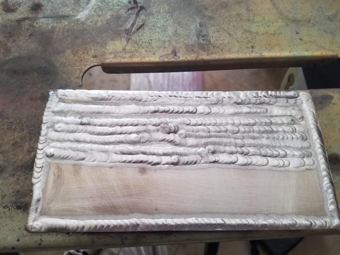

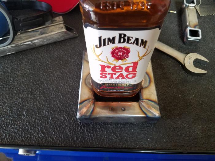

So I was toying around with the booze bottle cage idea for a Christmas present idea for my brother...had just got home from work after a month of not being home and first time messing with silicon bronze..was just trying to add my own little touch and trying different positions..fit up wasn't the best..45s were free handed with a swag offroad stand and portable band saw..running DC, 90 amps 3/32 lanthenated, 3/32 filler about 15 cfh of argon..somewhat cleaned up hot rolled..
- 20161223_153332.jpg (61.97 KiB) Viewed 2273 times
- 20161223_161127.jpg (42.5 KiB) Viewed 2273 times
