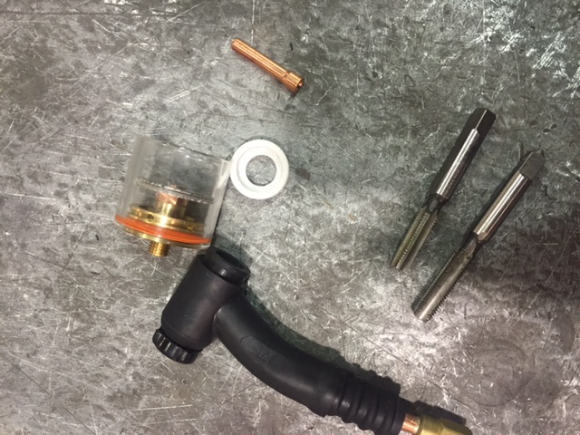

Before I start I know Jodi sells the FUPA no 12 kits in the store with an adaptor for a 17/26, however being in Australia the cost of getting one here with our dollar and shipping I just could not justify the cost vs how much I would use it.
I know he also stocks CK stuff I found out after this little project they do a no.12 straight to 17/26. Maybe he can look at stocking them over in USA land for you guys if there is enough interest.
He is pretty thrifty at making things work so i'm sure he won't mind.
Anyway, happened to go past the LWS on my way home yesterday and saw a CK kit for a good price, and couldn't resist any more. problem is it was 5/16 24 thread instead of whatever the bigger thread in the 17 I have. So i figured I would make it work somehow and here's what I came up with, pretty straightforward really.
Not sure what insulator that is but I have heaps not doing anything, also need a 6.9mm drill, 5/16 UNF tap and a normal collet body.

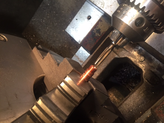

Drill to 6.9....
Tap it 20mm or so...
And part it off at a length of 10mm. This is kinda important as you need the thread not to bottom out before the insulator and cup go tight and the right length for the collet to go tight with the back cap in roughly the right spot. 10mm seemed perfect.
Bit of high temp loctight so the piece doesn't end up in the torch
Hey presto, all done.
I leak tested the insulator to cup connection with some soapy water and even with it a turn or two loose, no leaks. Looking forward to using this bad boy. Will post some results.....Anyone use one? What gas rate are you using? I was thinking 20cfh/10lpm under normal circumstances.

Nice but l wonder if the torch temperature exceeds the release temperature of the loctite.

It may do but the worst thing that could happen is my reducer gets stuck in the torch and I have to use plyers to get it out. I think these are 120amps max and not meant to be used on A/C. Given that I will be on 70max welding delicate stuff and taking my time with the torch a fair way from the arc I don't think it will get hot at all...time will tell.

Did a search and rubber melts at about 180c ..not sure if torches are a special kind of material but that loctite at 230c should be right....over thinking it now!
