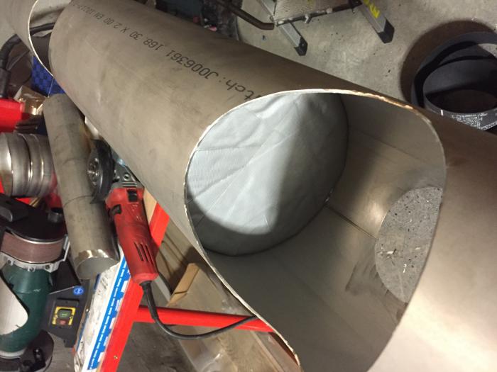

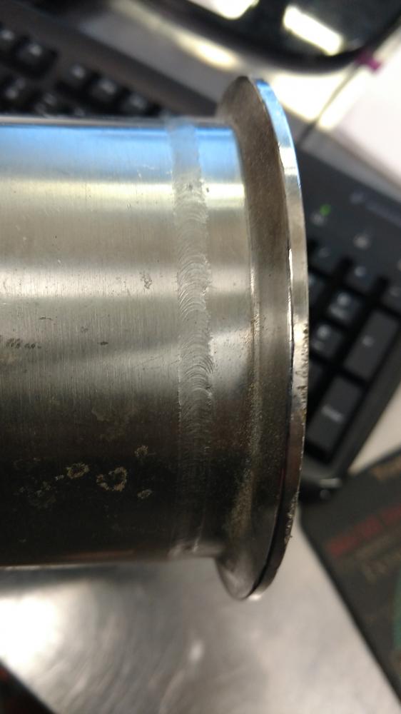

Your in luck I'm repairing a 4" pipe right now...316L stainless, sanitary for food processing.
I typically do not walk the cup under 4" in diameter, unless specified. If the inside needs to be smooth and free of "sugaring" you need to back purge stainless with Argon or Nitrogen to shield the weld. If the weld requires a fillet weld, it is still done with a back purge and I typically use a 3/32"-1/8" filler, height 1/8" or under respectively unless specified.
- Inside
- IMG_20160922_170103538.jpg (49.84 KiB) Viewed 1700 times
- Outside
- IMG_20160922_170114165.jpg (45.95 KiB) Viewed 1700 times
