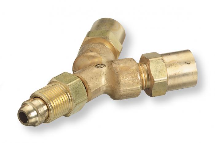

Here is a solution some use, get a "Y" connection to bring the argon and helium into the gas line and use the flow meter to adjust the proportion of each gas. There're available with or without valves.

I've mixed argon and helium many times, and don't use any of that fancy stuff. I have pressure-matched flowmeters on each bottle (meaning each have the same downstream set pressure, 60 PSI for example, and simply meet them with a tee before the machine. The regulators assure no back-mixing between bottles (Nothing measurable is moving from the 60 psi environment into a 2300 psi bottle), the tee makes for turbulence at the mix point so it mixes even better than a fancy wye, and it's cheap and simple.
FYI, an argon flowmeter will be WAY off for reading helium. 10 CFH of helium will "just" lift and steady the ball of an argon flowmeter. Consider this when attempting to control your mix. 10 CHF of argon and a "just floating" ball on the helium side is about 50/50 at 20 CFH.

That kit will do everything I did, and it's "plug and play". The separate torch flowmeter is a nice touch, too. I like that the ad emphasizes that mixing ratios are only approximate with this method, and that more precise systems are available.Rcc wrote:thinking about doing the same thing if you can post up what you finally did it would be great.

I use argon helium mix all the time and just run Y with valves, I'm sure the killer mixers are nice but, I've never had a problem with ratio. To explain I mean I never see waving colors in arc so I assume its mixing at some constant rate, and if I need more I just add or take out. And Ive emptied multiple bottles and never had gas/bottle contamination. Ive just guessed that between high bottle pressure, and a flowmeter, its all going one way at just 25 cfh range. Id imagine even when a bottle runs out its more pressure till 1 second before it dies, then your outta gas anyway!

I suspect a gas lens also helps mix the 2 gases. I have been doing this exactly as was explained. I just barely get the helium regulator ball to lift and judging from the results it seems to be a good cheap solution.

can the (helium/argon mix set up) be made with the two cylinders and mixer(Or Wye fitting) only, and /or can it be done by just getting both gases mixed in the same cylinder from LWS? and which would be a good combination of percentages to be used with a miller dynasty and which method do you think will work the best?
You can do it either way. Premixed tanks have a benefit of being east to use, save space, only one tank instead of two. The mixing valve method can take a little bit to dial in but gives you flexibility to change the mix ratio. They make mixing valve stations that make getting precise mix ratios easy. But the y or tee fitting will work. Best results would be to make sure both regulators are set for the same pressure and that they both have ball type flow indicators. You can also install check valves in each line before the tee to minimize possible back pressure issues.
