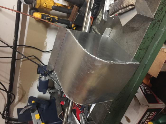

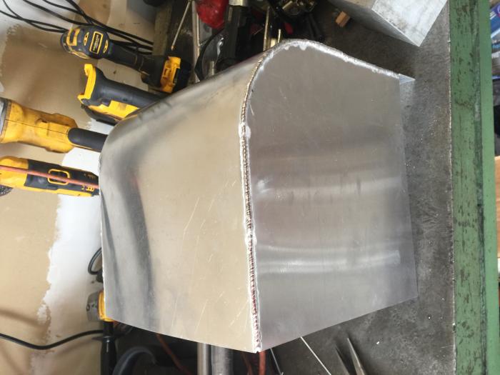

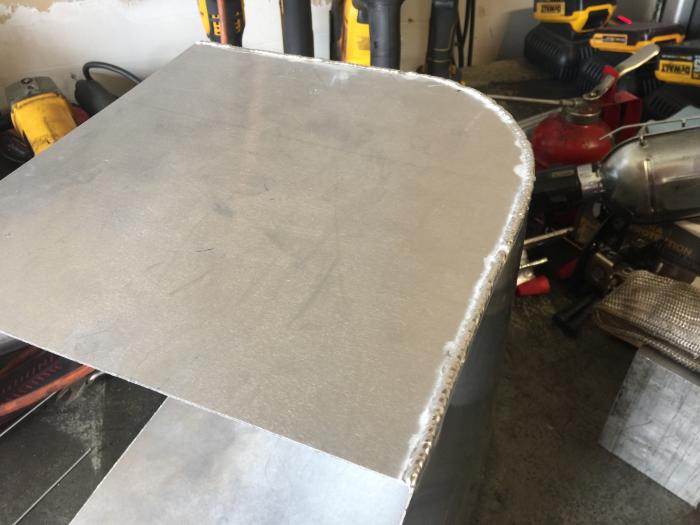

Hi I make aluminium boxes out 40thou 6061 sheet of course I use 1'' x 1'' angle with a 1mm wall to frame the box then its easy to weld the edges together butt weld backed by the angle. Is there any reason you could not have even a 3/8 strip behind the joint tack this on first and then you would get a nice strong joint. I use pulse and a 3/32 filler rod as when you dip it really cools the pool. On the out side you could sit Aluminium or copper chill bars as heat sinks. Really this is an easy job if you have the right equipment. If you absolutely cannot have even a 40thou flat rib on the back just have some one hold a piece or clamp a piece of 1mm copper to the back of the joint and it will weld nicely. You need a tack at least every inch and let it cool. Do not try and run long beads but short stitches maybe 3 inches apart bottom, top, middle, then come back and fill in between. It's just all about sinking away the heat and spreading out the heat as you weld. There is actually a welding formula for this you can look up. Trying to do it with nothing at the back is making things very hard for yourself. Hope this helps. Regards Bert
Got it done! Not perfect but more than good enough relative to what I was hoping for. Thanks for all the suggestions guys! Made the curve radius shorter so I had a good long straight chunk to use a chill block on to get started.
- IMG_4509.JPG (37.3 KiB) Viewed 1214 times

Thanks Richard! I settled at 120hz, 150pps, 30% on, 8%bg, tri wave, 1/16 5356. Torch is a flex currently in 9 configuration, 3/32 2%lanth with a 45 or more blunt taper and a gas lens at 13cfh. I had peak amps set at 120 but I'd only use full jam when I was starting a puddle while pushing a section of the curve down onto that big aluminum block.
Ready to mount. Pretty proud of it, first non-racing related project!
- IMG_4515.JPG (50.1 KiB) Viewed 1201 times
