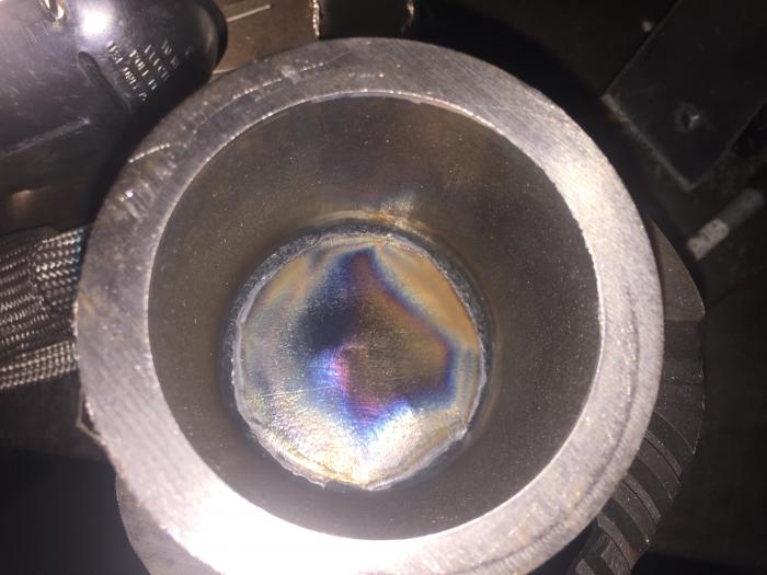

Hey for the 3.5" pieces, I'm going to cap one end with 3/8 plate and it will also be load bearing. I'm torn on how to cut the cap. The tube sections are 3.5" OD with 3/8 wall so 2.75 ID. Should I cut the cap to 2.75 and fill in the 90 degree cutout, or cut the cap to 3.5" and bevel it down to 2.75, and bevel the top of the tube (don't know if I'm describing it right, so the joint looks like either a top hat vs hourglass).

Hey for the 3.5" pieces, I'm going to cap one end with 3/8 plate and it will also be load bearing. I'm torn on how to cut the cap. The tube sections are 3.5" OD with 3/8 wall so 2.75 ID. Should I cut the cap to 2.75 and fill in the 90 degree cutout, or cut the cap to 3.5" and bevel it down to 2.75, and bevel the top of the tube (don't know if I'm describing it right, so the joint looks like either a top hat vs hourglass).[/quote]
This might not be the best description, but here goes! I would cut the cap so it was just equal to the inside diameter of the pipe to be capped. Then, holding it with a magnet or a piece of weld rod tacked to it, I would place the cap piece so that edges of the cap matched up with the edges of the pipe to be capped. I would be looking to form an outside corner joint. This way, you will get full joint penetration and should be able to fill out the joint with a nice looking bead that will take minimal grinding to detail - if you do it right!
I have always done those types of caps that way. They were always water tight, air tight and look fairly decent. I have welded them with stick, wire and TIG, but liked doing it with TIG the best. Lately, I have discovered the easiest way to do this is to have one of the students do it for me. Or not.

Sounds good, thanks Gary! Yeah I gotcha, that's the "top hat" version I was considering. That's the one I was swaying towards as well.
Going well so far I think. Definitely need to invest in a cooler.
What do you guys think is this ok or a few more beads?

That looks pretty solid. You should only need to build it up more if you want to round it off. Or if you need enough material to make it look like it is one piece.
Perfect, thanks! No I just need it to be a strong joint. There will be a 2" sched 80 pipe between these two sockets and the sockets will go over hoist pad extensions, to allow my hoist arms to swing out wide and for my wife's SUV to fit under the racecar (one end of which will rest on the pipe). I'm sure it's overkill times three since the car weighs 2500 lbs wet and that end will have no wheels and engine removed so its probably holding up 700lbs or so

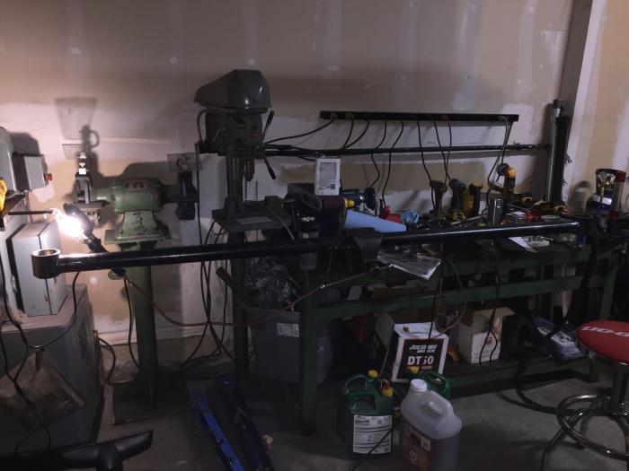

Just wanted to show the finished product finally installed. It was to hold up my end of the bargain where I got to claim the other side of the garage as a workshop if I could provide a way for my wife to park the truck under the hoist in the winter. Needed to get the racecar higher up and the rear arms out of the way.
