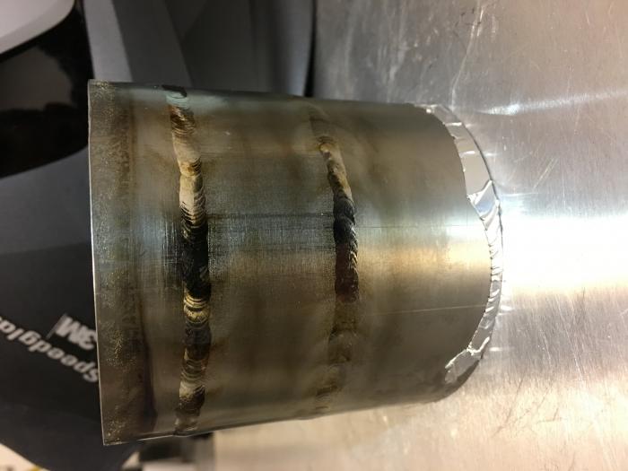

Getting my titanium dialled in. Still lots of "dialling" to do. I know I need more practice with the start stops. Suggestions?
- IMG_1337.JPG (33.98 KiB) Viewed 2992 times
- IMG_1338.JPG (30.3 KiB) Viewed 2992 times
Location:Orlando FL
Looks like you got a good ID purge, welding a short piece like that is a constant start and stop to reposition so it's a challenge (as you know).Skylineauto wrote:Getting my titanium dialled in. Still lots of "dialling" to do. I know I need more practice with the start stops. Suggestions?
- Skylineauto
Was able to get the tie ins a bit better. A bit straighter too
- IMG_1346.JPG (36.85 KiB) Viewed 2930 times
- IMG_1345.JPG (40.13 KiB) Viewed 2930 times

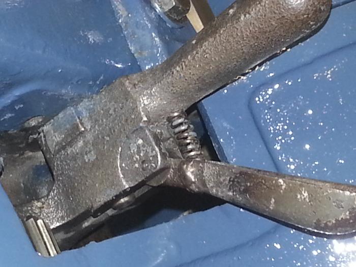

Well done on the cast/silbr exnail. Sure beats trying to find a part.

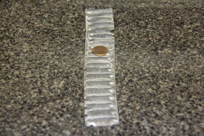

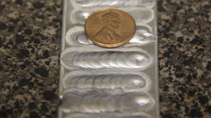

Practicing on aluminum. This is also weak (left) handed welding. The aluminum is 1-1/2" wide x 1/8" thick. 200 amps with pedal control. AC frequency set to 200 Hz. AC Balance at 35%. 3/32" 2% Lanthanated Tungsten and 3/32" 4043 filler.
close up shot.
far away shot.
Dave
close up shot.

Dave, that's the only way to get better with the opposite hand, practice and more practice. I intentionally use my left hand a fair bit, now I switch when ever I need to and don't even think about it. It's never as perfect as my RH but it looks pretty damn good. Nice job.

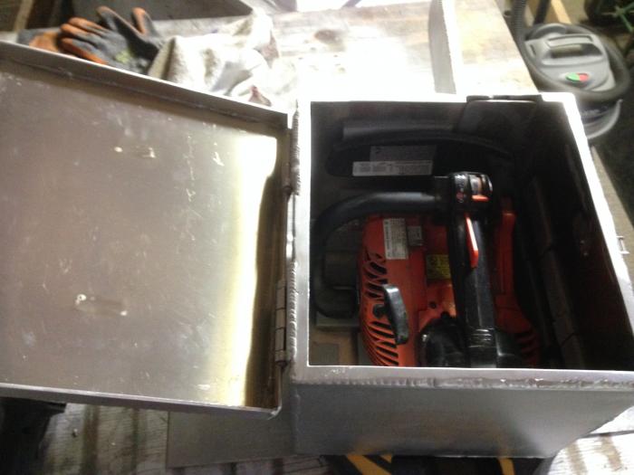

had some extra aluminum lying around, needed practice on aluminum outside corners and wanted a couple heavy duty chainsaw boxes for 2 chainsaws I carry on my ATV so .... These are 1/8" 5052 aluminum, I scored the joints with my circular saw, bent them manually over a table edge, and then welded them with my Everlast 255EXT. Specs for welding were ~110a on outside corners (~125a to 130a at beginning then lowered as metal got warm), no pulse, 3/32" tungsten and 5356 filler, 3 sec upslope and 3 sec down using an on/off torch switch and slope to control heat. Handles were made with some tubing and a couple pieces of plate. Aluminum hinges were purchased and welded on. Fun project, lots of TIG seat time, 255EXT performed great.
- Two boxes
- IMG_5163[1].JPG (40.08 KiB) Viewed 2993 times
- Hinge side
- IMG_5158[1].JPG (39.07 KiB) Viewed 2993 times
- latch side
- IMG_5159[1].JPG (49.3 KiB) Viewed 2993 times
- Inside box w/chainsaw
- IMG_5165[1].JPG (45.3 KiB) Viewed 2993 times

LOVE the chainsaw boxes, well done.
They also make me giggle. It's a bit like wrapping a giraffe in brown paper, isn't it? "So....what's in the box?"

Holy Cow! You must really love your chainsaws!
Actually I get it, I have a couple nice saws that I take really good care of and make sure they are always cased when not in use. Great job...very unusual job ..but great nonetheless.

Whoa,
Those chainsaw boxes are freaky cool!

Thanks for the comments on the chainsaw boxes, enjoyed them. Kym, the Giraffe comment had me rolling.
I needed some serious practice on outside corners to build some gas tanks later this year and this seemed more fun than making modern art for the recycle. As well, don't want the chainsaw I take hunting getting beat up on the trip. Bar oil reservoir is filled with vegetable oil and the saw has double duty cutting up campfire wood and cleaning moose. Would not want a broken chainsaw and have to go back to using a hand saw for either task, getting too old for that.

That is nice work. I have seen videos of welding cast and it seems very challenging. I think I would have contracted that one out at my skill level.exnailpounder wrote:20161203_164000.jpgRather proud of this. Bought a new to me lathe and the feed direction lever got broke so I Sil-brazed it back together and had to re-drill the hole for the return spring. Paper thin cast iron and mildly expensive to replace so I was puckered but I pulled it off. Silbr is harder to drill than cast.

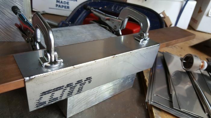

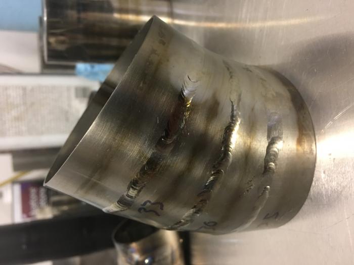

Started practice on welding SS today. Cut about 30 strips to weld back together.
Between 0.55mm and 0.7mm
First ones looked pretty crap. But fiddled with the settings and got something good enough for the moment.
I'm planning on fabricating a 0.55mm inconel exhaust for my bike early next year. Far cheaper to practice on SS though.
As it turns out inconel welds better than SS ... well for me anyway.
