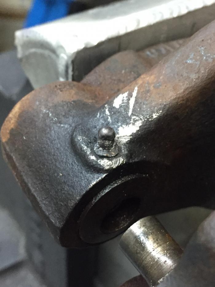

removing a broken set screw by tig welding a tit on it
to grab with vice grips when its to small to weld
a nut to it.
a nut to it.

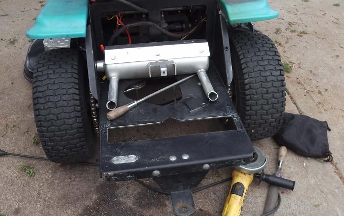

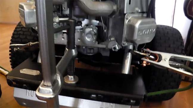

I’m still new to this forum, but wanted to make a contribution to the Recent Welding thread here as soon as possible, as I think that’s where the most significant stuff occurs on forums like this. I don’t do lots of welding like I once did, and I have a minimum of tools and equipment to use now, which I like, but I still have a lot of enthusiasm for new fabrication and modification of existing stuff.
Anyway, here’s a fun one that I’m doing by re-powering a zero-turn mower, from a 12hp Single to a 20hp Twin, since I put a bigger deck on it at the beginning of the mowing season and added a higher compression cylinder head to make it work OK with the 12hp motor. And it did, but now it burns oil and seems to be loosing a bit of torque too. So, it’s going bye-bye.
Surprisingly, I got the 20hp Twin for the price of a 18hp Single. But I didn’t like how the two-into-one exhaust protrudes out the back end and how it gets in the way of the throttling mechanism.
So, I decided to duck it down under the motor mount. And it’s going well, even though I didn’t recognize that the exhaust had an aluminized coating, as I only ground off what I though was some high temp silver paint.
But, no matter. The fit up was good. The new geometry was all good. The welding was nothing to be proud of or ashamed of. Besides, paint covers a multitude of welding sin.
I’ll probably delete that heat shroud so that the trailer hitch can shoehorn back where it was. And I’ll undoubtedly be doing more to it this winter, like fabrication an aluminum diamond plate gas tank and moving it up front under the footing area, while using an electric fuel pump. The existing gas tank had a bulletin or recall one it years ago, not that I'm worried about it. I just dig a brushed metal finish on aluminum diamond plate, and maybe the weight center being lowered and brought forward would be a good thing too.
