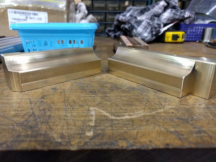

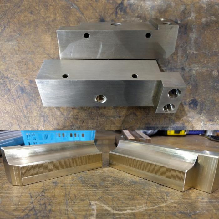

Just looking for some feedback, I have a job that requires me to weld ( cap off ) little plugs in aluminum bronze, these are holes for water to travel through and cool the block. I am using a syncrowave 351 , dcen, pure argon for gas, using gas lense #8 cup and 1/8 tungsten electrode, the filler rod is sodel 661 aluminum bronze. I have tried welding this block ( 2x1.5x6.5 long )
and can't get a nice bead , using 250 amps and using pulse ( rule of 33, although the pulsing only goes to 10 pps, for that I am using 7 ) . The problem I am having is the filler rod is balling up , almost running away from the torch , I am also using the lay wire technique. Any constructive suggestions are very welcome.
Thanks in advance !
Cheers !
kiwi2wheels
- kiwi2wheels

You have to Preheat the aluminum bronze before welding
when your dipping you need to have the torch pointed away from the filler rod or the rod will melt before you dip
think of how you weld aluminum but with a lot more heat
you might want to even try Helium instead of argon
my personal opinion is unless your doing a sharp corner you need to shut off the pulsing

Thanks for the advice , not to contradict kiwi , do you weld on AC ? I found AC on my machine is almost inconsistent, loosing ground or something, so DC is my preference if possible . As for preheating , tried it that way, my data sheet says to preheat between 200-500 , but we have no oven, tried to use oxy/ acetylene, and it cool really fast , so fast that I can get a torch on in fast enough to stay in the range required.

A photo or 2 would be real helpful.
Thanks for all suggestions, I ended up figuring out what was going wrong, the perfect storm it seems ,
1: Turns out plug material was made of Brass
2: My tungsten for AC ( pure tungsten ) was not large enough for
the amps I wanted to weld with . ( 205 amps , 3/32 tungsten)
3: Brass contaminated bronze so holes kept forming.
Long story short , ended up using 205 amps , DCEN , no pulsing,
and was able to fill the holes .
Took some time but got it in the end , not the prettiest weld but it will work.
It was a one off.
It was a one off.

Looks awesome
One way to Keep heat in it is to Elevate it off the welding table and clamp your ground right to the block
