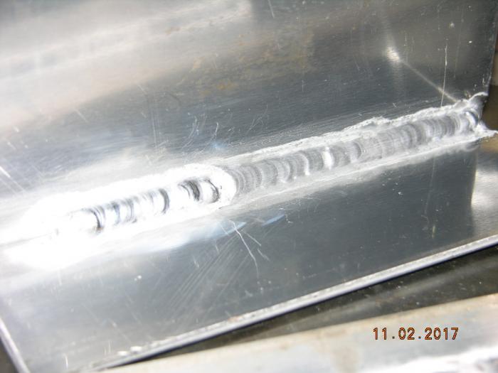

I got my first welder a everlast powerpro 164. I have gone straight to tig/aluminum to start with. Starting to get the hang of it I can feed and do ok beads now.
I'm using 100% argon at about 18 SCFH ?
CK 17 flex torch with WeldingTipsAndTricks gas lens kit #7
120HZ
amps maxed out and using the foot pedal.
30% ish on cleaning.
I don't have 220 yet in my shop so I'm running on 110 and can get a max of about 133 amps..and not the full 164 my welder will go to.
I'm trying to weld some 1 3/4" x 1/8" wall aluminum square tube together. I cannot seem to form a puddle on inside corner joints like if I make a T out of it. Do I need to run on 220 to get more amps? I welded some way thicker steel together no problem.
Here is a picture, the long shiney beads that are not all crazy are my latest practice ones.
Tried to weld the corner, sat there forever wouldn't form puddle added filler anyway and made this mess.
Thanks!

More amps will definitely help with inside corners, but it can be done with the amps you have. You're going to have to get that tungsten in super tight to get both sides of a tee joint to puddle all the way to the corner, and draw the tungsten back as you add filler. When advancing, you're going to have to repeat this, getting the tungsten as close as you can without touching, to keep the arc from wandering to the sides (and the puddle from following). With the lower amps, preheating the metal will help. You don't need a torch; I prefer a heat gun. No danger of sooting up what you're about to weld. This will help immensely with getting the puddle established quickly and being able to advance consistently with the amps available.
In a pinch, a good hair dryer can get your metal to 200F if you're patient. With a heat gun, you can make 300-325F faster and get better results.

In addition to the other advice, what size fill rod and tungsten are you using? You can also reduce your cup size to help focus the heat a bit more.
When I work on inside corners, I establish my arc on one side, then go to full amperage, then rotate my cup to get the heat onto both sides. But arc length is critical for obtaining and maintaining the best control.

I tried heating it with my kobalt heater..no good, heat way fatser if i just try to hold a weld forever that wont puddlel.
Also tried tungsen as close as possible.
Also tried to melt the high side then move down to the corner.. noipe.
Here is how close my tungsten was....
I think I need more amps?

Turning my Freq down to like 50 from 120 to get a wider cone and just camping and camping and swirling around..i finally got a puddle that consumed that inside corner. It was all contaminated from previous nonsense and hideous but I didn't care. I think I can do it for real next time.. need to see if I have any more of those scraps to do a real test again.

I looked back and noticed you are running a #4 cup? Thats too small and its hurting you quite a bit. With the cup that small, your heat zone is too narrow on inside corners, so essentially you aren't getting any heat into the sides unless you rotate your cup heavily. Bump up to a #7 or #8 with a gas lens. Put your frequency back up above 60 if you can (I know you dropped it due to power considerations) and have a go. Tight arc, light up away from the end, establishing the arc on the bottom side, full pedal, then rotate up and weld away!

I also am KTM bleed orange guy. Here is my first attempt at aluminum inside fillet. I ran at 135 amps peddle controlled, and 3/32 4043 filler. I use a #8 gas lens at 18 cfh maybe the reason your having issues, not a good gas coverage. All wiped off with Acetone including the filler then ss brushed. Had a good clean puddle no oxides which I do see in the porosity of the picture you posted.
Fillet T joint on 3/16 T 6 Aluminum
Aluminum T joint 1.JPG (36.2 KiB) Viewed 2878 times

I would turn the frequency up. You have plenty of amps for the thickness. Turning up the frequency will focus the arc and let you put the heat where you need it. Establish your puddle on the bottom piece, then wick over to the vertical of the T. Then just keep you arc centered on the joint. I like to keep my frequency at 140 or more for t joints. Hope this helps!
